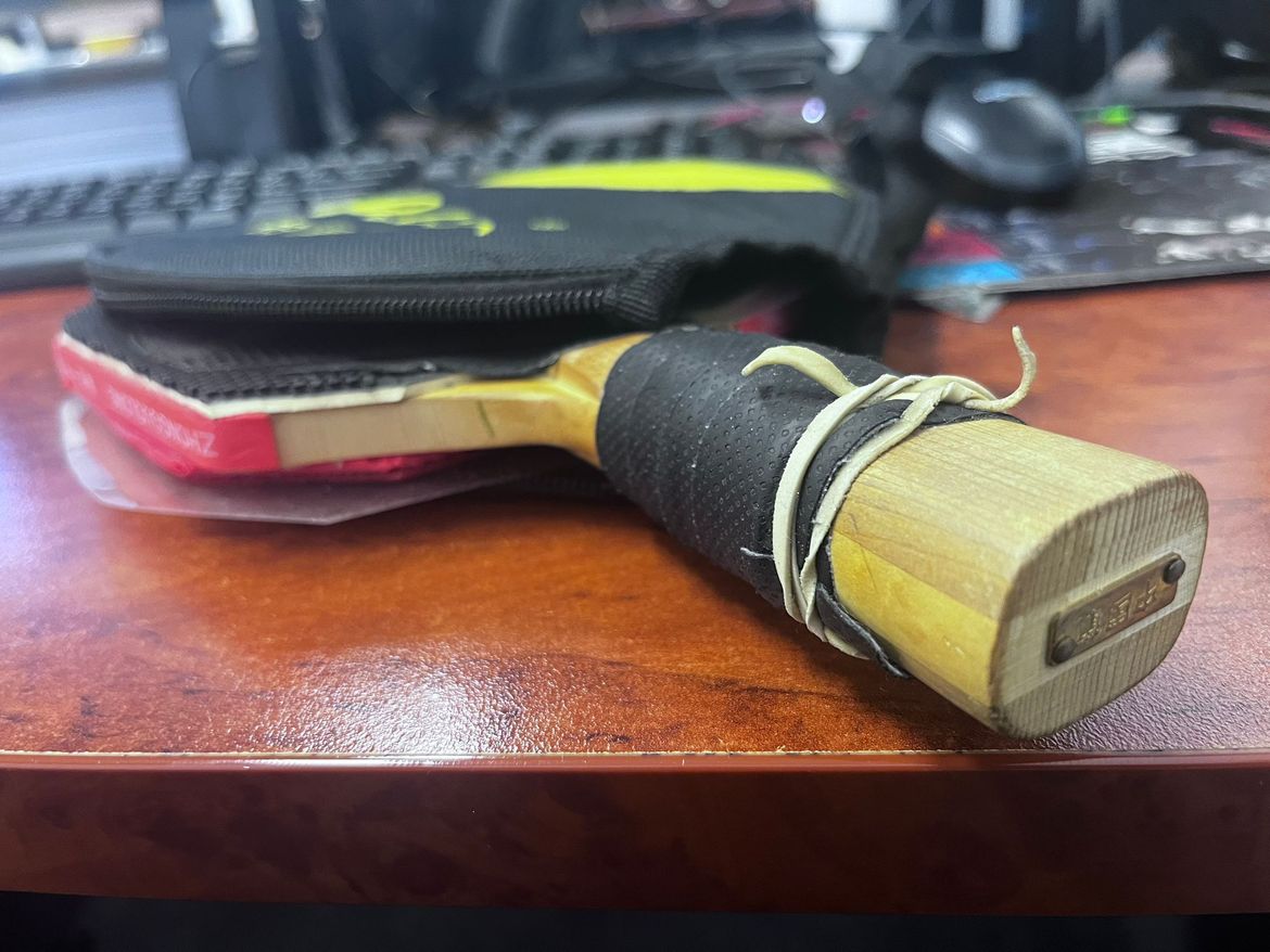

Good Morning @glim
Now this is an unusual question! 🙂 I do like different questions. I dont know of any lazer that will cut to that depth (or even half that depth) Someone with a band saw or probarly better a hobby type band saw as it will have less play for the fine tollerance of cutting you are asking. If the blade is 10mm then cutting it will use 1/2 a mm and keeping it true while cutting is my concern.
A water cutter could potentially do it, but most people dont have access to one. You could hit up your local engineering places and they may have one and be kind enough to try something new?
The final port of call would be to look up your local mens shed and have a chat with them. There may be a few people that would have a go.
Id also like to offer a warm howdy and welcome you to tthe Bunnings community page 🙂 There are lots of questions liks yours if you take a wander through the pages it may give you a few outside the box suggestions :).

Hi @glim
Sorry unless you have 2 extra rubber pads to glue on to new bats cut in half it wont work and the cut handle will no longer have a blanced symetrical grip. unless you fashion two new timber grip halves as well. Any saw cut down the middle of the blade will take out 1mm to 3mm so the bat halves will be only 4mm thick at best.
Easiest way is to buy two new lighter paddles you like, I like the paddles smooth but grippy one side and textured on the other.

Good morning,
This is a very different request, I also like them as they di make me think.
The laser would not work for this, at the moment I am thinking belt sander,
on both sides as this would be 2.5mm on both sides to get to the 5mm.Or you could try and make your on bat from scratch, event if you use the handle from the other bat.

Hi Glim.
I actually manufacture and repair table tennis blades professionally.
I must ask -- why on earth do you want to split your racquet down the middle like that? It seems like an awful waste of what may be a perfectly good TT blade
I very much doubt either blade will still be useable, even if you could manage it. Most thick blades like yours are made from woods like cypress or Japanese Hinoki. In which case, the two halves would be far too weak to function as a proper table tennis blade at 5mm thick, even if you were theoretically successful in perfectly splitting them down the middle with a laser or bandsaw (...neither of which would actually work BTW. Neither a galvo laser nor gantry style laser has the ability to accurately cut at that depth and "'butterfly" a blade like it were a chicken breast. Any laser strong enough to cut wood to a depth of 75-150mm would simply incinerate the the blade's core, and you would end up with nothing but charcoal. Similarly, a band saw --- even if it didn't drift during cutting) -- would remove 2-3mm worth of sawdust as kerf, and each half would end up being both 4mm thick with one rough-cut face. Further sanding would then remove another 1 mm, leaving you with two halves that were about 3mm thick at best... Which is simply far too thin to use as an actual blade).
Your particular blade also looks like it was hand made (going by the label on the bottom), and may potentially be a collectors item. In which case, it may be simpler to just sell the blade second hand, and then buy two replacements.
Please feel free to reach out and ask me any questions, happy to assist if I can.
Cheers.
S.Woodbury
Perth WA.

Thanks for the very kind words, glad I could help. 🙂
Just as a BTW, the style of blade in question with the OP is called a one-ply blade, and is actually quite rare here in Australia, as it's made from a single piece of wood .
Most blades are actually made of either 5 or 7 layers of low density wood veneer comprised of anywhere from two to four different species of wood. (Often composite materials like carbon fiber or kevlar are also added, especially with attacking top-spin competition blades.)
That blade however was a custom-made one ply, quite possibly made by hand in Japan or China out of Hinoki (an extremely rare and expensive species of cypress native to Japan).
Hinoki wood has some amazing playing characteristics which makes for an amazing blade with incredible playing feel...but you don't see such blades used widely anymore, as the wood is so expensive (if for example that blade is made of Hinoki from the Kiso prefecture, then there's about 300 euros worth of the stuff contained just in that single solid core of that blade! With that in mind, cutting it down the middle would be an absolute disaster in terms of destroying such rare and valuable wood).
