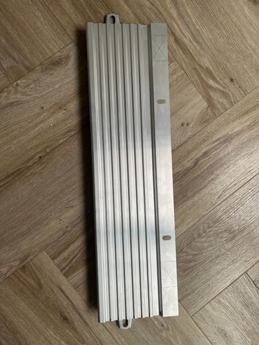

Good morning Judith @Judithvdv

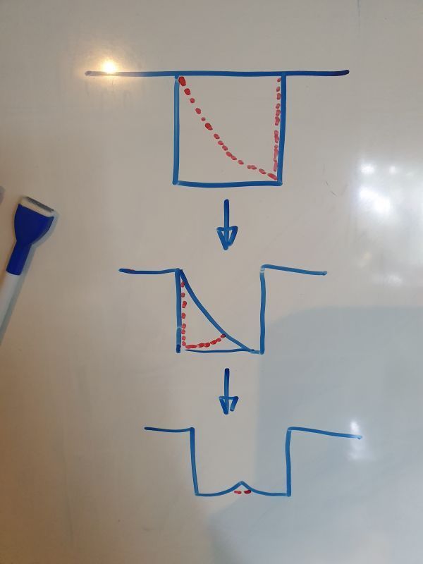

My first thought would be a jigsaw with a metal cutting blade - and remove the metal piecemeal.
Starting with curved cuts and then the sides. A file should clean up the rest.

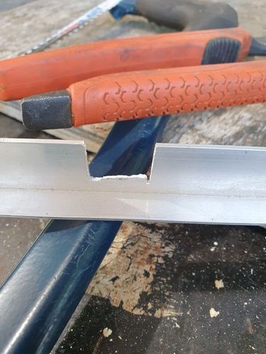

Or - if it's not critical - a hacksaw down the two sides and with a pair of pliers gently bend the remaining metal - up and down slowly till it fractures. Clean up with a file.
I hope this makes sense with the jigsaw cuts...

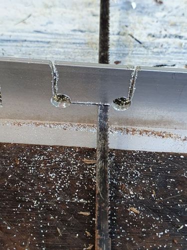

Good afternoon @Judithvdv
I Like @Noyade's idea, I have one that is similar but may be easier.

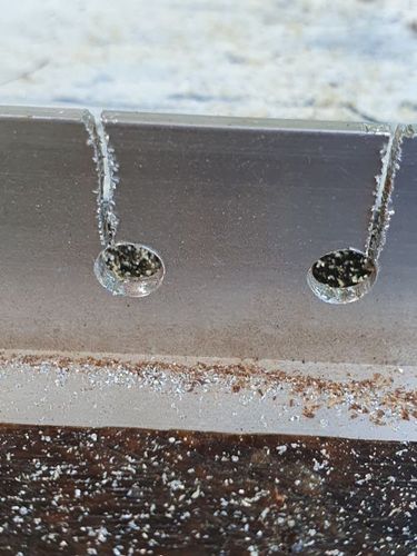

Drill two holes at either inner point of the square.
Then using a coping saw cut from the holes outwards. Its aluminium so should cut fairly easy.

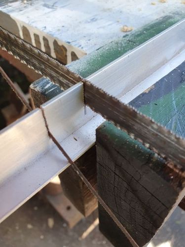

I've never used a coping saw on aluminium - so I tried it outside and it works remarkably well.
Less material removed compared to a hacksaw...
The 'fatigue' method I suggested does leave an edge that needs to be filed...
Holes and coping saw...
And you can easily rotate the coping saw for the final cut...
This of course is very thin aluminium - but I'm impressed mate. 👍
