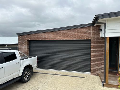

Am I able to use exterior grout instead of render to cover these bricks?
Hi @Bomber25
Render typically has up to 10mm thickness and a grout not really designed for that thickess as it is rarly more than 3mm thick and grout sits supported between tiles typicaly not as a hard surface coating.
Render products are much more flexable and hard wearing and cost less than Grouting agents
Render has that surface workability in bigger areas with steel floats.
So in short Best to use render not grout,
Hi @Bomber25,
@Jewelleryrescue is on the money there, and Render is the product for the job. Can I ask why you were thinking of using grout?
