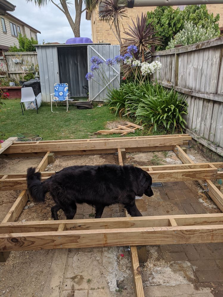

My dog Oreo was my building inspector. He enjoys the outdoor area.

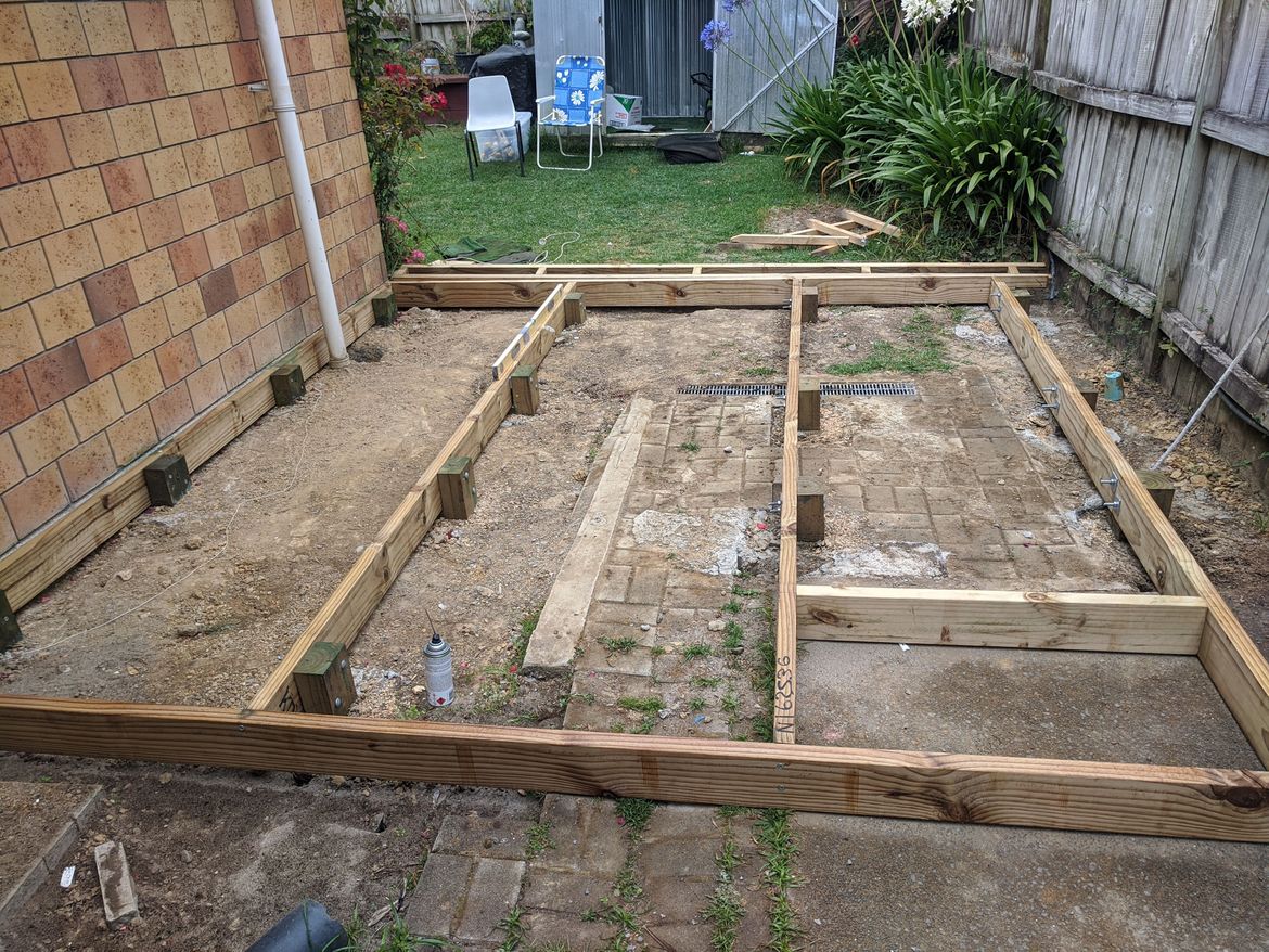

Step 2

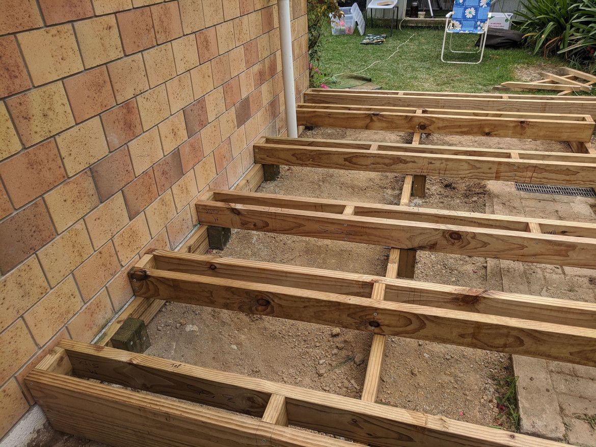

Dig 16 holes 600mm deep. This was the most difficult part. Even with my hole borer it took three days to dig. I used 120 x 120mm house piles for the poles. As per the NZ Building Code, I cut an "L" shape at the top of the pole to accommodate the 140 x 45mm deck beam.
Step 3
Cement the poles in place.

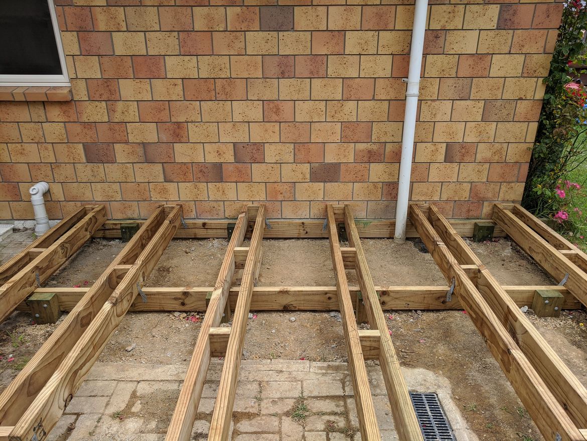

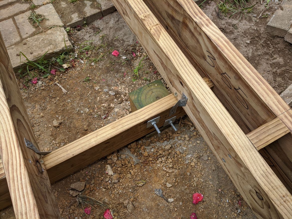

Step 4
Install the decking beams. I used the 140 x 45mm timber to makes the bearers. Used two 140 x 45mm on either side and a 100mm block in the middle. Then I screwed both with a 12 gauge coach bolt. This took a long time. Fortified beams for spa requirements.
As per the NZ Building Code, I did not attach this deck to the house but buried the poles along the house - the spa deck is load bearing and if you attach to the wall and things go wrong, insurance will not cover you.
My building Inspector.

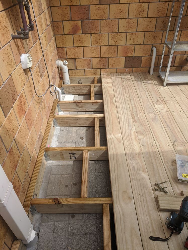

Step 5
Install decking timber and fasten down with coach bolts.

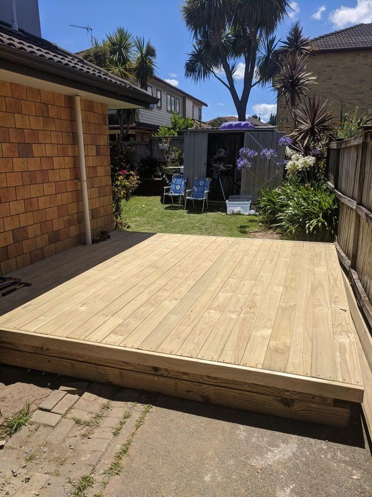

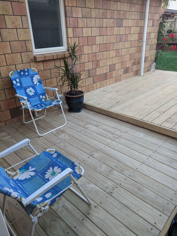

The spa deck before staining.
Relaxation deck before staining.
Relaxation deck next to spa. I made the frame in the background.

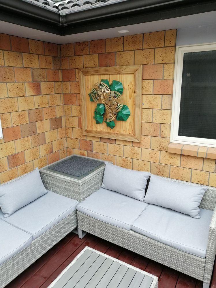

I installed LED downlights under the house eaves, which light up the whole spa and entertainment area.
