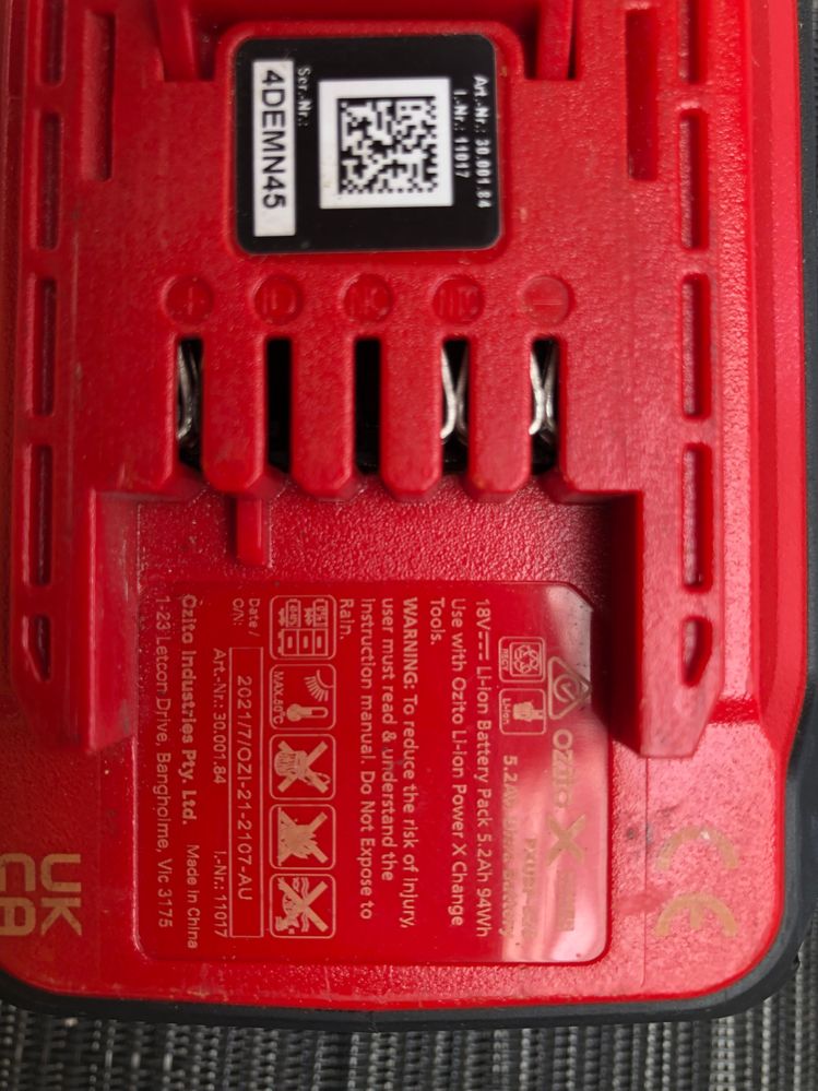

Hi all, has anyone had any issues with the Ozito Ultra 5.2 Ah batteries? I have three batteries (about two or three years old) over the space of two months that will not charge. The first of the three lights on the battery will only flash and battery will not charge. It seems to begin with the battery only charging to the second light and then in a short period will not charge.
Thanks Kevin.
Welcome to the Bunnings Workshop community @Kev1-Towns. It's great to have you join us, and many thanks for your question about Ozito batteries.I don't personally use the Ozito system, so I don't have any first-hand experience, though haven't fielded any enquiries with similar issues. However, I trust any of our members using the Ozito system will chime in if they've had the same problem.
You'll be pleased to know that there is a three-year warranty on the Ozito PXC range batteries. So, if you take them and your receipts into your local Bunnings store they'll be able to access them for warranty and swap them over.Please let me know if you have any questions.Mitchell
Hello @Kev1-Towns From what you have described it would appear the batteries are either reaching the end of their service life OR they have experienced charging issues which have had a compound effect over time.Smart chargers are great but it has been my experience that they are designed to not accept battery packs whose voltage has dropped below their designed "minimal acceptable" overall resting voltage, the battery management systems (BMS) integrated into the packs help to prevent over charging / discharging but a battery should NEVER be left in a low state of charge because whilst the discharge is lower for this type of chemistry (Lithium) is still occurs and once you reach that cut off voltage the Smart Charger will no longer work on that pack.
If still in the Warranty period, I would go that route 👍

"But I always thought Lithium doesn't deplete itself to death (from overuse)?" - NoyadeActually @Noyade lithium cells do have a limited number of cycles in their lifetime (300 - 500), as they age the capacity also reduces thus older well used batteries have a lower overall capacity and will reach an unserviceable voltage sooner than newer battery packs if left in a low state of charge, temperature also has an impact on battery cycle/health (further details in link below) 👍

Hi DIYGnome, Great information on the batteries and charging systems. I use the batteries with the Ozito mower once a week, and I would have left the batteries charging until the next day. I will just have to remember to remove the batteries from the charger in future.
