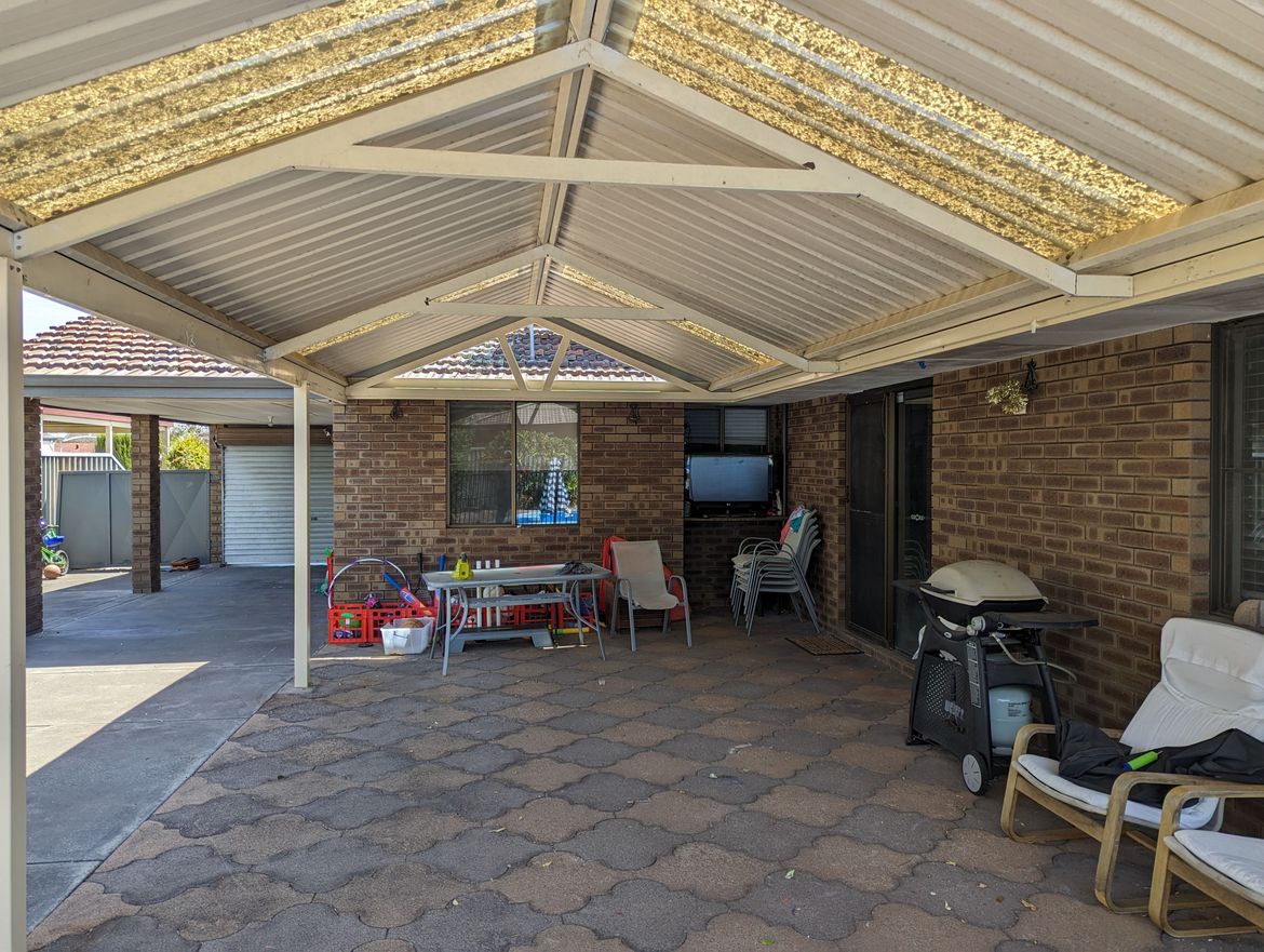

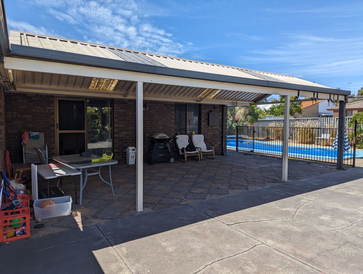

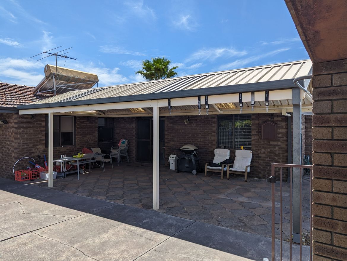

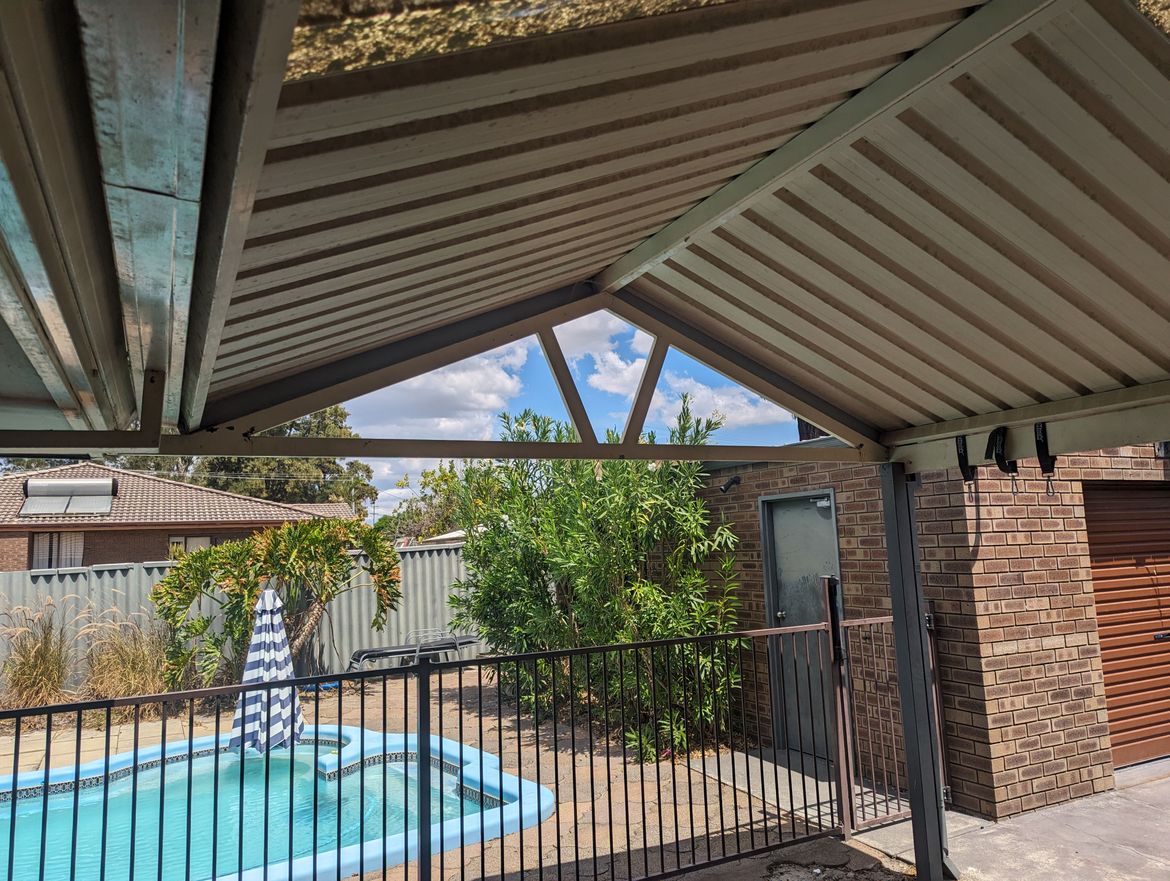

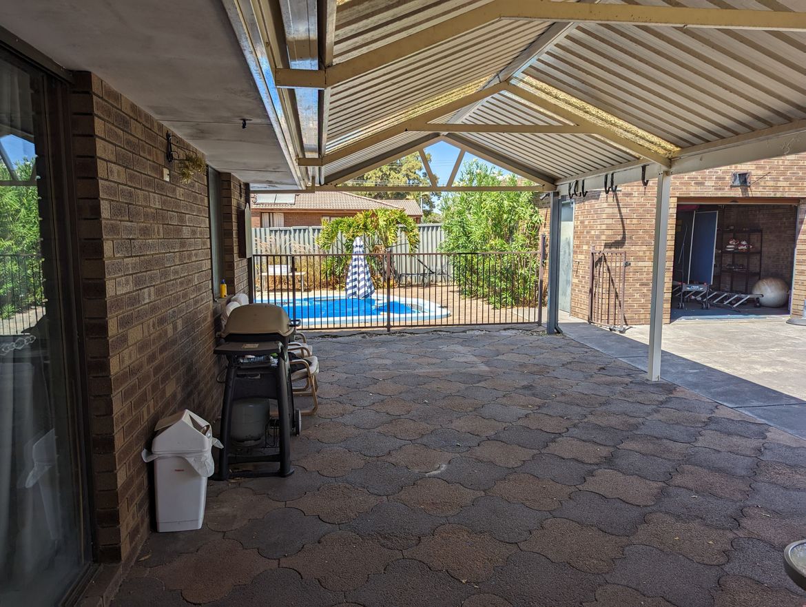

I have an existing gable patio structure which we would like to modernise by insulating the structure and infilling the ends. We would also like to add 2 fans and some heaters to the top so we can utilise the space all year round and enjoy the weather in Western Australia. The dimensions are approximately 3930mm by 8780mm.Where would I start tackling such a project?
