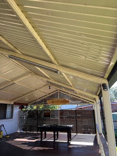

i have an issue with my decking area, the metal ceiling drips with condensation on winter mornings.
It is a single metal sheeted roof panels with battons.
How can i resolve this issue permanently and be able to put nice things out.
what insulation would you recommend and also ways to install this?
thank you

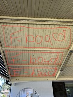

Option 3: Between the underside beams ill measure and cut foil board product ill use- Foilboard 10mm x 2400mm x 1200mm Standard 10 Insulation. Which ill attach the Purlin Brackets for adding the cladding later. I wouldn’t have to take the sheeting off for this right? I have attached a picture of my design thought.
My preferred choice would be option 3 if i don’t have to remove metal sheeting.

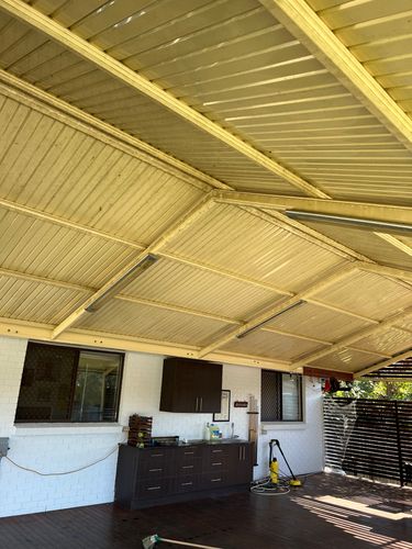

Also, i have noticed the condensation only drips from the beams, causing drip lines under the beams onto the floor in the morning. Don’t know if this is just the sheeting trickling down onto beams and then dripping off the beams onto the floor.

My preference would also be option three, @bowmatty. You won't need to take the sheeting off for this, but you might need to screw through the sheeting in places to fix the additional purlins/batons in place.
Textured paint might work, as it shouldn't allow the moisture to run and bead into larger droplets before falling off. I was going to mention sarking, but I'm not entirely convinced that it wouldn't also suffer the same effect as the sheeting.
I suspect the water is running down the sheets, hitting the purlins/beams and dripping off them. As it's running down the sheets, it picks up additional water particles on the surface and forms larger droplets. That's why you're getting such distinctive drip lines under the beams. If you get out there early morning with a torch, you'd likely be able to check if there are run lines down the sheets to the beams.

It's certainly going to add a buffer and prevent the moisture-laden air from coming in contact with the cold sheeting @bowmatty.  Plaster sheeting over the foil board will add an additional layer of protection. The main issue here is the metal roof sheeting temperature versus the surrounding air. When the air hits the dew point, moisture droplets occur on the surfaces that it comes in contact with. Cold steel sheeting is typically more susceptible to this than other mediums.

I'm going to go with the Foilboard setup.
My plan is to fit them into the gaps between Purlins (space is 2400mm x 1005mm) and cut them to size.
I will secure them to the purlins with the Flexifast clips.
I will then tape up the exposed edges which should be hidden behind the purlins.
How much space should i leave behind the Foilboard and the metal sheeting?
What shall i do with the exposed roof purlins, as these will still be
metal?

The condensation is formed by moisture-laden air coming in contact with the roof sheeting @bowmatty. If you exclude the air from reaching the sheeting, it can not deposit moisture onto it. By adding the foam board and taping to seal, no air can access the underside of the sheeting. Due to this, I don't believe having a gap between the foam boards and roof sheeting will matter, though the manufacturer encourages you to do so to improve the insulating values of the product. The air gap stops heat/cold from transferring from the sheeting to the foil board and radiating it on the underside.
It appears you've listed everything you need. Perhaps a couple of tubes of polyurethane adhesive would be useful if you need to glue the board to the roof in difficult-to-fix locations.
