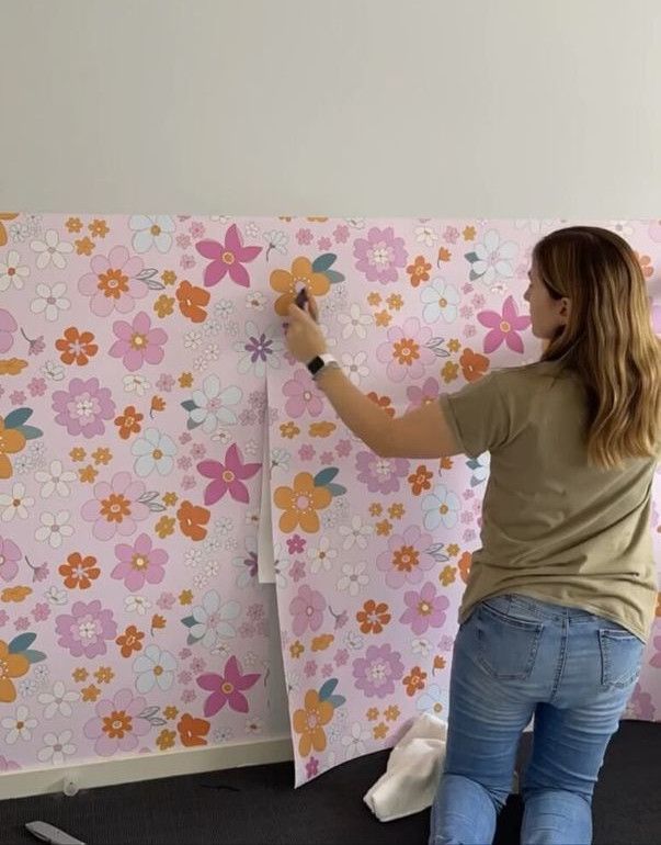

Once her walls were dry, I started to apply her half-wall wallpaper. I selected a design called "Flossy" by Minnie and Me Interiors. The wallpaper is a very simple peel-and-stick removable style which made installation super easy. Each piece comes numbered, so I started on the left hand side of the wall with piece number 1. I used the included wallpaper installing tool which helped to remove any air bubbles.
Step 3
After the first piece was installed, I continued to install the rest of the pieces until the wall was complete. After the wallpaper was installed, I used a Stanley knife to cut off any excess at the bottom to give a clean and finished look.

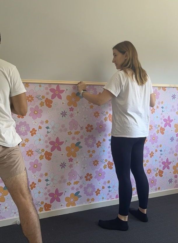

Now that the wallpaper was installed, I wanted to add something to the wall over the join between the wallpaper and the painted wall. I decided to go for timber moulding as I felt it would create a polished look and would be a fun, modern take on traditional wainscoting. I chose to use Porta 30 x 12mm moulding from Bunnings.
Step 5

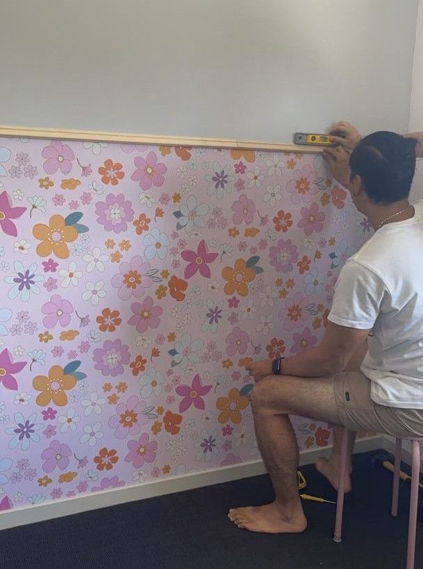

The timber moulding is quite lightweight, so it could have easily been installed with Liquid Nails or wood glue, however, we decided to go with tiny nails for the installation this time. Installation was really quite easy and only required lining up the moulding in the required spot, before hammering in the small nails to hold it in position. We used a spirit level to double check the moulding was straight prior to hammering.

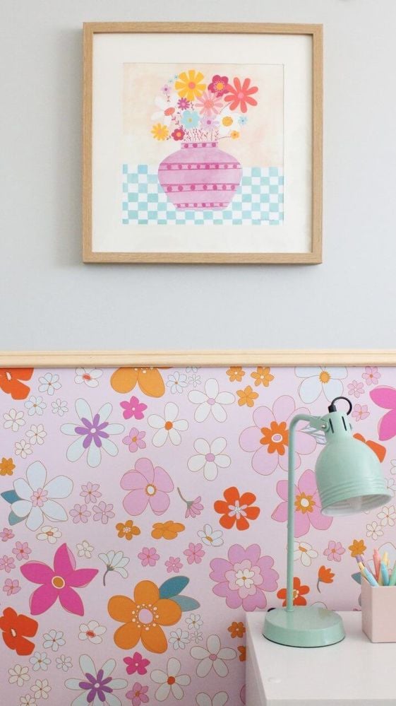

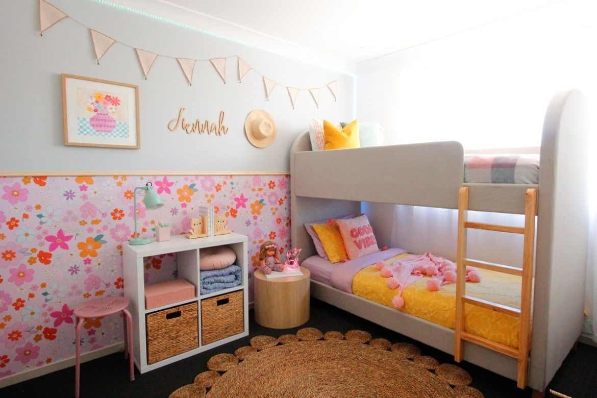

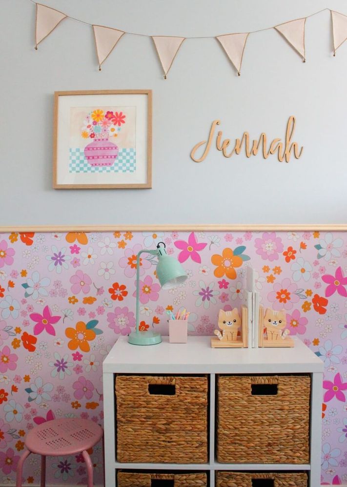

And that’s it. Once the last of the moulding was installed, her feature wall was complete. I added some fun artwork and decor pieces to her wall that suited the overall colour scheme and theme of the room to tie it all in beautifully together. The feature wall looks fantastic and was a quick and easy job completed over one weekend.
At this stage I have left the moulded timber as is but may give it a clear matte coat of varnish if I feel it needs it. I feel keeping the timber moulding raw really helped it tie in beautifully with the timber accents on the bed, as well as the other timber pieces I used around the room.
