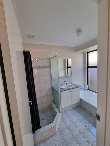

Attached image below of our bathroom, that needs refreshing:
The requirements would be:
- replace tiles
- remove shower lower "wall" and lower shower floor bed
- put wall brick between shower and vanity
I was hoping to lift the tiles, get rid of the lower "wall" and grind the screed (instead of fully removing it...?) of the shower floor to requirements (10mm lower than the height of the rest considering tiles installed). Then waterproof the whole room, then tiles (my wife did want floor to ceiling tiles).
I had googled quite a bit on some processes and how-to's on shower reno, but I guess I would like to ask if my idea will work?
I still need to work out how to properly put the brick wall after.
