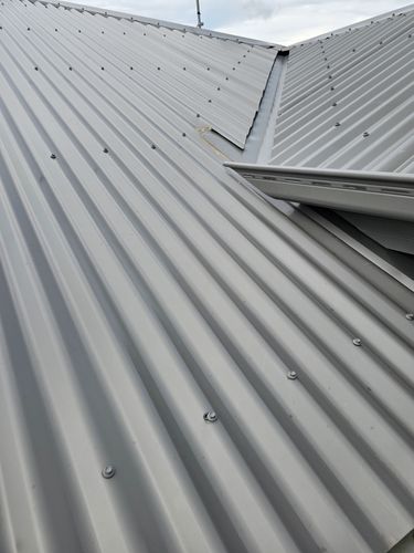

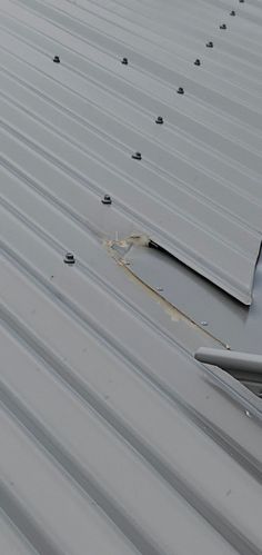

Hello 🙂 does this area of new build tin roof appear to look okay/ normal? Â
Hi @Bell_1986,

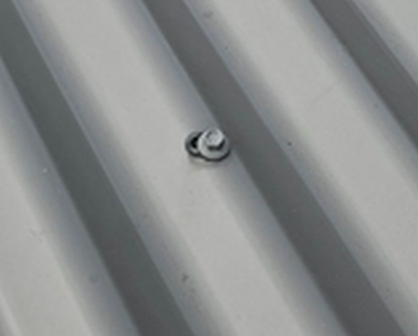

I'm not entirely sure why they've cut the sheeting and installed the flashing as such. If you are concerned, I'd suggest contacting a roofing specialist to assess the situation. Although I can't determine why the flashing has been installed like this, I do have concerns about the open hole next to the screw that's been moved down the bottom of your first image. That's likely something that needs to be fixed up.
Hi @Bell_1986Â
I'm not a roofer - but it looks very odd to me. They've even used silicone and pop rivets?
I think the screw Mitchell mentions has been tightened to the point where the rubber seal has been crushed and distorted - rather than an open hole.
Either way, agree with Mitchell - have it looked at.
Cheers!
Good eye, @Noyade. It could quite possibly be the rubber washer; it just looked perfectly round.
