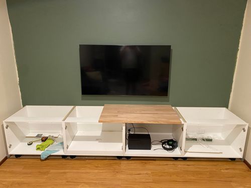

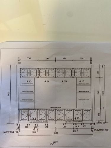

I’ve bought two Okoume timber panels (2200mm x 600mm x 25mm) that will be installed as benchtops on top of some melamine cabinets as part of a tv unit. I couldn’t get a single panel that would span the 3140mm length so I decided to join two together. My plan is to use one full length 2200mm panel in the middle and join two smaller pieces on either side (so it looks symmetrical and there isn’t a join in the middle of the benchtop). The first picture gives you the general idea although I only have one of the pieces of the bench top in view. The second photo shows the overall design. Note the vertical panels and fill join the bench top from above.
So, my issue is around appropriately joining the timber panels to form the benchtop. I was planning to use my biscuit jointer to install 6 or so biscuits between the panels and gluing them together. I know that biscuit jointing end grain to end grain is typically a poor choice as this is a weak joint. However, I’m wondering if it will be ok in this situation because; 1) the panels will be secured with screws to cabinets underneath thus providing additional strength, 2) there will be additional cabinets and panels joined to the benchtop from above (these should provide vertical support), and 3) the benchtop will span longways between two walls (if that helps for stability).
