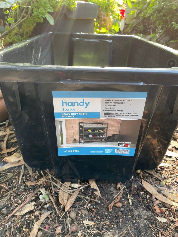

These tubs are solid.
I like to buy the packets for scoria, the sand and metal. Shops don't seem to like people shovelling scoria into tubs, with people then lifting the tubs into cars.
