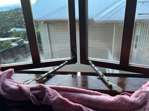

Your very first photo we can see drops of water beeding under the timber frame, and in the background we can see the eave I presume? I am wondering how the water gets under the eave and down to the top of the window in such a quantity?

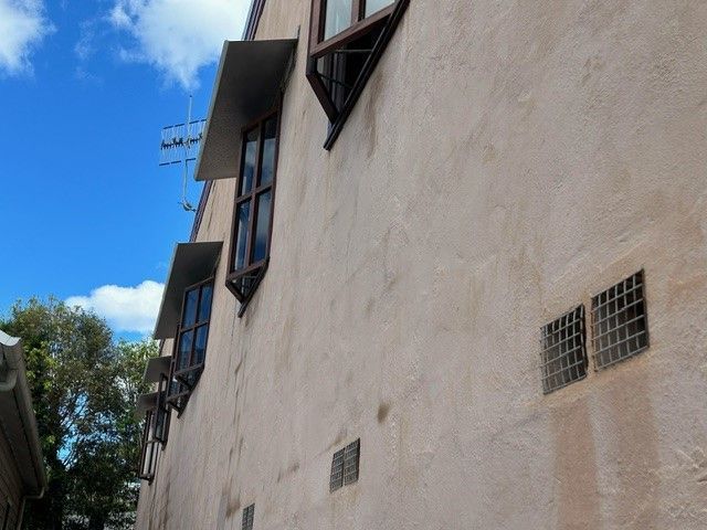

Photos of aluminium Awenings posted today.

The way the seals have been attached to the upper side of the windows would allow water to come through I think. But those roofs? they should actually be stopping pretty much any water falling onto the window itself.
Do you know if the installer put any sealant/rubber strip between the sheet of tin and the wall? It would explain why you have water entering at the top of the window if there is no sealant.
Looking at photo one,
the rain falls on the wall,
Runs down the wall and under the sheet of roofing,
then across the top of the window door iteslf.
and pools /seeps through the waterproofing
Into the house.
First step, find out if that sheet is sealed to the wall. (may negate other seals being needed)

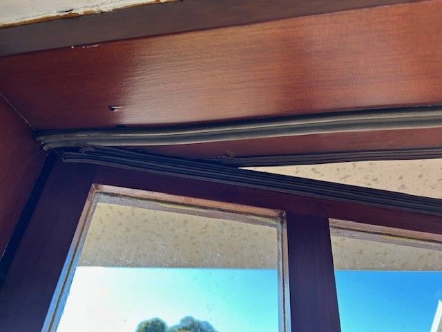

In the second photo, where you have installed the seal on the underside of the frame, you should remove this seal and replace it with a piece of 42 x 19mm 1.8m DAR Pine Premium using Paslode 40 x 1.6mm 100g Bright Steel Bullet Head Nails. This will allow a solid surface for the before mentioned Syneco 6 x 9mm x 5m Black Self-Adhesive Door Window Weather Seal to be attached to and compress against the window when closed.
Once installed, the timber can be stained to match, and the nails can be hidden using a nail punch and some Timbermate filler of a suitable colour to match the existing stain.
Unfortunately, you may find that water still gets on to the top of the window, but it should stop it getting inside while it is raining.

First stop is verifing that the awnings work, I really like them and how they are supposed to work but with the water you descibe I am thinking it runs under the awning piece and then into the window area.
If they are dry then maybe the other ideas 🙂 But it would solve your problem if they are letting water through.
Good point, thank you - I will check the awning-wall seals.

Also - I am wondering if this door seal on the top outside of the window where it shuts against the Frame might work?

That seal you've just put in might actually stop or at least lessen the amount of water travelling into the interior side of the window. I'm just worried that the mounting tape might not be enough to hold it in place. I propose adding extra mounting tape such as Scotch-Mount Extreme Double-Sided Mounting Tape 2.5cm x 1.5m.
