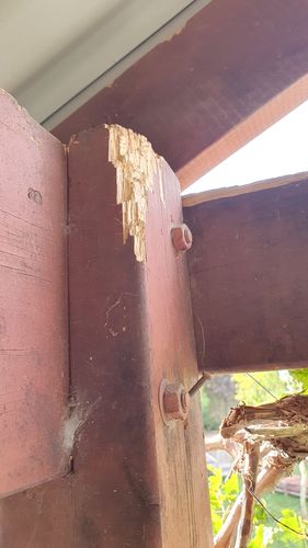

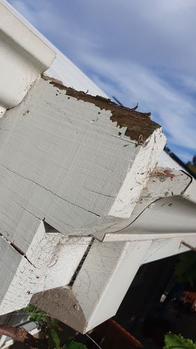

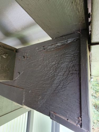

Hi, we have just moved in to an old house with chipped/exposed wood on the roof and under the pergola. How should we fix these so they don't deteriorate. Bonus points if you can suggest what caused it to be in this state?

It's only a guess but looking at how clean the chipped away area is, it almost looks like a previous resident has simply chipped away some loose material.
If all you want to do is prevent further deterioration, it can be as simple as removing any loose material, lightly sanding the area, priming and painting the exposed timber with an adequate external paint to seal it from the weather.
If you want to fill the area to hide the damage, you should use Turbo 500ml Builders Bog, following all manufacturer's instructions and safety advice. Once hardened, lightly sand using 120 Grit Sandpaper, prime using Dulux 1Step Prep Primer, Sealer & Undercoat 1L and paint using a suitable exterior paint that has been paint matched to the existing.
If you need any further assistance, please reach out.
