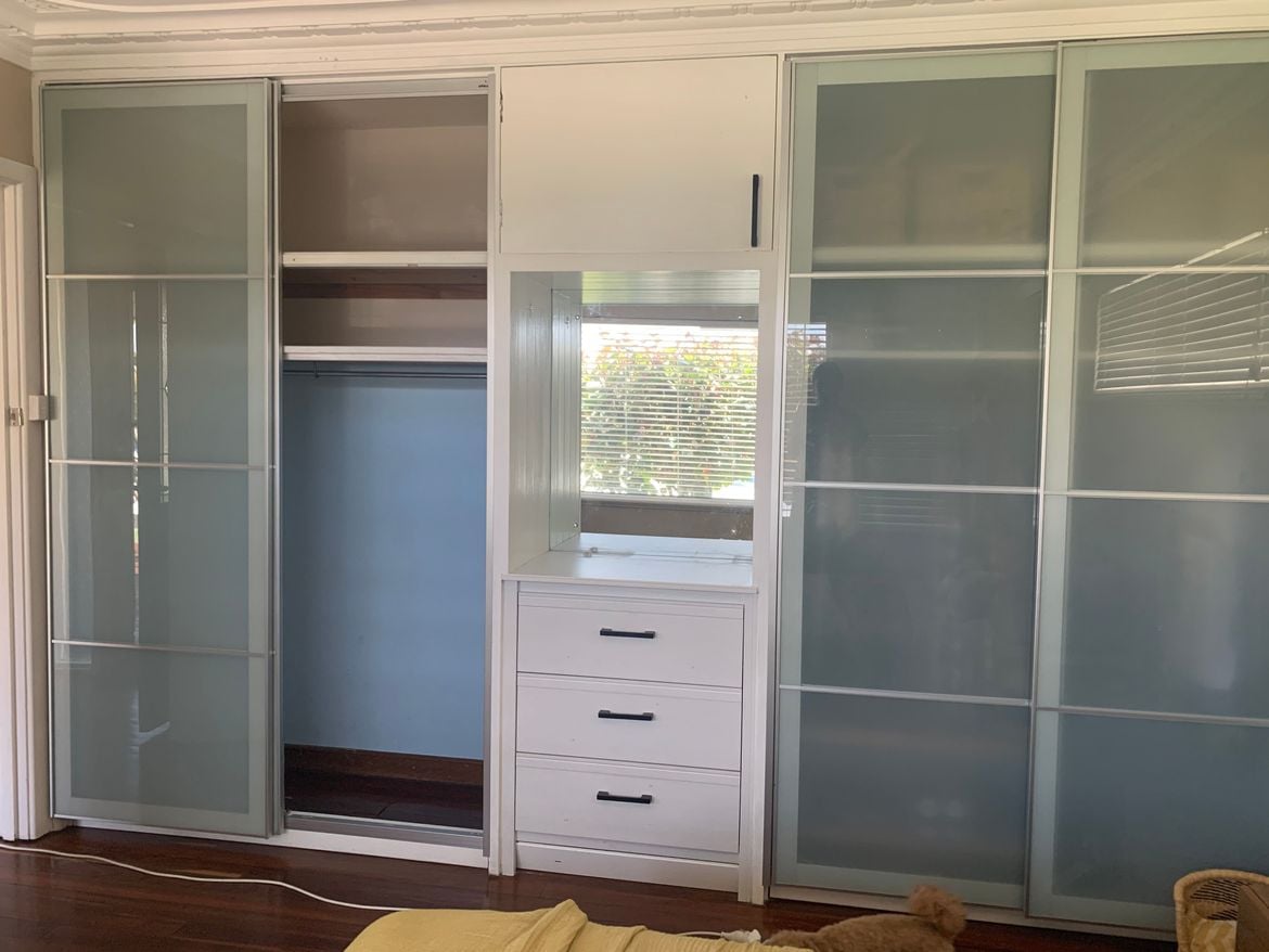

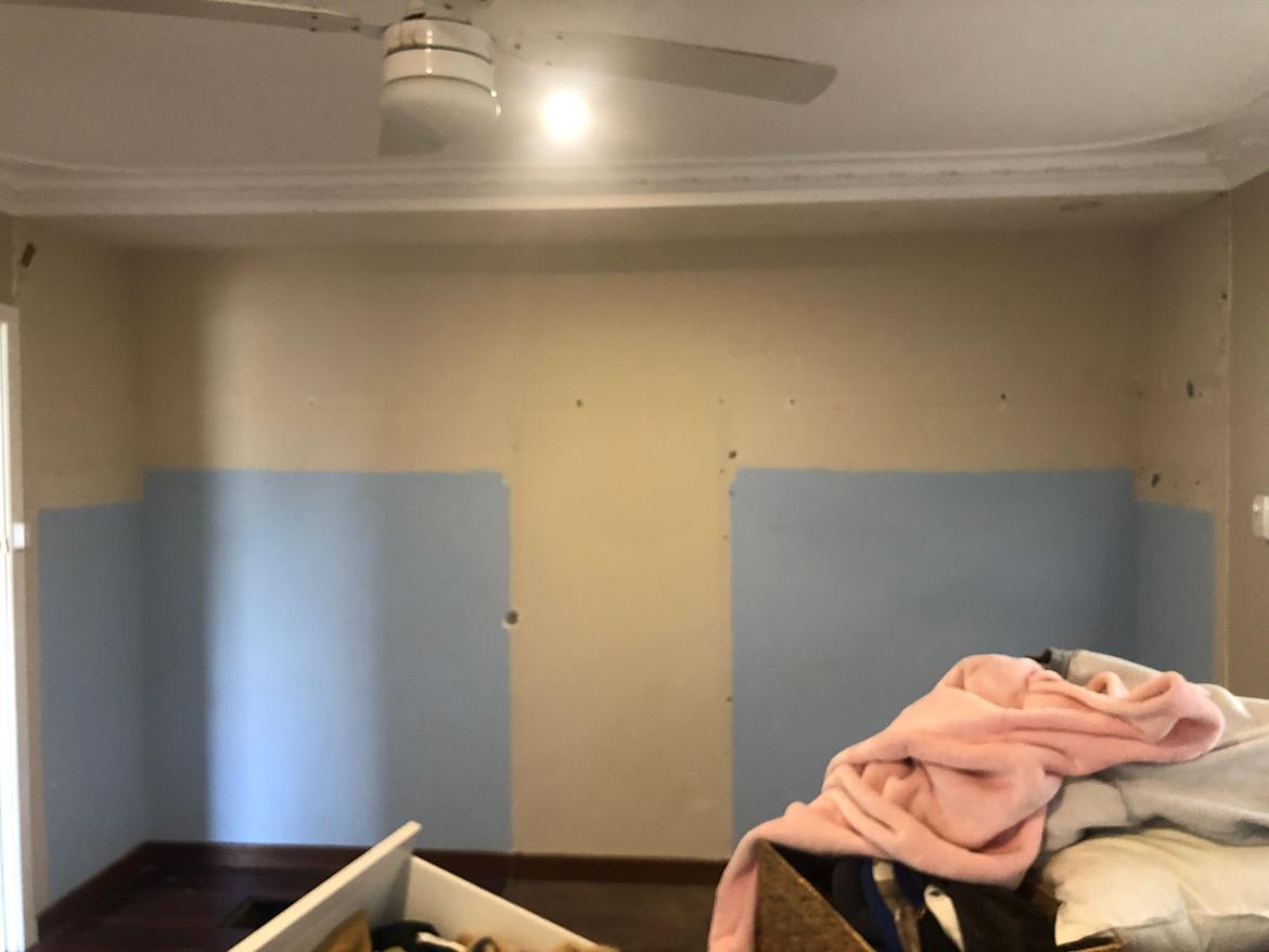

Prepare by removing all the clothes and then dismantle the old wardrobe.
Step 2
Dismantle and remove existing built-in wardrobe.

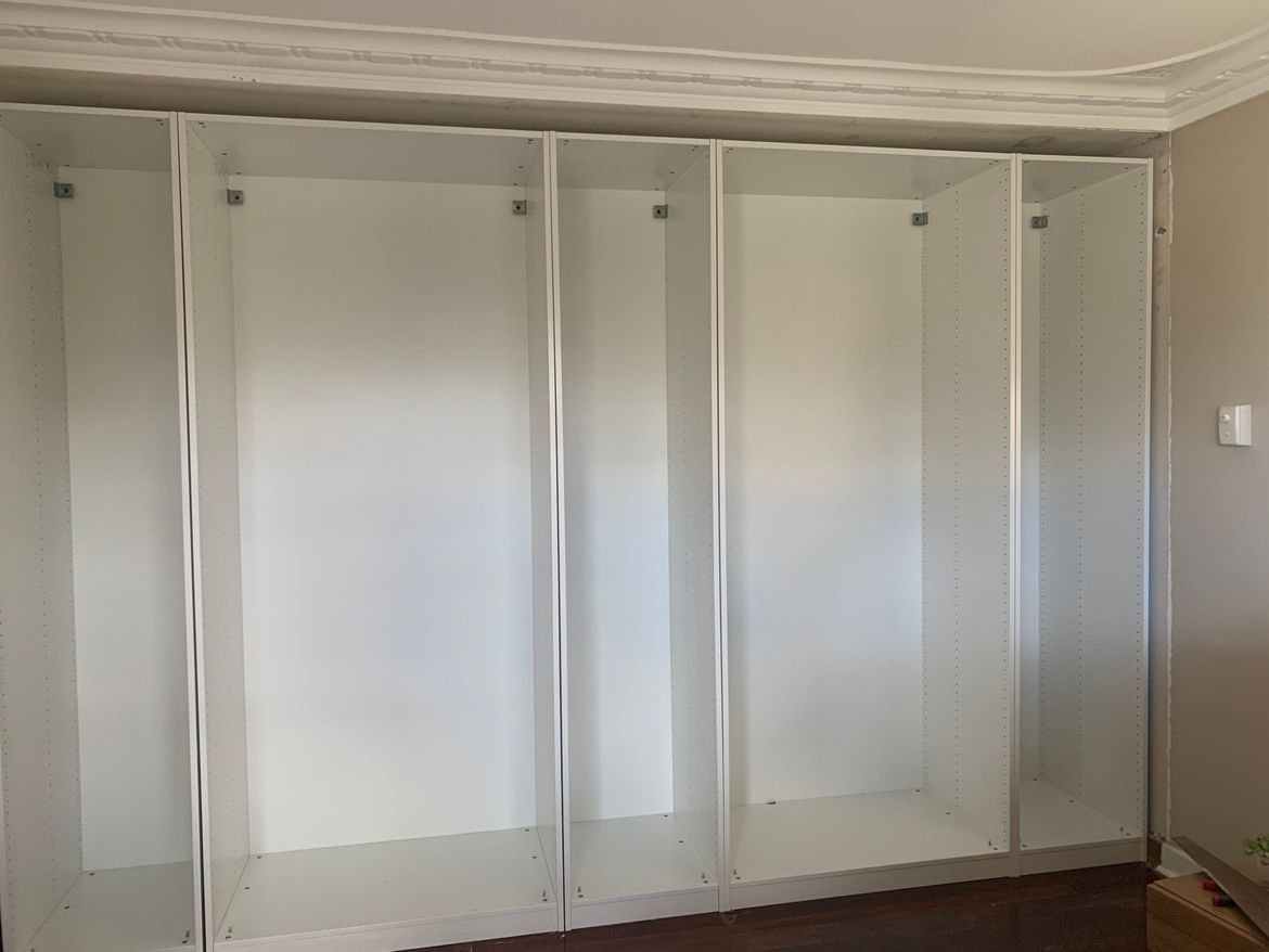

Build flatpack wardrobe bases. Making sure during the design phase to order flatpack sizes that will maximise the space available and fill out as much space as possible.

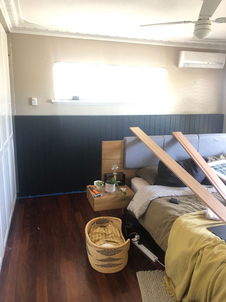

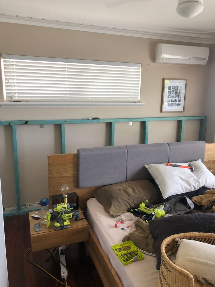

Remove existing skirting and build frame for panelling, attaching to the wall with brackets.
Step 5
Attach Easycraft VJ panels with nail gun and Liquid Nails, then paint.

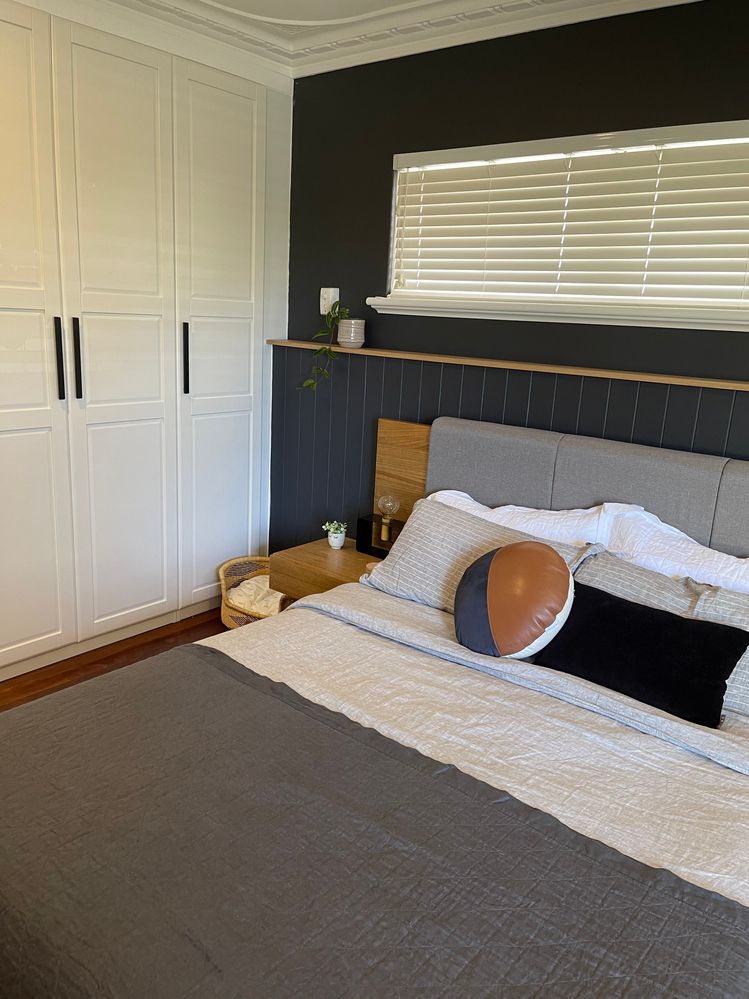

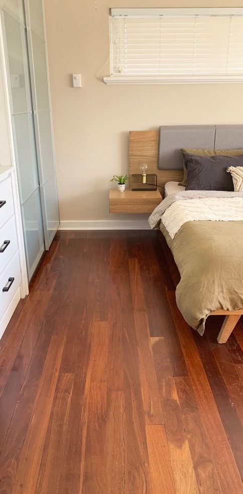

Using a cover panel the same colour as the flatpack, cut to size and attach the side of the wardrobe to give the illusion of a built-in wardrobe. Cut Oak ledge to size and complete painting, making sure to caulk and fill any gaps around the wardrobe cover panels.
Step 7

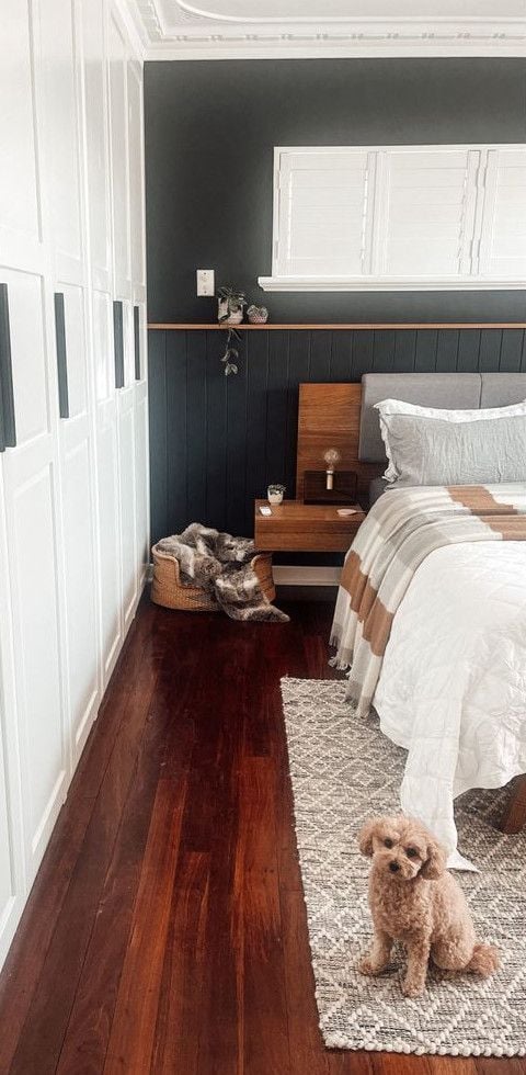

Paint and reinstall skirting in front of panelling. Install custom shutters.
