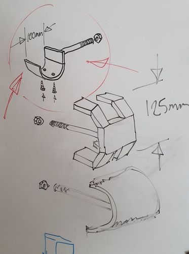

Is your plan to replace the round logs with new round logs? Still 125mm diameter?
How many brackets do you need?
Yours look home made with very thick flat plate.
Just some pre-lunch Sunday doodles.
Hi @JacobZĀ - the links to the pine rounds above aren't working for me?
But should @MSSM be interested in downsizing to 100mm diameter Pine Logs I'm keen to help fabricate something for you, like the top left.
See what you think.
Cheers.
