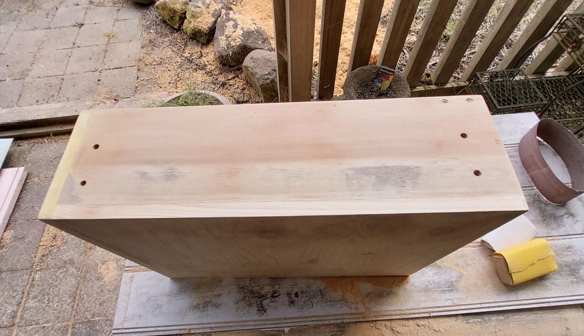

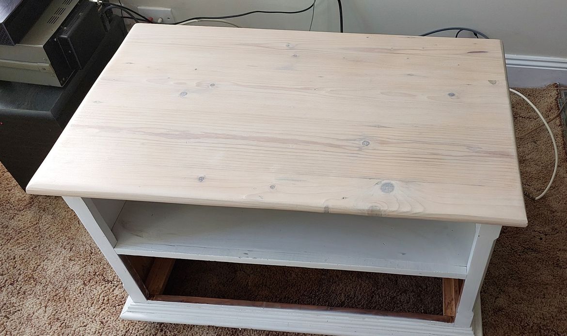

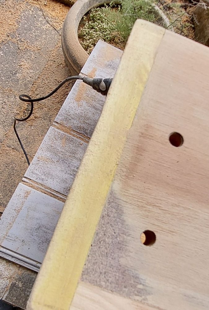

Use 120-grit sandpaper to remove older surfaces. Wipe down with a damp cloth. Apply the first coat of undercoat and sealer.

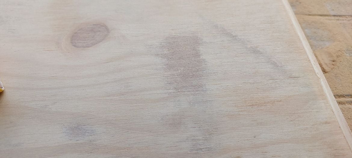

Use 240-grit sandpaper lightly before second undercoat.

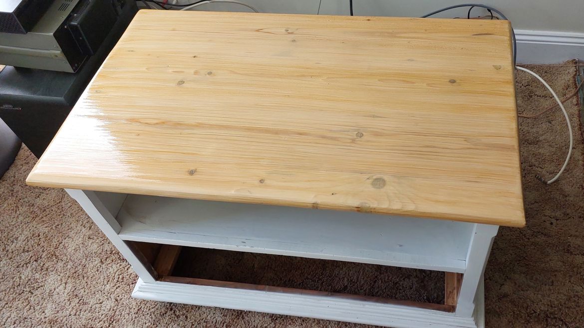

Apply a second coat of undercoat. Use 240-grit sandpaper lightly before the first stain and varnish. Apply the first coat of stain and varnish to show the wood grain. Use 240-grit sandpaper lightly before your second stain and varnish. Apply the second coat of stain and varnish to show the wood grain.

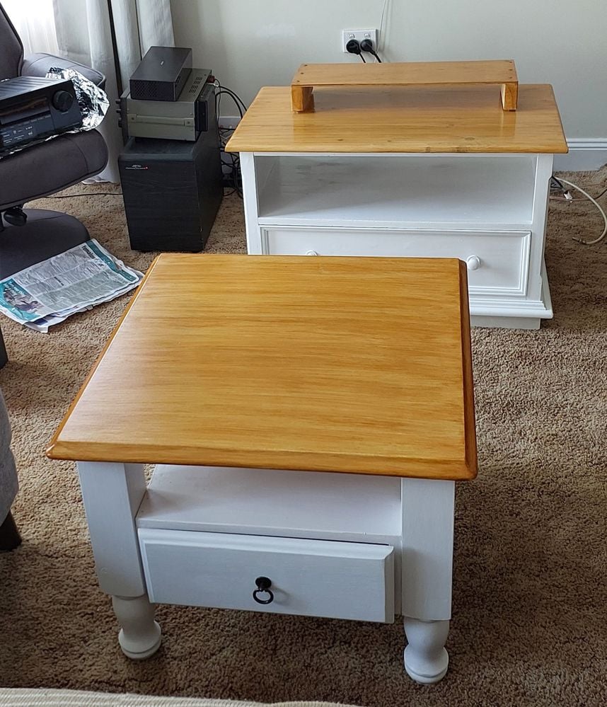

Day 3 - Reassemble.
Reassemble legs and tops to frames and refit drawer handles. It wasn't until this project that I even considered using an undercoat and stain/varnish combination until I realised that they are both water-based.
