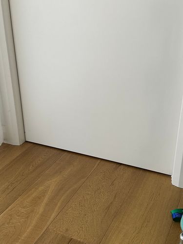

What can I use to fill the gap between the sliding door and floor?
Hi @NewbieDIYer,
The easiest solution to cover the gap is to use a draught stopper such as the Adoored Fabric Draught Stopper. Unfortunately, this would require moving it into place each time the door is opened and closed.
You could install a brushed weather seal such as the Raven RP83 Brush Strip but this would require you to rebate the bottom edge of the door to allow the door to slide into the pocket without the seal hitting the frame. If you wanted to go with this option, I would suggest it is best to contact a carpenter as this will require quite a few power tools and the knowledge of how to remove and reinstall a pocket door, which depending on how it was installed, will likely require you to remove some of the trims.

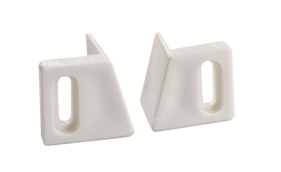

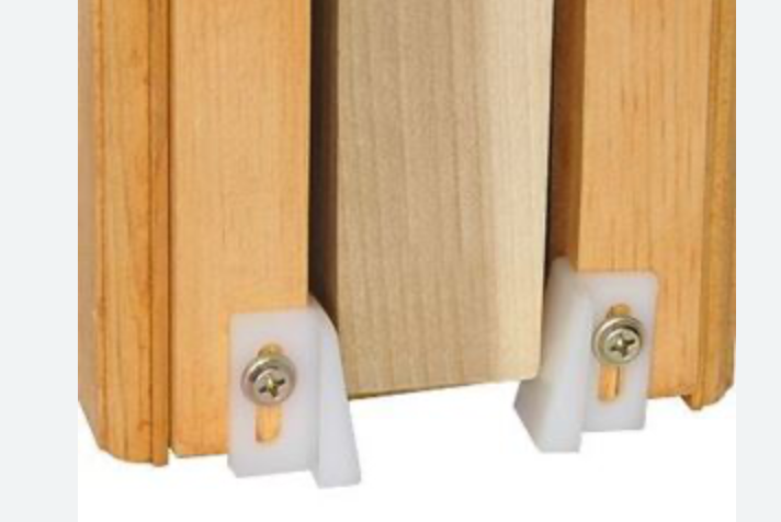

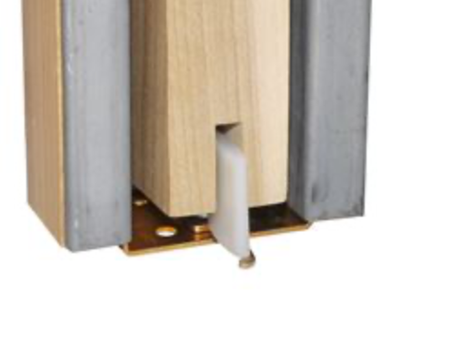

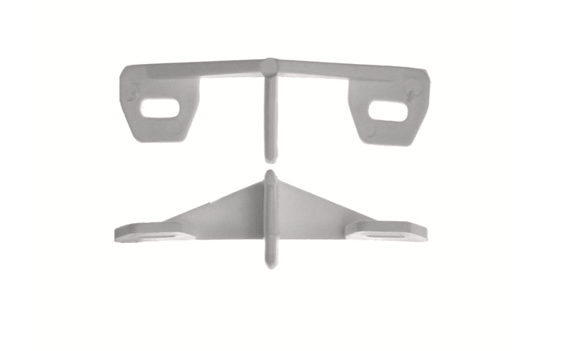

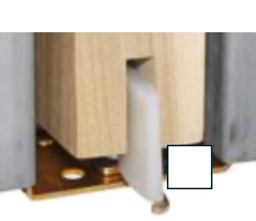

Hi @NewbieDIYer Agree as per @JacobZ suggestions. there is this previous article on how to remove a pocket door However there are two ways pocket doors are guided centrally at the bottom. One will have a at the bottom of there door frame a plastic guide on each side. But if you can't see these then there will be a central one under the door mounted to the floor or bottom of frame. These run in to a groove along the bottom of the door. In this can you wouldn't be able to fix a permanent brush strip unless you swapped this type out for the 2pce guided one.It might be simpler to just use a draught sausage?2 pc guide goes either side of doorThis type wouldn't work and would need to be swapped out for the 2pc.This type is less obvious and is floor mounted

If the door has a bottom guide rail potentialy you could have a draugh brush fixed next to it but that would be fine work and involve removing the door. @Nailbag bottom pic show the rail I am refering to, so crossing fingers it looks like that as it would be the best option to be able to screw a draugh brush on one side (not the corridor side)
