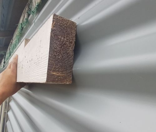

Like this... a steel or timber profile matching the corrie on one side, flat on the other for securing the beam through the beam, thriugh the spacer, to the uprights. A lip at the bottom to hold the beam until screwed through would be a bonus...
Obv span two corrie troughs, even a hanger would work with a corrie profile.

I can picture what you are talking about and truth be told I would be thinking the same thing. The only issue would be that the corrogated spacer/timber needs to be both sides so the tin cannot compress. Looking at your picture (hoping its just not an example pic lol) Wondering if your roof trusses could be extended ? Not sure structually if its wise. Or mount that timber strip above the corrorgated iron befor the roof trusses?

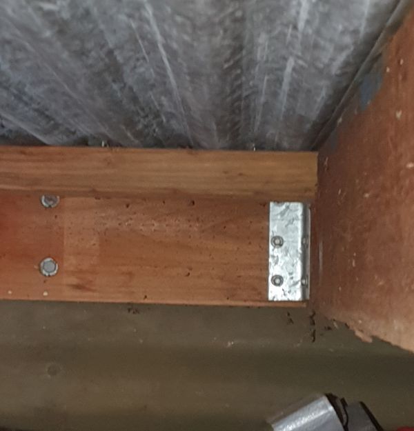

I think this is the important thing, once you bolt to the studs behind the corrugated iron - I don't think you need a corrugated profile.
I used treated sleepers to make that span, very much like your photo above...
