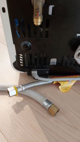

Hi I bought a 3 metre extension hose for my gas heater. I unscrewed the old hose off easily but I can't manage to screw on the new hose. The fitting seems the tiniest bit too small. The new hose is silver.

Hi @JulesPerth,
These hoses are designed for BBQs running a natural gas connection. They are not designed for internal heaters. Due to this, you'll likely find the variant in threads. The thread on our hose is 5/8" UNF (3/8" SAE). I recommend contacting the heater manufacturer to discuss what hoses would suit their appliance and purchase one designed for heaters, not BBQs.

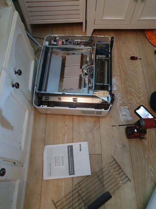

The biggest issue was the heater itself.
This is what it looked like one week after we purchased it.

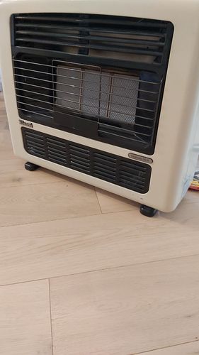

Morning @JulesPerth
That is the same heater we purchased last year.
We bought our 3 metre hose form Barbecues Galore.
Perfect fit.
No issues.
I can provide photos and further information if you wish.

Hello @JulesPerth
Welcome to the Bunnings Workshop community. It's marvellous to have you join us, and thanks for sharing your question about your gas extension.
I'm sorry to hear that the gas hose won't fit, just to be on the safe side, I suggest not forcing the fitting onto your heater. It's possible that there might be different extension hose for heaters. I recommend bringing your heater along with the hose back to the store. I suggest speaking to the BBQ specialist at the store and asking them about the hose and why it won't fit into your heater.
