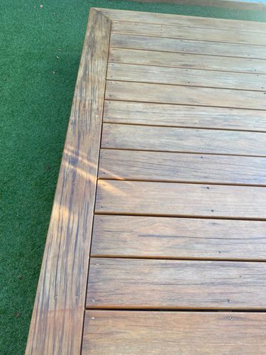

Hi
After rain, my deck gets black marks everytime.
it fades when it dry.
any help/suggestion please.
Thanks
Hello @narender
Welcome to the Bunnings Workshop community. It's sensational to have you join us, and thanks for sharing your question about your deck.
Looking at the photo you posted, it appears that the former seal of your deck has started to deteriorate. It's possible that the seal on the edge of your deck has worn away and thereby allowing rain to travel deep into the wood causing it to go dark. When the water dries out the wood returns to its original shade.
I propose sanding down your deck and applying a new coat of oil or sealer.

Thanks i will try that
