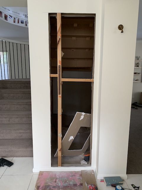

Step 1
First, I opened a small area of the plasterboard to check inside the cavity. The size of the hole was small enough that I could repair it if necessary.
Step 2
Once the small area is opened, assess the load bearing of the studs and create the necessary space to place the door frame with structural Pine. Do your maths two and even three times to include the door opening and door jamb spaces as needed. Add 10mm to be safe.

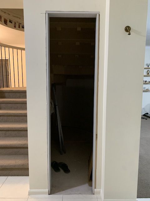

Step 3
Add the door frame and door jamb. Cross-check the measurements to be sure that you have enough space for the door plus some offset.

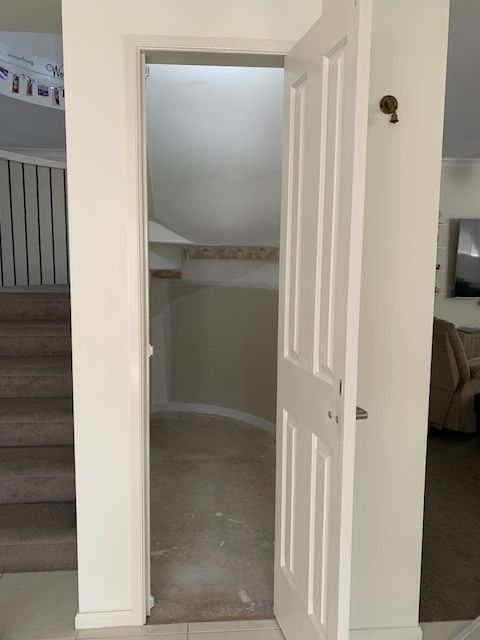

Step 4
Add the door and finish the inside with plasterboard and MDF.

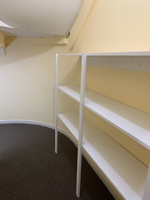

Step 6
Install smooth edge along the perimeter and lay down carpet. Install shelves.
