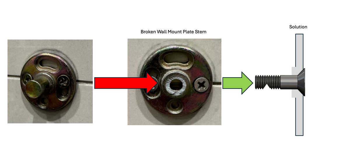

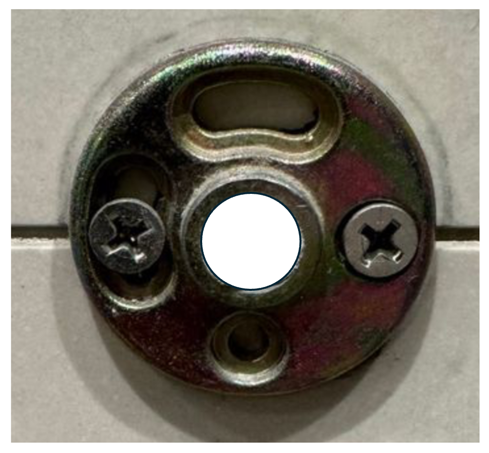

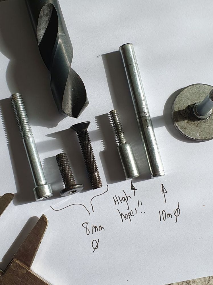

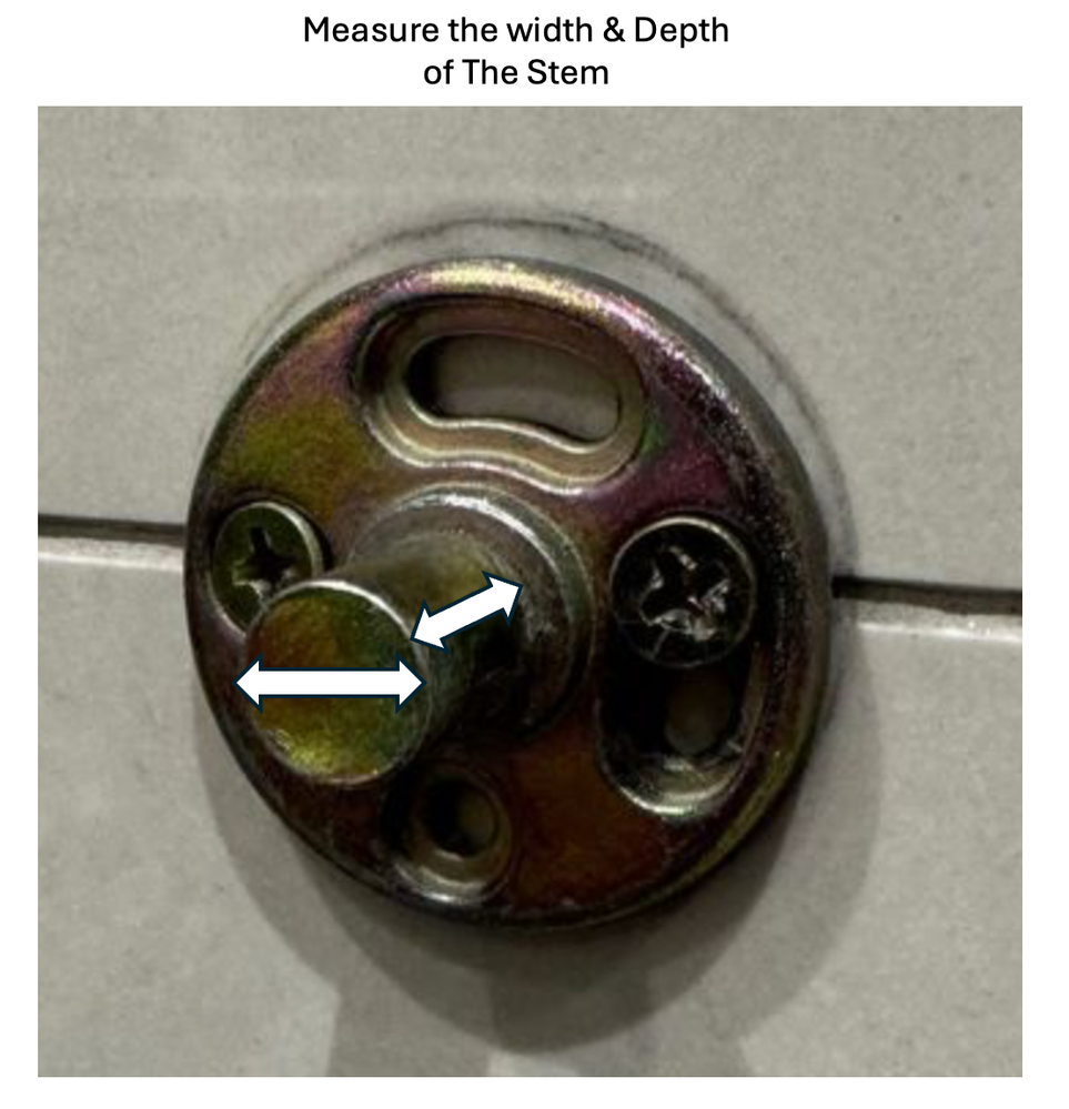

First measure the length and width of the broken stub and buy a bolt as close as possible. The width is the most important.

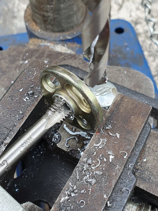

Then drill through the centre of the broken plate with metal drill bit.

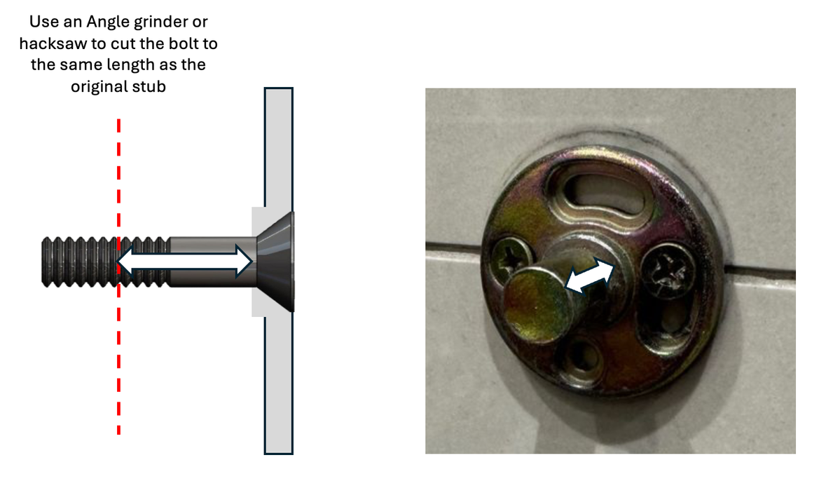

Insert the bolt and mark the length to that of the broken stub.
use a vice or vice grips to secure the bolt and cut it to length with the angle grinder.

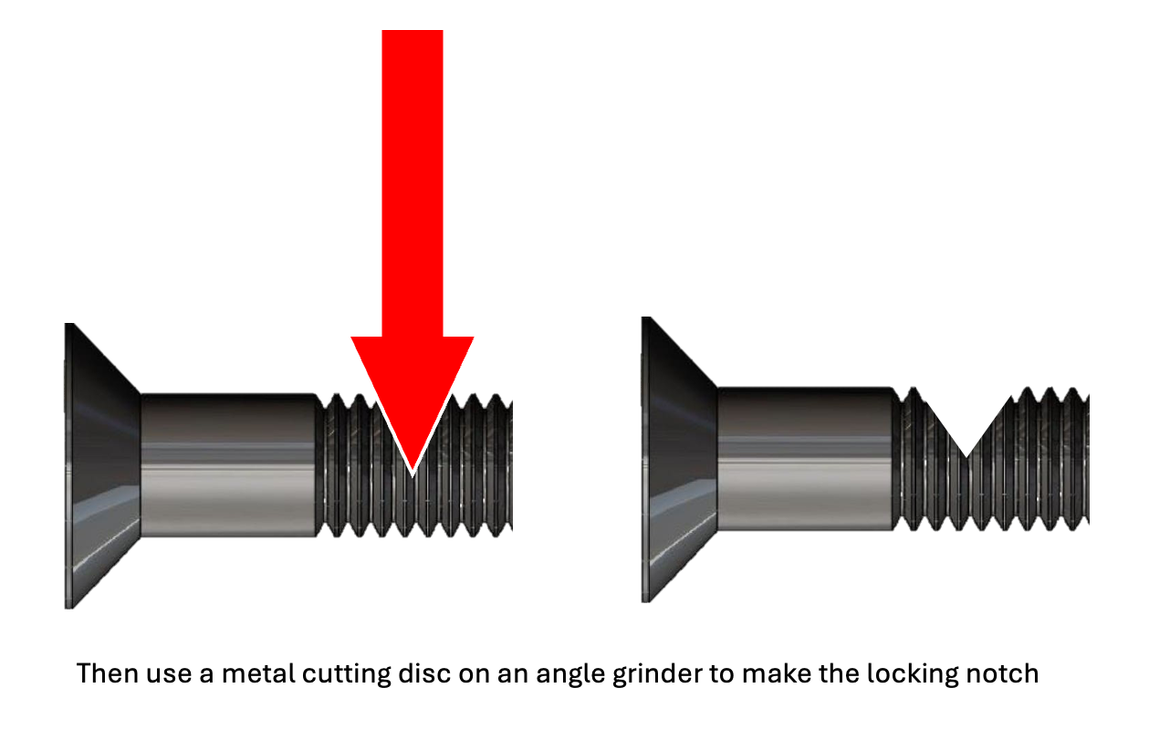

Measure the distance and depth of the notch the locking grub screw on the stub.
Reinsert the bolt through the plate and mark the location on the notch.
Secure the bolt in a vice or vice-grips. Then use an the angle grinder or hacksaw to very carefully make a notch in the bolt

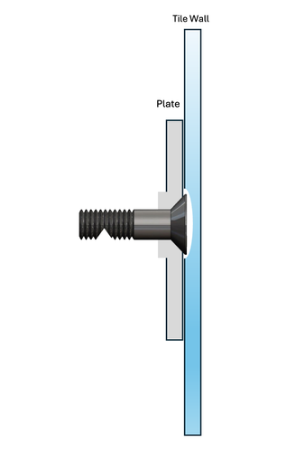

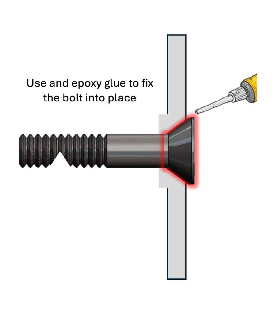

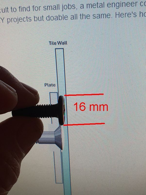

Refit the bolt and use an epoxy glue to secure it into place.
Step 5

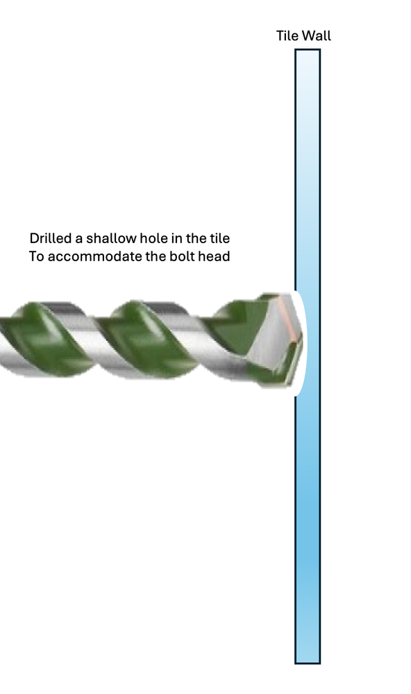

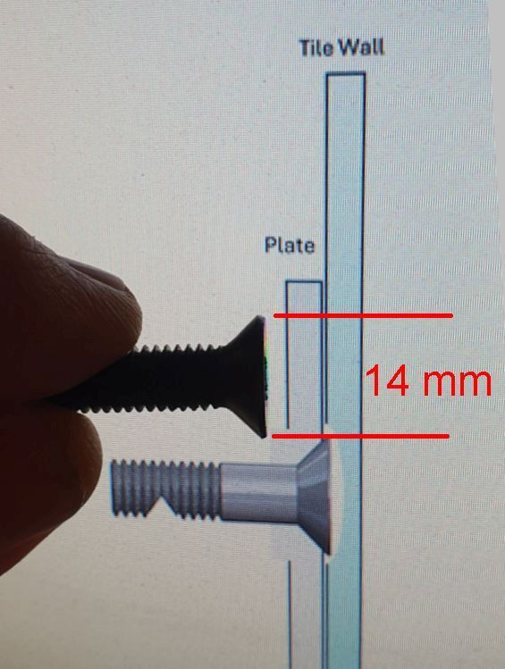

If the head of the bolt protrudes the depth of the plate, you will need to make a shallow cavity in the tile to prevent the mounting plate from sitting flat.
Use a 12mm multi-purpose bit to make a shallow indent in the centre of where the mounting plate is positioned.

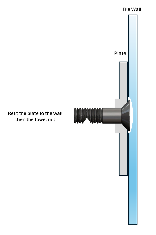

Step 6
Refit the mounting plate to the wall, then the bath/hand towel and you're done.
