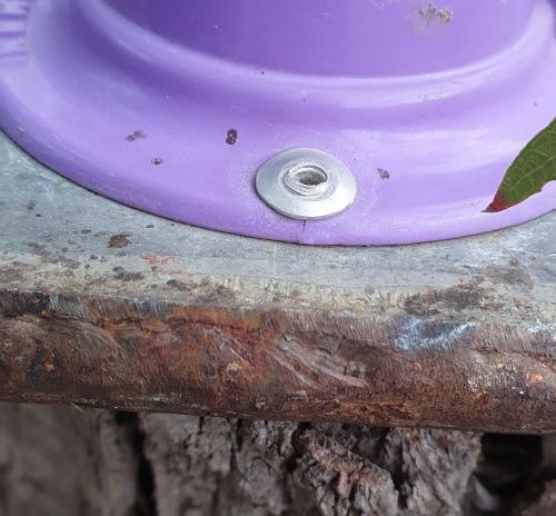

Just a sunset thought @JacobZ
I have drilled into thick steel - not all the way through - and with a judicious choice of pop-rivet length, it still manages to hold well. Nothing is seen on the other side.
12mm steel below.
I'm wondering if this would work if the stainless steel handle is solid?
