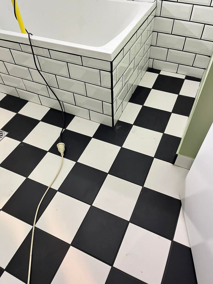

@TedBear @JoeAzza I must say I am impressed with the matt tiles; they went down a week ago when I first made the post & they are easy to clean. The trades have been in & out with mess left & at the end of the day they clean up & this is what I am left with, a very tidy & clean floor. I will be sticking with the matt tiles. Thanks Ted & Azza. 😁
Hi @Crofty76 looks good , nice job, I like the style and colour, well done
