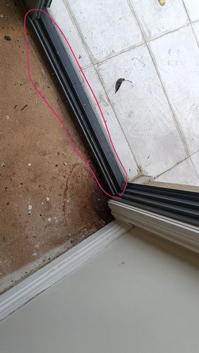

how do i fixed plz
what products do i use it?
this is 2nd floor in rumps area
when is raning the water stay in door frame
Thanks for any advice
Welcome to the Bunnings Workshop community @yuri3. It's wonderful to have you join us, and many thanks for your question about fixing a leaking door.You might like to start by reading through this very similar discussion: How to stop aluminium sliding doors from leaking?
To begin, you'll need to determine where the water is penetrating. Is water filling the door track and overflowing inside, or is it coming in under the track? Check the outside to see if there is a crack/gap between the tiles and the door track. If there is, this needs to be filling with Sikaflex 11FC. Under the door track would be the most probable entry location.Please let me know if you have any questions.Mitchell
