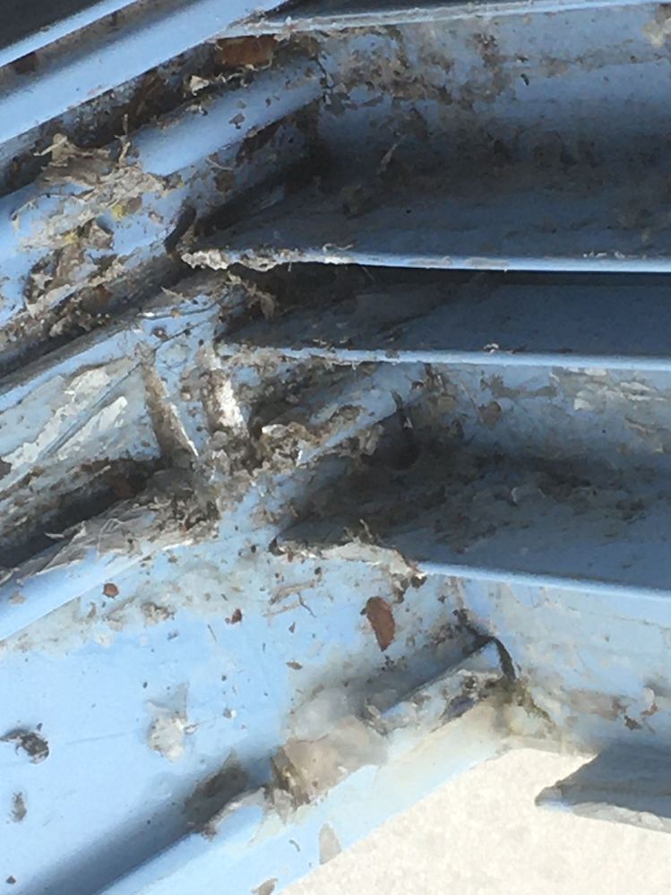

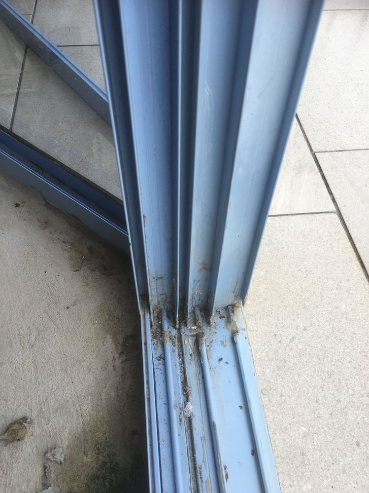

I have been trying for 7 years to stop the frame of 2 sets of aluminium sliding doors from leaking when it rains. I understand there should be a waterproof sill under them and I am trying to avoid removing the frame and putting one in as I think it could be opening a can of worms. The 4 pieces of the frame are simply butted together and I have removed the old silicon several times and replaced it with limited success. Once again I have removed the old silicon to try it again. Nothing that I have tried seems to dissolve the old silicon. What can you recommend re cleaning the area properly (I have tried Turps, Metho, acetate). What product would you recomment to reseal it (I have used several silicons including Roof and Gutter Silicon and I think a Sikens sealant.IMG_4405.JPGIMG_4406.JPG

Hi @Russ42 , judging from the photo - assuming that the Righthand side of the photo is the outside (the small gaps in the wheel guide channels, which appear to be blocked with silicon in the photo, are to drain any runoff to the outside)  - and if the frame is sitting at outside floor level, as it appears to be, then your can of worms has already been opened and has been active for 7 years.  The water seal comes from having the frame sit above the floor level and there is no way that those channels can keep water out. They are only to guide the wheels and the only part of the doors that sits on them is the wheels. There will be a gap above them since the doors themselves don't sit on the channels and they will only let any small amount of water that slides off the outside glass run out, but not prevent any quantity of floor level water from coming in.
You could try the door seal strip as suggested by @EricL  but it is likely that water will seep under the frame and down onto the lower floor inside.

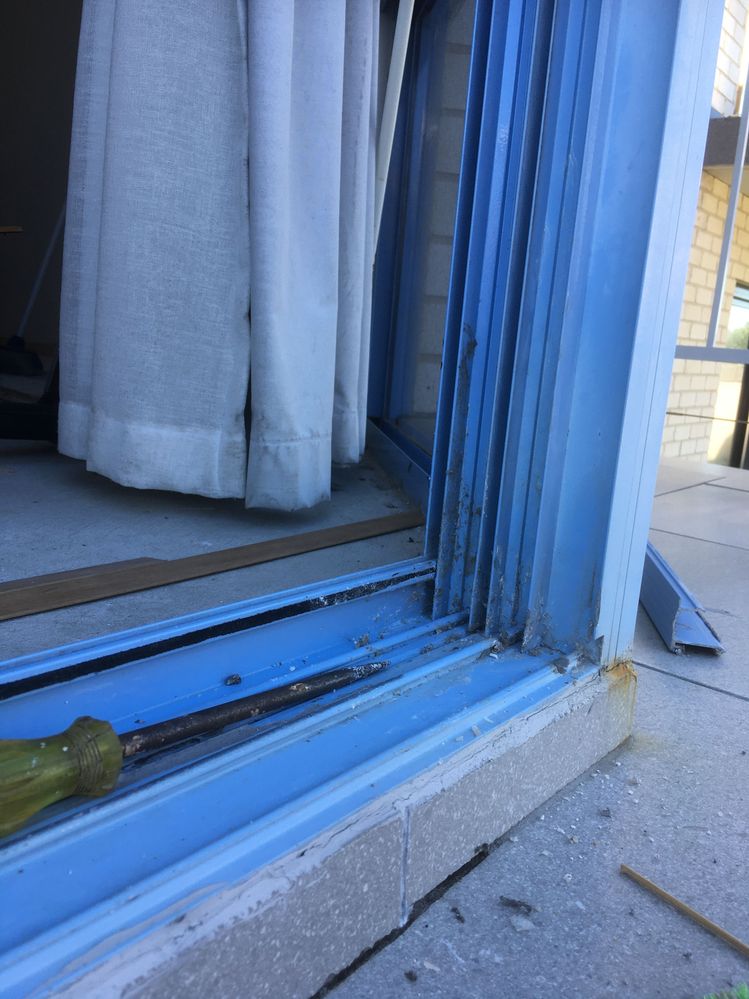

Thanks Eric. I have worked on it since I posted to remove more of the silicon. I have also applied a gel silicon remover recommended by the experienced fellow at the paint section at Bunnings. I am having trouble removing the dead silicone and the gel from the small gap on the left of that photo and am thinking of trying a gentle water blast, in the absence of an air compressor. As far as your question as to where the water is entering from: the vertical sill on the far inside of the bottom frame is about 50mm high so water is not entering over that. It is my opinion it is entering through the but joint of the vertical ( door jam?) and the bottom track. There are no drain holes as shown in your photo (I suspect there could be if a flashing was installed under the door frame when the doors were installed). A Raven Weather slip may help but I doubt, in driving rain (it faces south west), it would seal the doors. Thanks for your help, Eric. I will attempt to post a photo showing the inside vertical sill I mentioned above.IMG_4418.JPG

Thanks Nailbag, I think I answered your question above. It is my belief the water is getting in through the tracks. I tiled the outside and was very careful to bring the membrane up the small wall in the photo and to the door track in case water was getting under the door frame. The grey silicon beween the door track and the tiles seems to be intact still

Thanks Dave-1. It is my belief the water is getting in through the tracks. I tiled the outside and was very careful to bring the membrane up the small wall in the photo and to the door track in case water was getting under the door frame. The grey silicon between the door track and the tiles seems to be intact still. See the photo I posted in re[ply to EricL above.

Thanks TedBear, The Righthandside is the outside but, as you can see from the reply photo I posted to EricL above, those breaks in the door tracks do not impact on the drainage as the inside channel wall ( about 50mm high) is the key. The breaks in the door tracks were put in by a previous owner. Also, the channel is above both the inside floor and the outside tiles. To answer your 1) above: lots of water comes off the doors as they face south west. Your number 3) above is my plan B and may open a can of worms. Thanks for your reply, TedBear.
