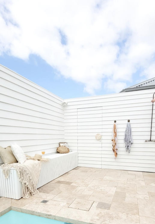

A pool blanket storage solution that doubles as a bench seat.
The project
A pool blanket really works to help keep the water clean and also warmer for longer, which saves us having to turn the pool heater on. This is where this DIY project will really come in handy.
Some things to note: If you want to do this as a bench seat like us, you will need a low-profile roller which is usually about 400-420mm high. The standard height for a bench seat is about 450-480mm so your feet can comfortably touch the ground when you sit down.
