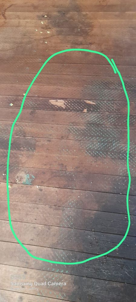

I discovered this floor bump (seen in the photo) after removing the carpet and underlay. Do you know how to get rid of that? This is preventing me from doing hybrid vinyl flooring the way I want to.
Regards ahead of time.
Hi @SyedJaffry,
Thank you for your question about fixing the hump in your hardwood floor.
It looks like the board 4th of from the top of your circle is raised and maybe a little bit cupped, is this the issue you were having?
If this is the case, the first step I would take is to see if the boards have slightly raised from the joists and can simply be hit back down into place. I'd suggest to do this you should grab a scrap piece of timber, to act as protection for the flooring, place it over the nail holes in this raised board and hit the block with a hammer. If over time, the nails have worked their way out of the joist below, this will knock the board back down into its original position.
If you find that this does not seat the board back to its original position, the floorboard may have cupped over time. To bring this down level with the surroundings, you will need to plane and sand the floorboard back to the same level as its surroundings. Start by using a nail punch to sink the nails below the surface of the board. Then, you can use a Bench Plane to remove the bulk of the material, before switching to a random orbital sander to smooth and finish the process.
If the area is larger than I can see from your images, it may be worth looking at hiring a Floor Sander to speed up the process.

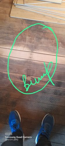

Thanks, for your reply, I sanded the area as much as without destroying the wood floor.
It was the maximum I could sand; after that, the wood would be so thin that I stopped it. I got another idea and will implement it this weekend I will balance the wood and future vinyl floor by underlay and hope it will work.
I will update you later as I complete that experiment.
This is the picture after sanding.
If the raised section is now not too high, adding the underlay will help improve the area further @SyedJaffry. Let us know how you go, and reach out if you need further assistance.
After grinding/sanding the floor wood to level as much as can (look at the recent pictures). I used underlay which made the floor even and gave space to level the floor then I did the Hybrid Vinyl flooring. It is time-consuming but good to save a lot with learning.
