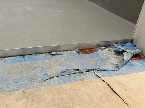

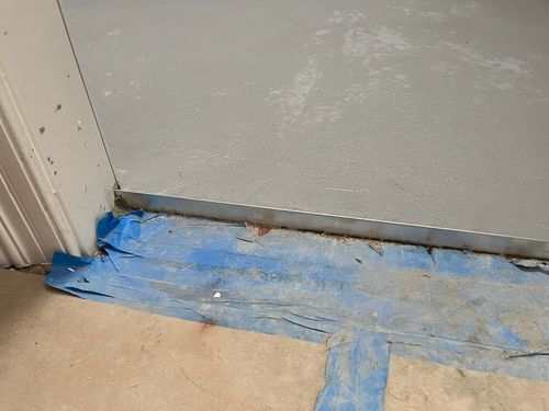

How do I best handle a 25mm transition from a newly installed bathroom to hallway timber floor ? Most of my internet searching shows a standard 10mm riser to help the transition but nothing covers 25mm ? Any advice appreciated

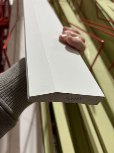

Hi @LAP This is the pre-made skirting profile I was thinking and looks to be the same as @Noyade DIY version. Its found in the indoor timber section.
Yes I investigated that , the height is a little short by mm but the upside is it is on a gradient so it looks better .. certainly an option @Nailbag
lol , I’m with you , I bloody stub my toe on a matchstick ! 🤣
That’s the one I spotted on line .. I’m going to check it out ., it certainly makes for a better finish
