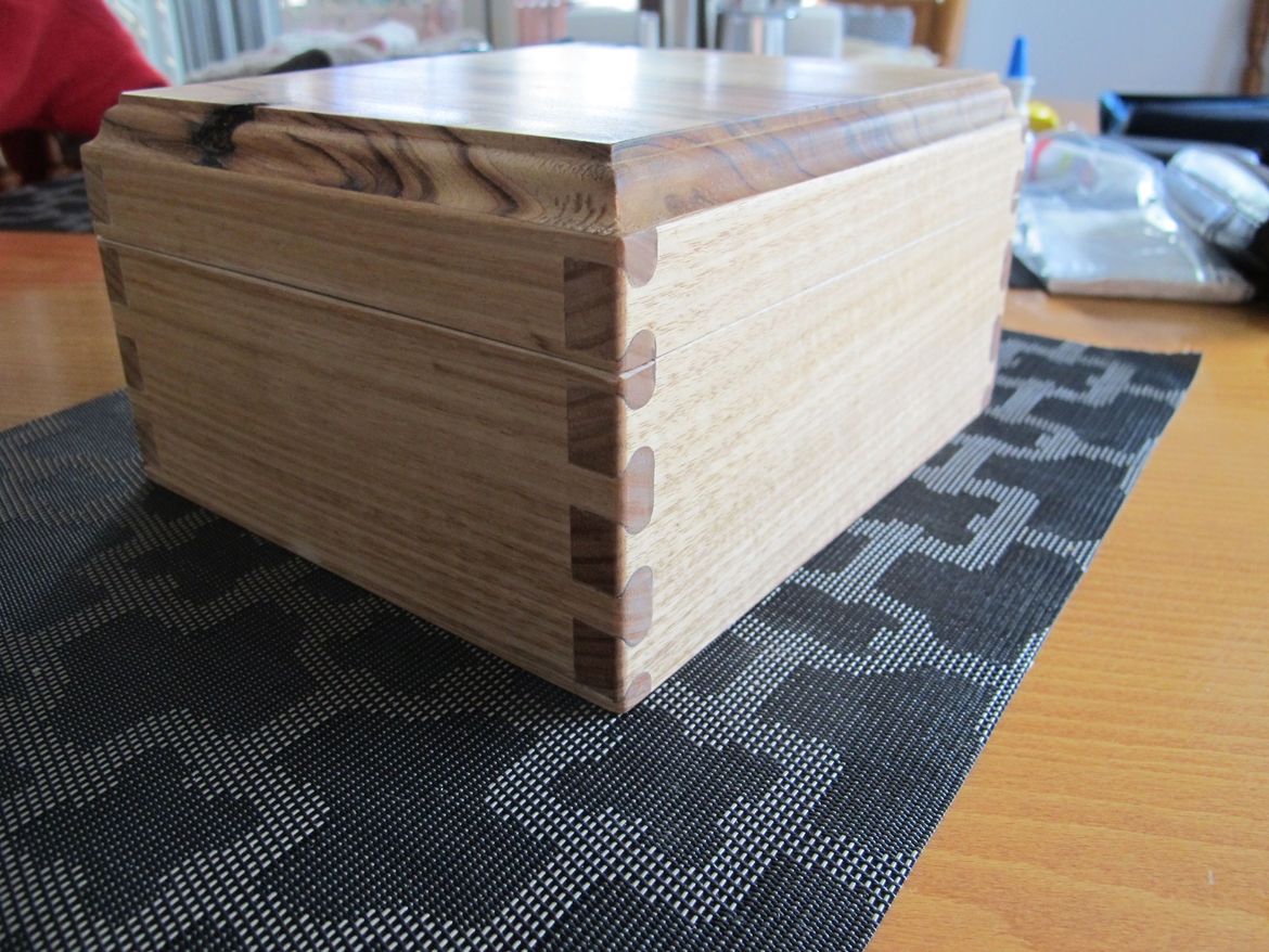

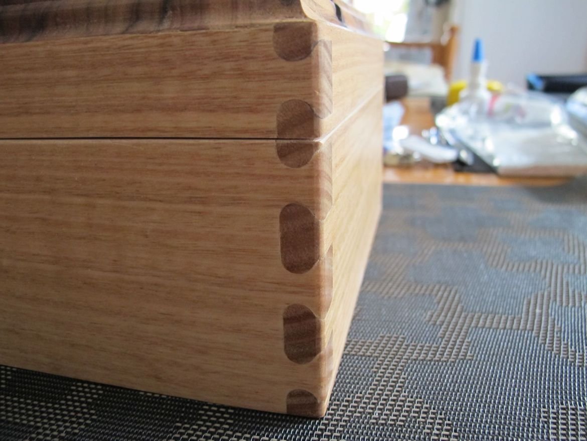

My how time flys when yah having fun. I have been trying some new joint methods "Isoloc" So i though I would start with another jewellery box because there is always some off cuts laying around. But I have come to a holt. I need some Meranti and can not find any in the local area (Melb North East) anyone with any ideas?

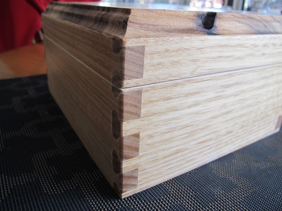

I have also been playing with finishing methods using wet and dry and metho. The dust from the wet and dry mixed with the metho makes a great natural wood filler and will stain the same colour as the timber being worked on. This box has all the knot holes left in for some character.
Some photos so far
