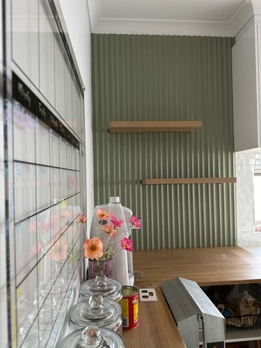

Oak Flexi Storage floating shelves and Porta Cirque lining boards painted in Dulux Herbalist make this coffee station a feature of the kitchen. It was the winner of the best small project in our 2024 search for Australia's best D.I.Y. projects.

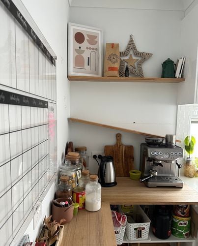

Step 1
Where it started with the original shelf falling down!
Start by measuring up the space you want to panel. My tip is always measure twice or three times and at different points of the wall.
If your putting shelves up, locate the studs and secure the shelves to the specifications on the packaging.

Step 3
Remove from the wall and paint away.
Grab your adhesive and nail gun and start panel by panel. Place Liquid Nails on the back of the panel and put into position and secure with a few nails in the channel to hold it into place. Repeat this step until you're finished.
Once everything is up, give it a touch up with paint if needed.

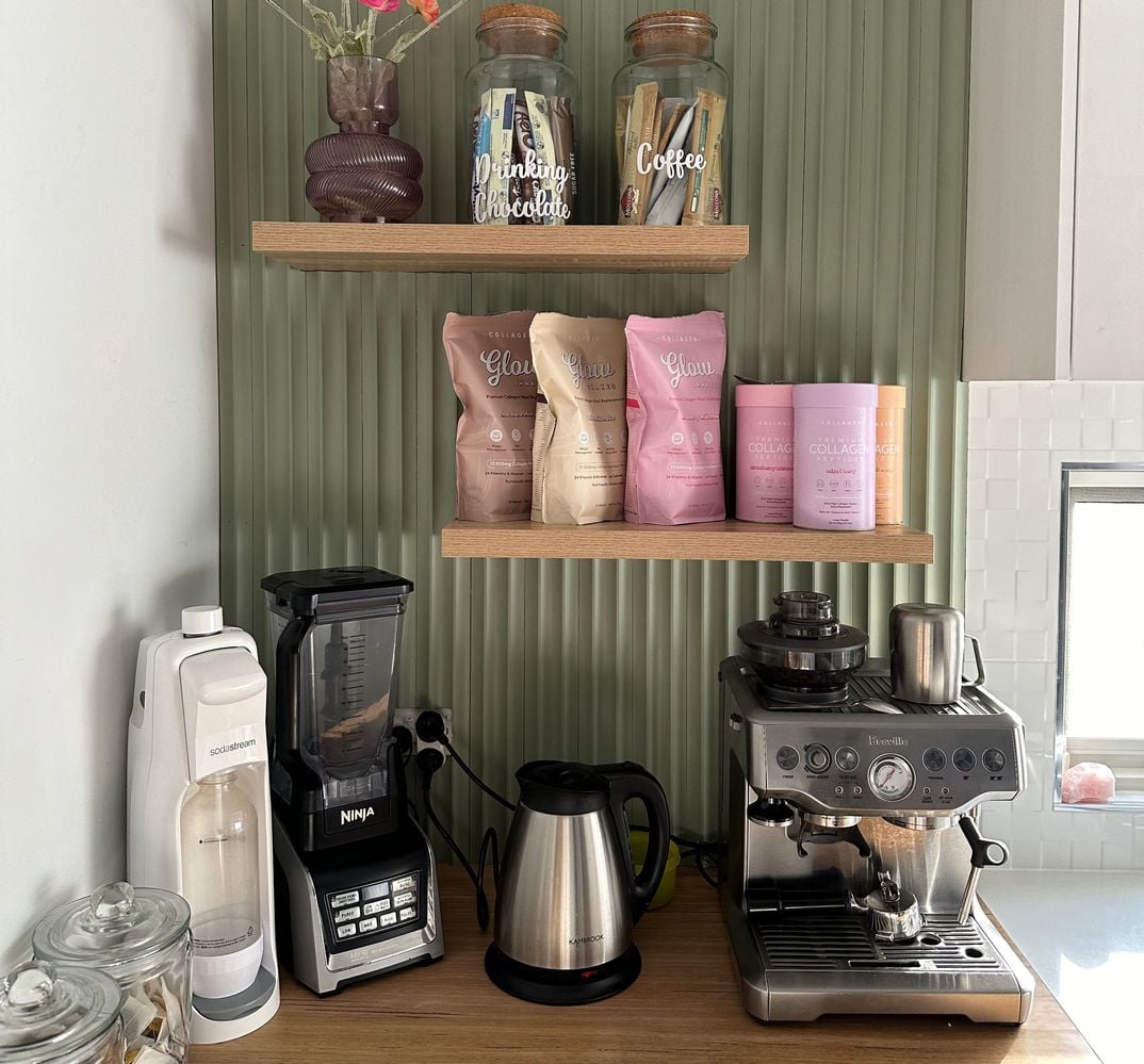

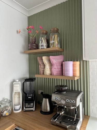

Step 4
Styled and ready for coffee making!
