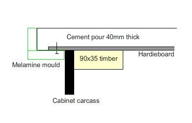

I'm planning to make pour in place concrete countertops for a new kitchen and I was wondering if anyone had done this and had some feedback to share.
The tutorials/youtubes I've found tend to be american liquidcrete products and forms, but I'll be making my own. So my questions relate to the materials, reinforcing and thickness of pour.
I plan to make up my cabinet carcasses out of standard melamine particle board as per normal, but reinfoce the tops with 90x35 pine. The base will be hardieboard, overhanging the carcasses by 30mm. The forms will be L shaped of melamine cut to 50mm strips. These will be screwed to the hardiboard overhang through the bottom, spaced out 20mm out so that the concrete edge will overlap the edge of hardiboard so it wont be visible from the side. Here's a profile of what I mean.
As for materials, I plan on using MaxPRO 20kg Concrete Mix as it has "crack resistant fibre reinforcement", tinted black with Dulux Avista Oxide (1 bag of oxide per bag of concrete.) I'm assuming I still need some sort of reinforcement so using rapicmesh galvanised 25mm mesh panels, fixed in place with plastic spacers so it doesnt float during the pour.
For thickness of pour I'm going for 40mm - unfortunately the height of the dishwasher and the height of the window sills means I need to have it no more than 45mm thick.
It'll be 7 linear metres of benchtop, which works out at about 17 bags of concrete or about 350kg finished, so I think the reinforced cabinetry will be strong enough.
Has anyone got any thoughts or experiences on this plan?
