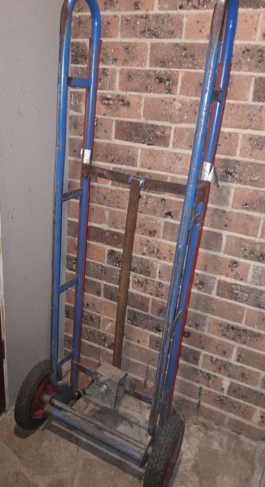

We have borrowed this trolley to help us shift furniture to the garage as house is being styled for market next month.

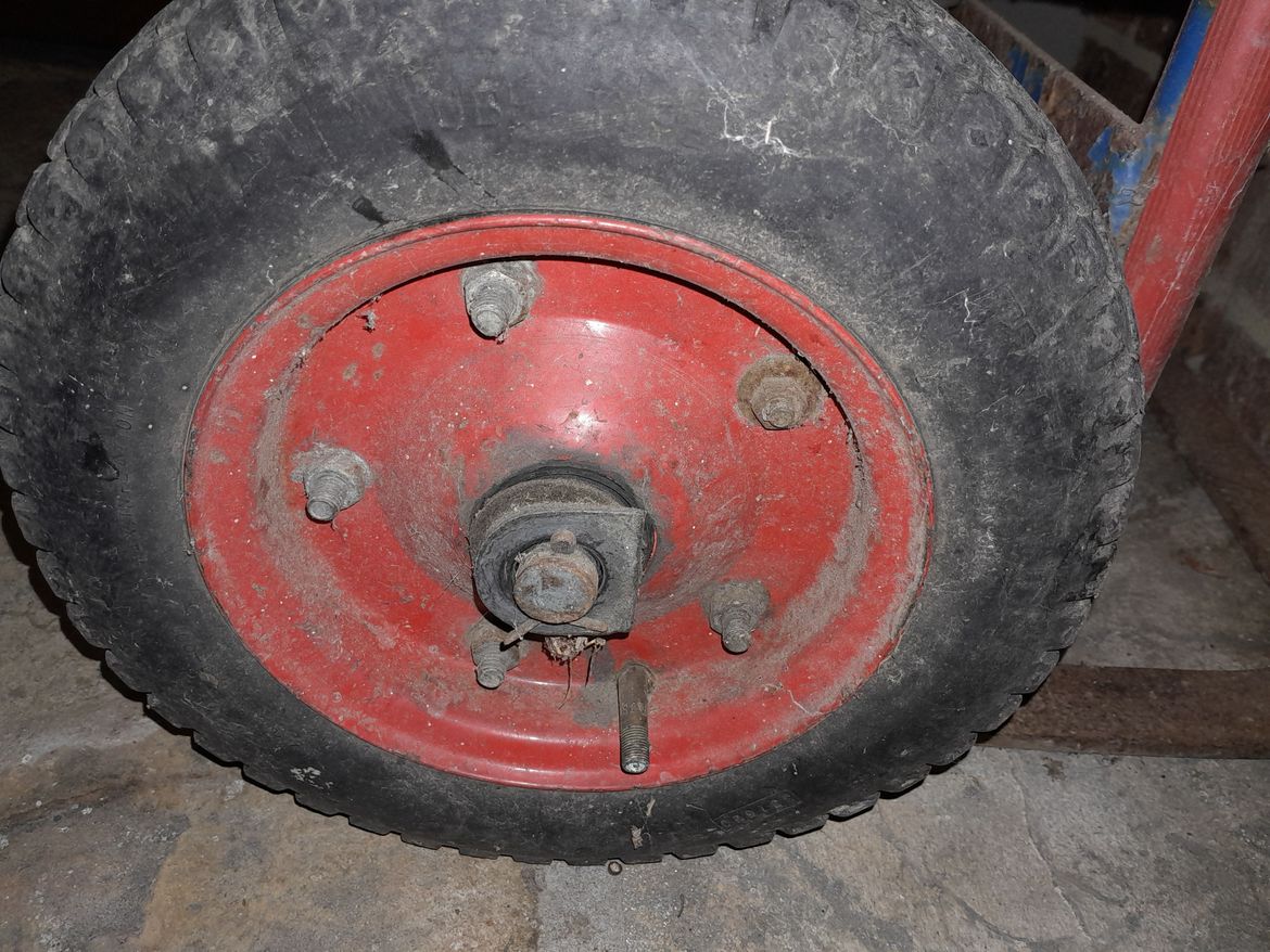

One of the wheels is continually flat and goes down even when pumped up. I went to Bunnings last week and bought a new wheel. However, it is smaller, maybe they no longer make the same size. What is the difference between offset and pnuematic? The size is 27cm diameter of the old one, measured from one side of the tyre to the other. Could both wheels fit and work if smaller and is this a job we can do ourselves? Do you know anyone who would fix it if we can't?

Hi @gnicholson,
All those wheels are pneumatic, which means they are filled with air. The one that mentions offset is likely referring to the axle being offset.
If both wheels were replaced, you could likely use the slightly smaller versions. The other option would be to change the inner tube in the deflating wheel. The hub is bolted together on your wheel, so you can disassemble it to make the inner tube installation easier.
Removing the split pin on the end of the axle is how to remove and replace the whole wheel. This is a relatively easy job that you can do yourself.
If you were to take the trolley to someone who services ride-on gardening equipment, they should be able to change the wheels or inner tube.

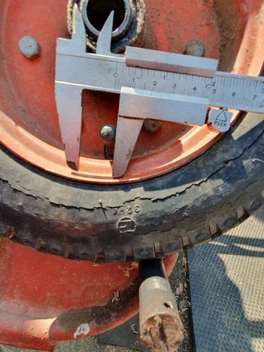

I'm wondering if my cracked tyres are contributing to the overall 290mm outer tyre diameter?

I don't believe they will @Noyade. How wide is it across the steel wheel section? Those Sherlock are only four inch.
At 290mm, those would be considered very large trolley wheels. They're more similar to a small wheelbarrow wheel. Are there a series of numbers on the tyre we can reference?

Rough estimate is they would be around 40 years old.
Hand made welded trolley by my father.
The locking ring grub screw - is most definitely imperial - 1/8" hex.
See what ya think mate.
Fissures appearing...
