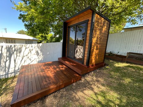

I needed a base for a kit sauna
My backyard has a considerable slope

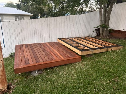

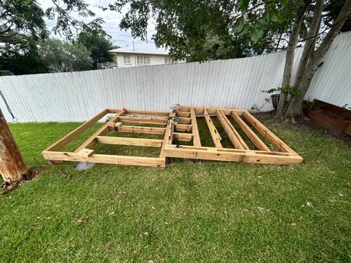

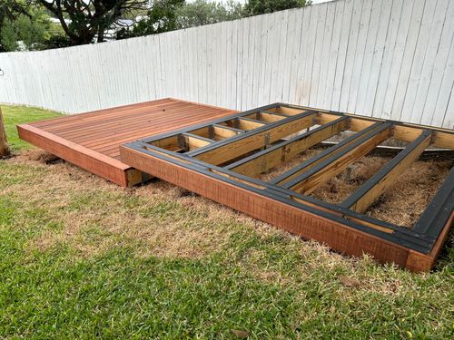

I decided to build a 2 level deck to manage the slope
The dimensions mirrored what I needed as the base for the sauna

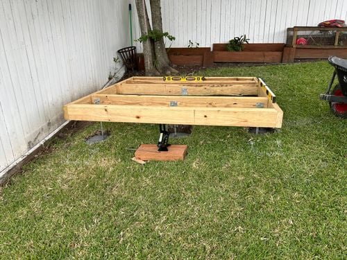

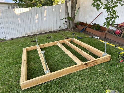

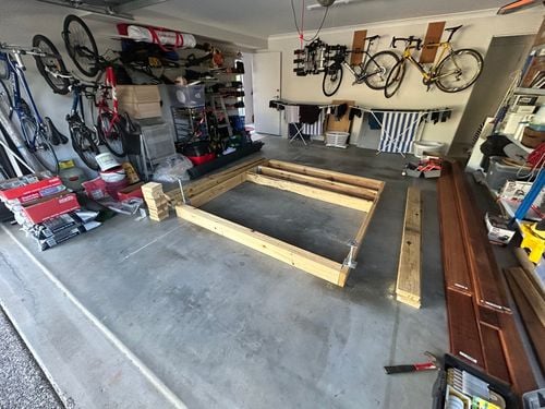

The frame was assembled upside down in the garage and the stirrups were attached

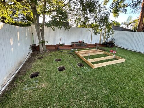

Holes were dug insitu and the frame was lifted in (very heavy-needed extra hands)
The frame was levelled and concrete was mixed and placed into holes
After curing, I finished the deck with joist tape and the 90mm preoiled merbau decking
