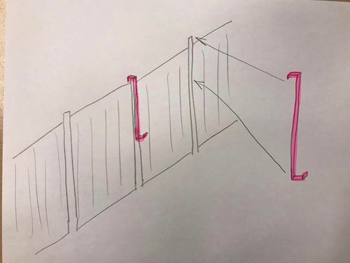

Instead of drilling into the fence. How about making up a hook bracket with some flat steel.
Flat steel strap say 30mm wide.
Imaagine it hooked up and over the fence post and then turned down by 1cm
Then down the height of your fence to about half way.
Right angle out the width of your solar light and a 1cm turn upwatds.
Think a Very elongated straight shaped S
No holes needed and they can be removed easily. If you want to screw them I would say screw them to the fence posts as @EricL has suggested. That would give you the best structual spot and you are allowed to do that to your side of teh fence (as long as it dosnt protude to the neighbours side)

Thanks @Dave-1 . Making this hook bracket sounds doable - I think I got the gist of it; you have any photo of how would it look like. And can I get these straps at bunnings, or elsewhere?

Morning @rsanghoi
Airco 30 x 0.8mm x 6m Structural Galvanised Strapping or
Carlray 25 x 1.2mm x 1.8m Galvanised Hoop Iron (This could be better as it is thicker but narrower :/)
I listed two differeant types of metal strips. It would be an idea for you to check out your top of fence and then check out the two types at Bunnings. That way you can judge which will work better. You have 12 lights so Im thinking at least 15-18m of the strapping you will need.
