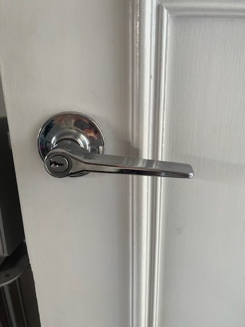

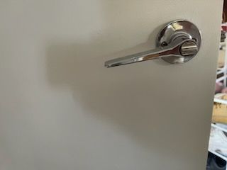

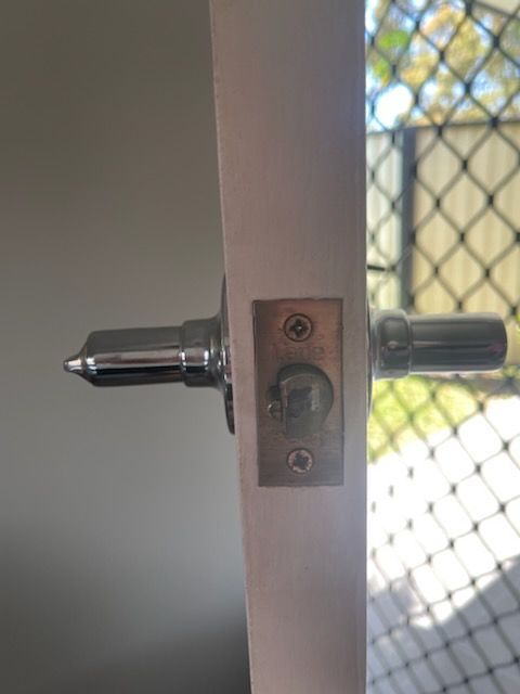

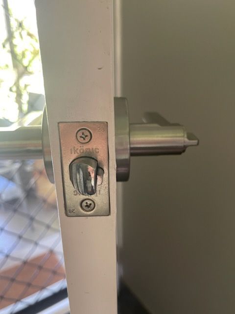

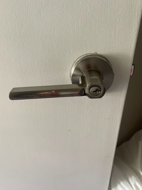

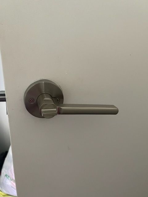

Moving into a new house in 2 week's time. Two locksmiths already have told me they won't quote for rekeying one of my locks: one said he won't rekey the front door Ikonic and the other said won't rekey the back door Lemaar lock on the Lane. Their reason was bad quality of lock
back door
back door
front door back
front door side on
back door side on
front door.
I'd rather buy 2 new cylinder locks but how can I be sure new locks will fit? Should the existing locks be measured first? If I get the wrong size I'll have to call out the locksmith again. Would the Lane Satin Stainless double cylinder deadbolt for $44.35 be compatible with the existing hole in the door? Or would you have a different recommendation?
