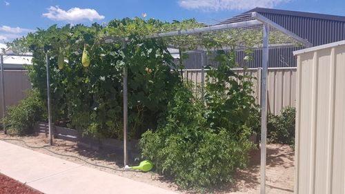

Hi, See the picture attached I want to do something similar, instead of welding I want to use Gorialla Glue. How strong it can join the galvanised tubes? What will be its longevity?
Regards
Kiran

Hi Mitchell,
I purchased square tubes 20mm x 20. Welding looks best option for my project (3 posts either sides & 3 in the middle with external beams on all four sides and 1 beam in the middle) length 5.5 m x width 3.5.
I have no experience with welding, is it easy to do welding?

Hi @kiranraob4u,
Gorilla Glue wouldn't be suitable for joining galvanised tubes because it’s designed for materials like wood, metal, ceramics, and plastics, but it doesn't provide the structural strength required for holding metal tubes together under load. Glues like this are not strong enough to handle the stress and movement that a metal frame typically endures, especially over time and in outdoor conditions. Galvanised metal also has a protective coating that can reduce the bond strength.
If welding isn't an option, the best alternative would be to drill through the tubes and secure them with bolts. This would provide a much stronger and more reliable connection, ensuring the frame is stable and durable. Make sure to use bolts suitable for outdoor use, like galvanised, to prevent rust and maintain the longevity of the structure.
An alternative to drilling through the square posts would be to use round posts and fittings similar to the ARC Fences 25 / 25mm NB Corner Gate And Fence Fitting. These clamping fittings are a simple way to create a robust frame.
