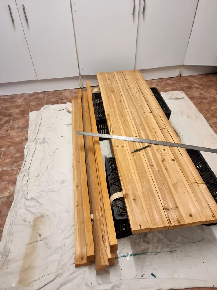

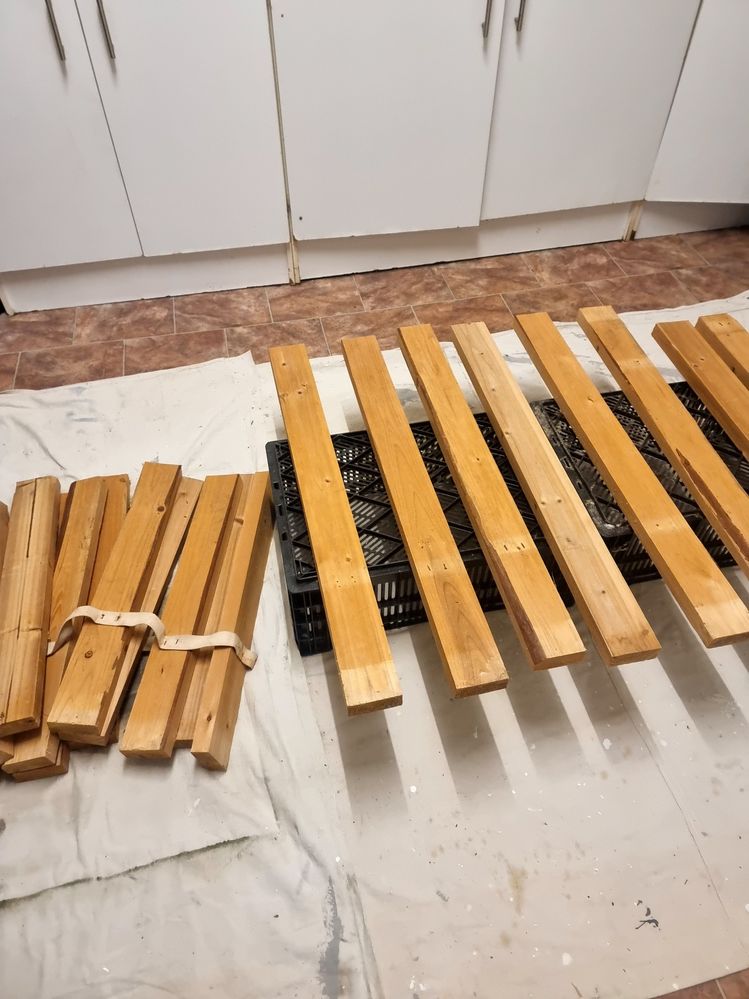

Second was to cut all the timber. I started with 11 pieces of two inch by four inch timbers that were five foot two inches long and had some left overs. I cut these in two so that one side was three feet and the other was two feet two inches.
I then cut two of the three foot pieces into two and a half feet for the end pieces.
I kept all the two feet two inch pieces for the base.
I used six by three feet long pieces for the sides and base bracing.
Step 3

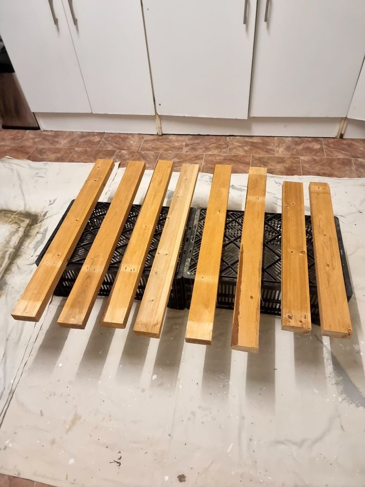

I then gave everything a light sand and and then a varnish.

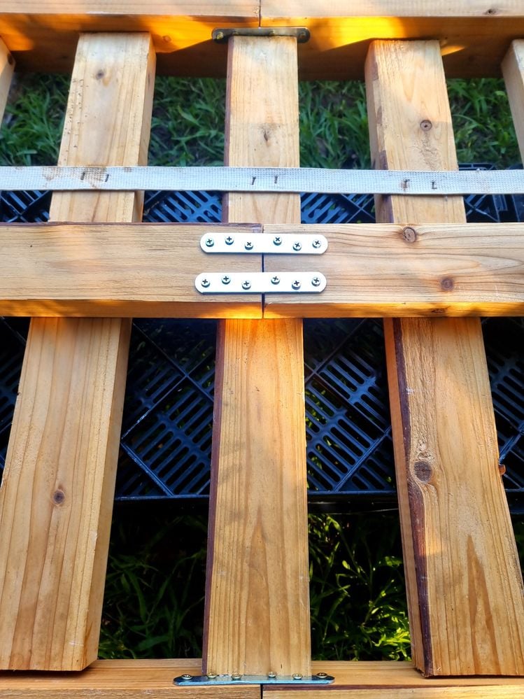

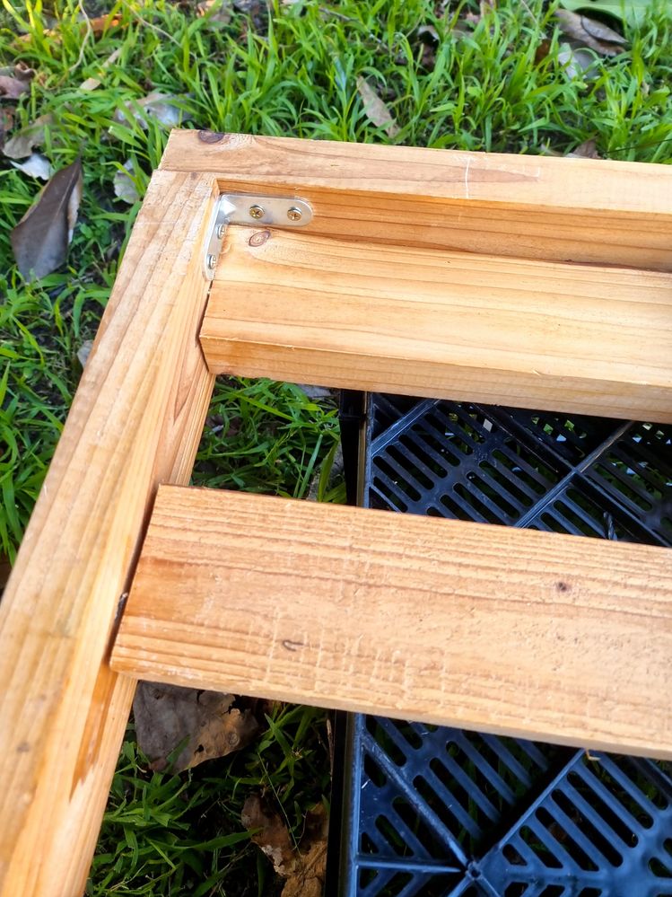

I screwed all the timber together, including screwing the angle brackets in the corners, and the mending plates on the underside. I screwed the square eye plates to the end.

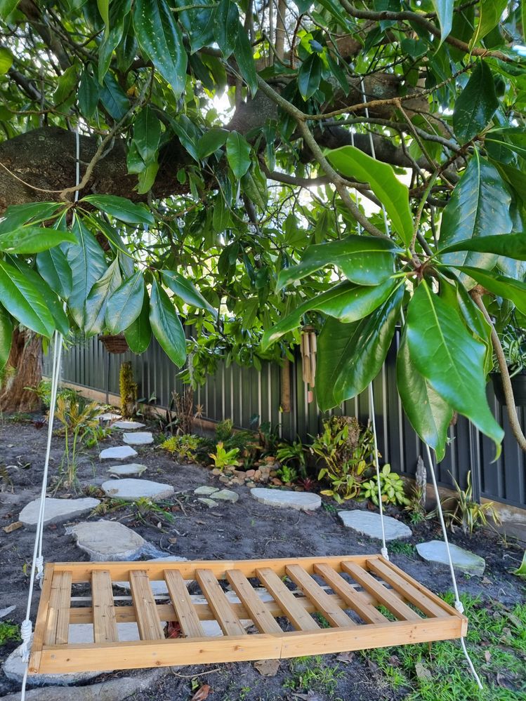

I tied the rope through the eye plates, making sure I kept the daybed level.
Step 5
I hung the rope from the tree and braced the daybed under the tree off the ground.

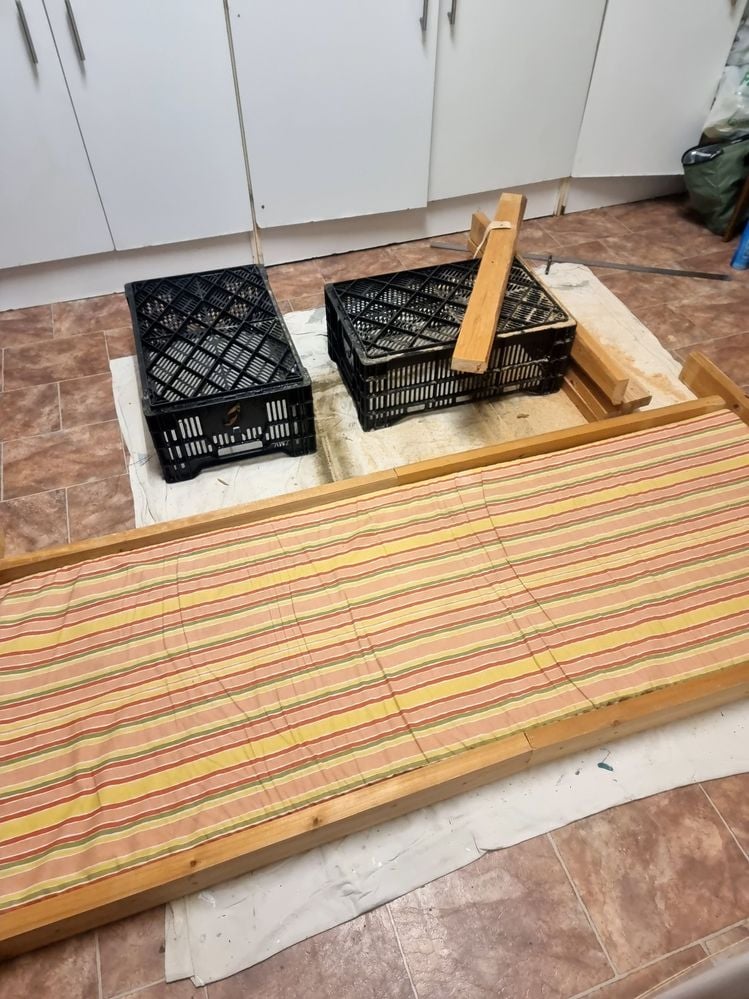

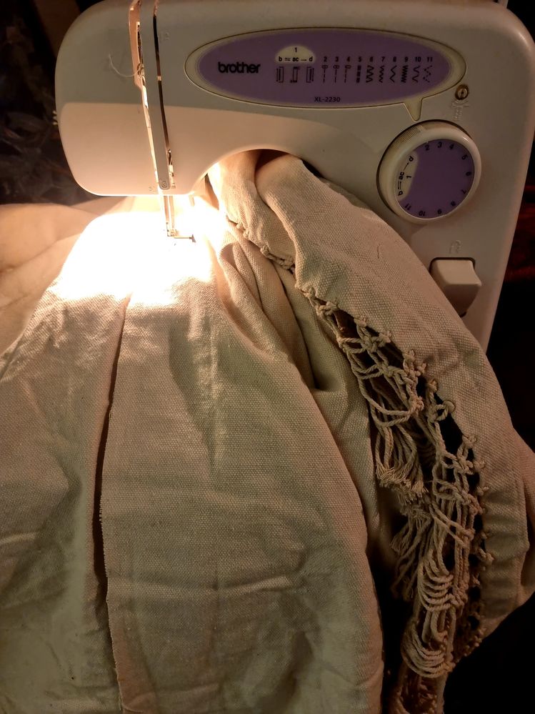

Next step was to measure and cut the hammock into pieces, and sew them back together to make a cover for the old camp mattress.

Final step: sit back and relax.
