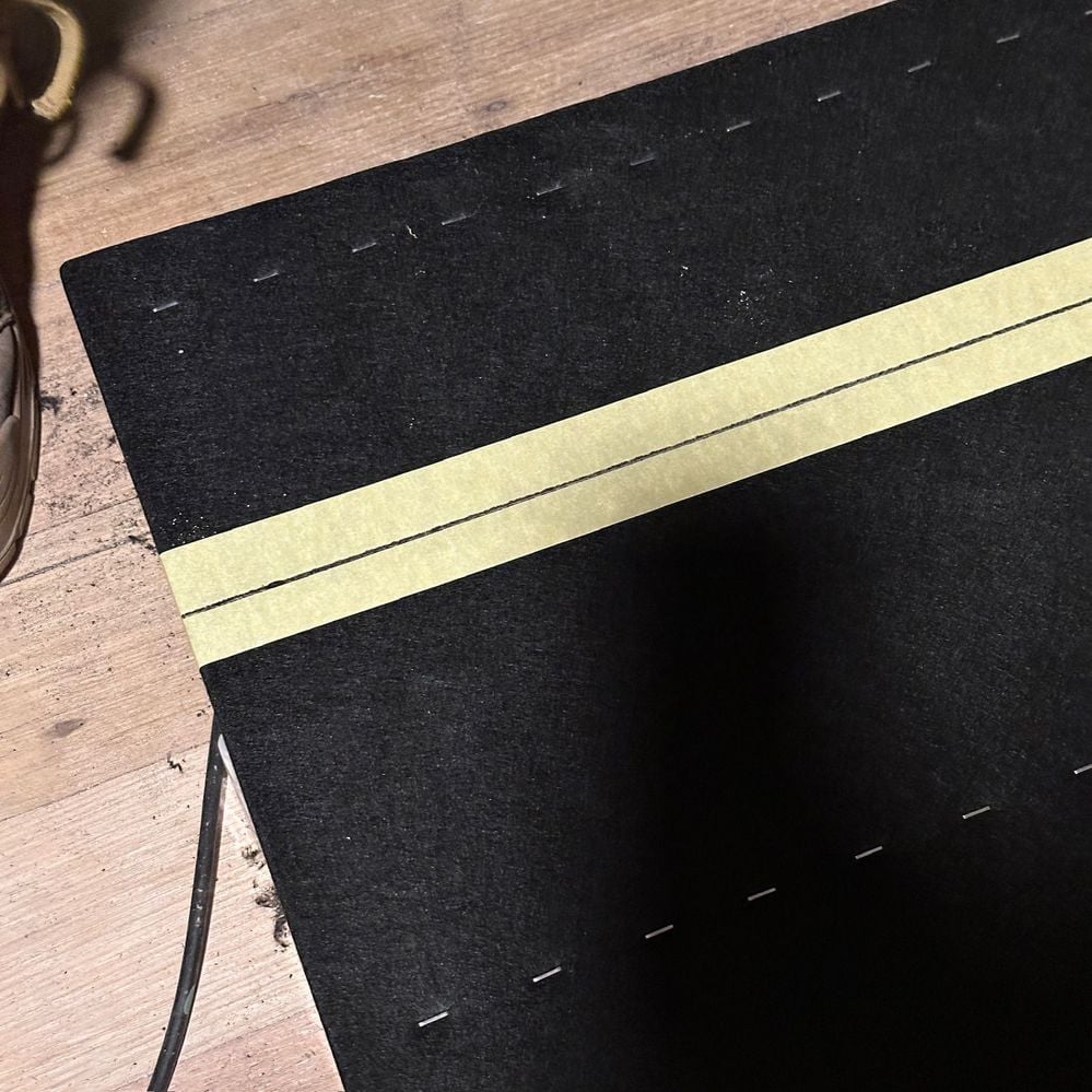

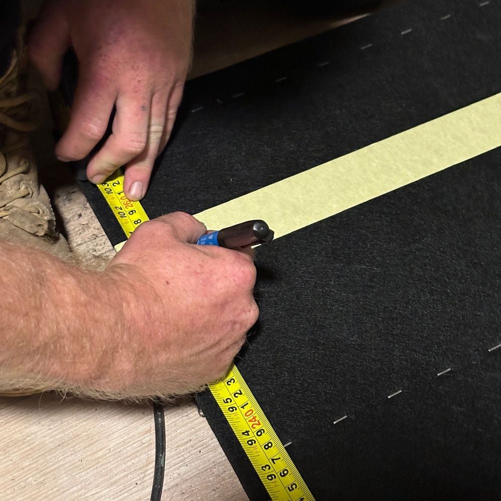

Depending on the length of your walls, you may need to cut the panels down. Tips: Work from the back of the panels, not the front. And use masking tape! This helps with marking as well as holding the felt when cutting with a circular saw.
Step 2
Once measured and marked up, cut slowly with a circular saw.
Tip: There is quite a bit of flex in the panels so you will want a flat surface to cut on or someone to hold the panel.
