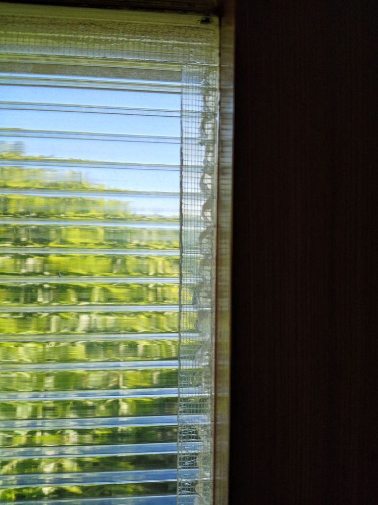

I have successfully used double walled polycarbonate sheets on the outside of windows as a cheap/light alternative to double glazing.
I sealed the cut ends with clear silicone to trap the air inside & then attached them directly to the glass with more clear silicone just around the outside edge. The view is a bit obscured, but light still gets through & the glass inside doesn't get as cold as it used to, so no condensation.

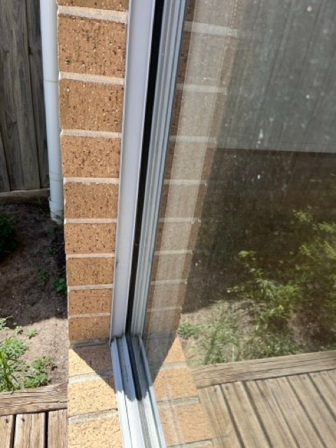

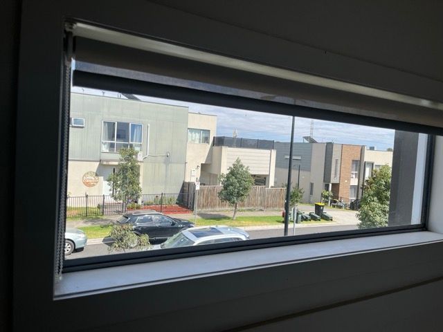

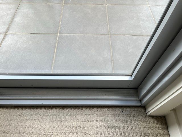

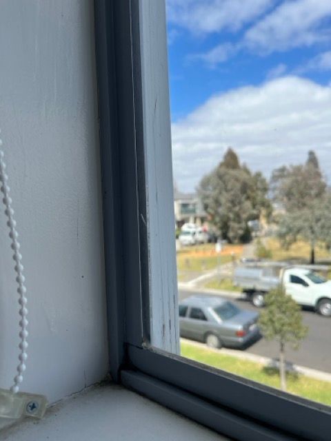

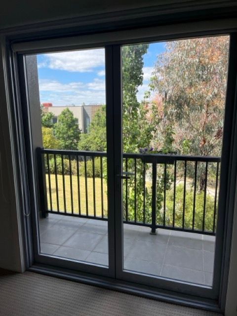

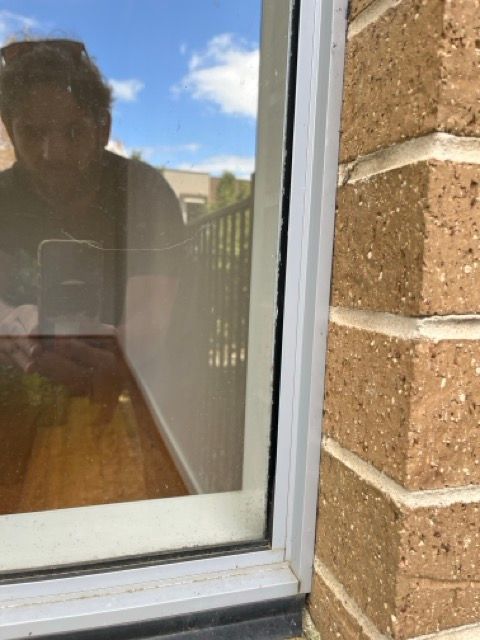

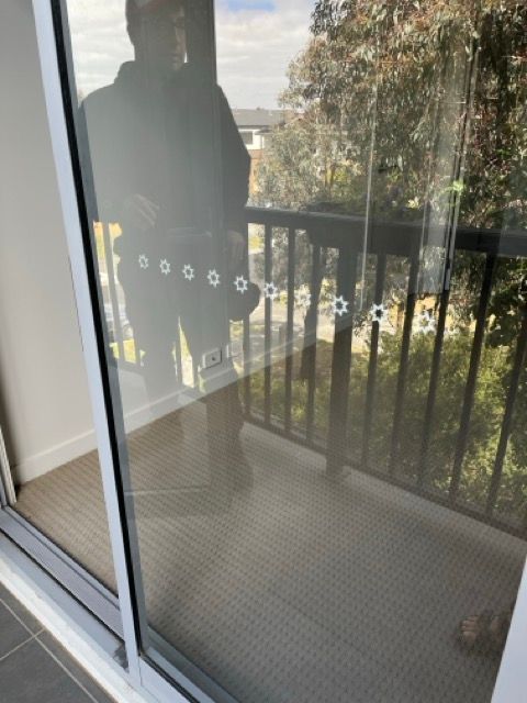

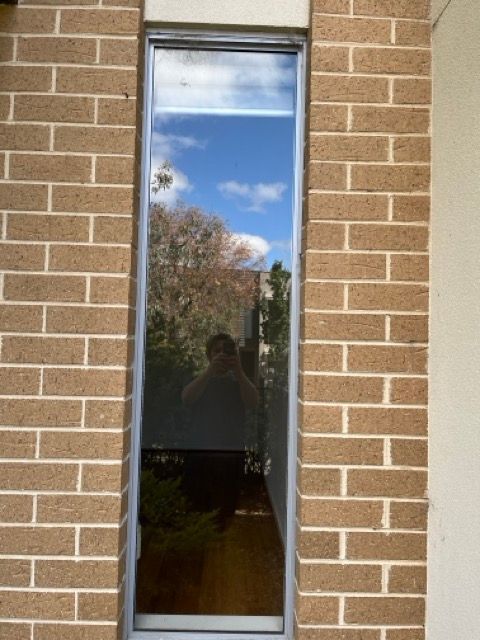

Hello @fadetoblack
Thanks for sharing your question about double glazing your window. Would it be possible for you to post a few photos of your window frame both inside and outside. This will give our members a better idea of its construction and configuration. We can then make recommendations on how to mount the polycarbonate sheet to your window frame.

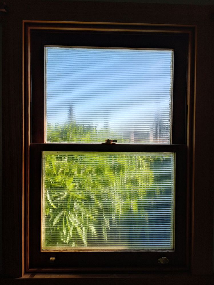

Thanks Eric.I just uploaded some images.
Thanks Richard, would it be possible for you to send a photo of this job. Cheers,

Initially I attached the double walled polycarbonate panels to the outside of the glass with double-sided tape. That worked fine for a couple of years, but the window is North-facing, the UV got to the tape & one panel fell off, so knowing it worked, I bit the bullet & then attached it with silicone. Obviously you can see the silicone from the inside so a small, consistent bead is best.
My window is in a bathroom, so the partly obscured view in/out isn't a bad thing. I wouldn't use it across a nice view. I think it works best horizontally, not vertically. If vertical, the warm air would gather at the top of the tubes whilst the bottom would get cold. Horizontally prevents this from happening.

Thanks so much Richard.May I ask why you used the corrugated polycarbonate instead of the flat version which is closer to a window pane?
Thank you for posting those extra pictures. It looks like @RichardC used Suntuf Sunlite 8mm x 610mm x 3.0m Clear Twinwall Polycarbonate Roofing and at certain angles it does look like corrugated polycarbonate. But let's wait for Richard's confirmation on what product they used.
In regards to your own project, using the twin wall would be a much better option as it is light weight, easy to cut and install when compared to Perspex. If you are not bothered with the reduction of visibility, installing the twin wall on either the inside or outside should not be an issue.
My best advice is to make sure that the twin wall polycarbonate does not get in the way of the operation of the window. I strongly advise testing it first just to be sure.

You're right Eric, I used the Sunfuf clear twin wall polycarbonate, not corrugated.
As we know, trapped air is a pretty good insulator so by sealing off the cut ends I trapped air in each tube so that is what makes it work.
