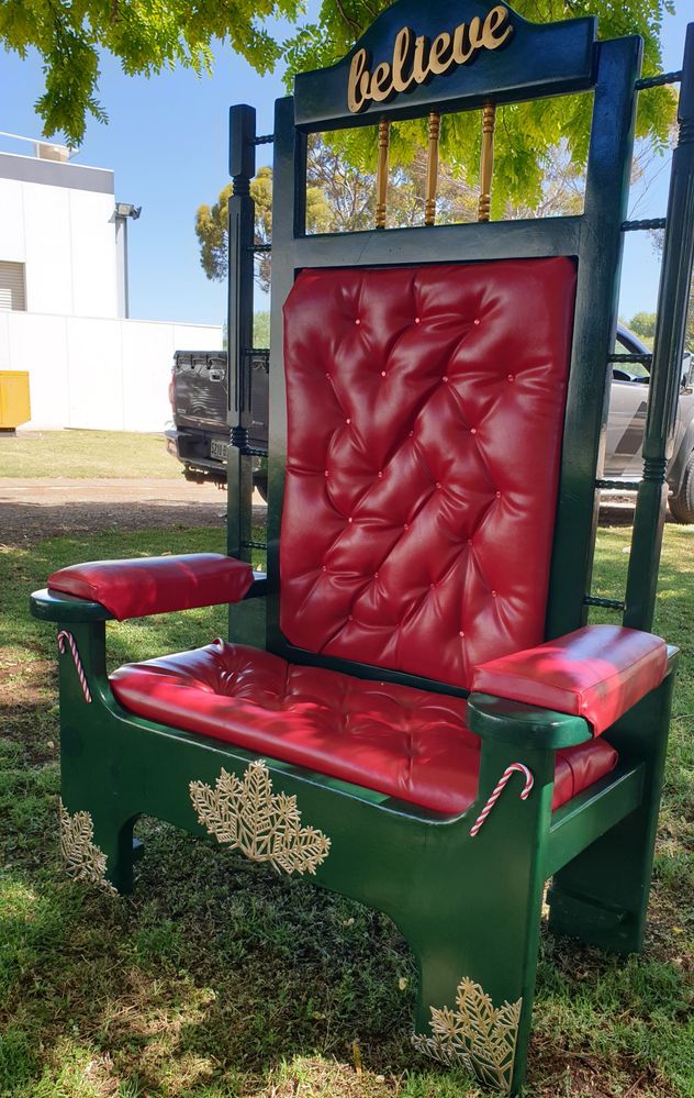

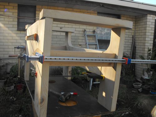

In 2011, I built this lovely Santa throne from plans bought from the USA. The majority of the timber came from Bunnings Parafield. Since then it has stood me in good stead over successive Christmas events (this is my 21st year as a Santa and yes, I have been Santa for many of Bunnings SA Stores).
The throne ready for use.

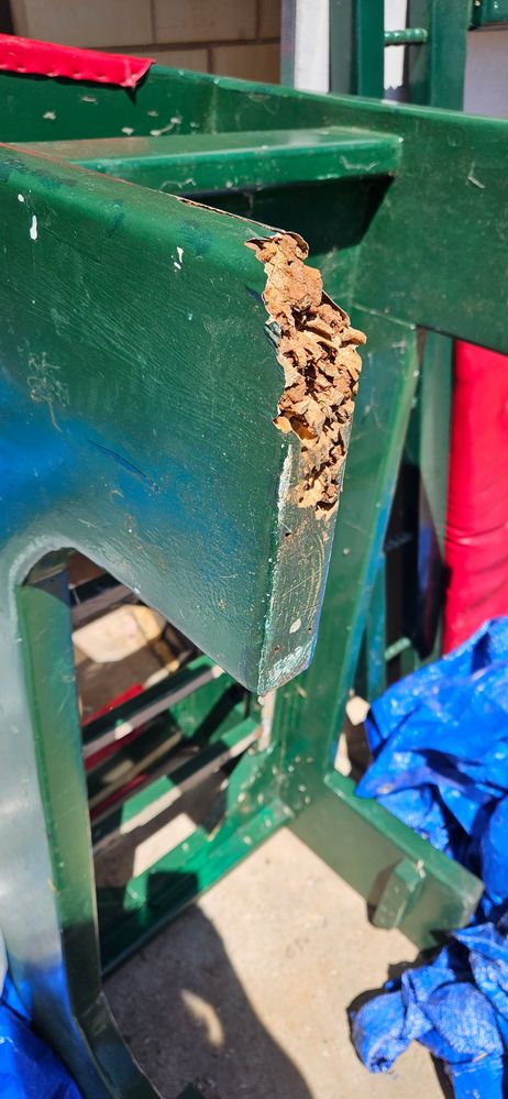

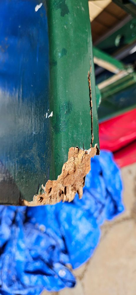

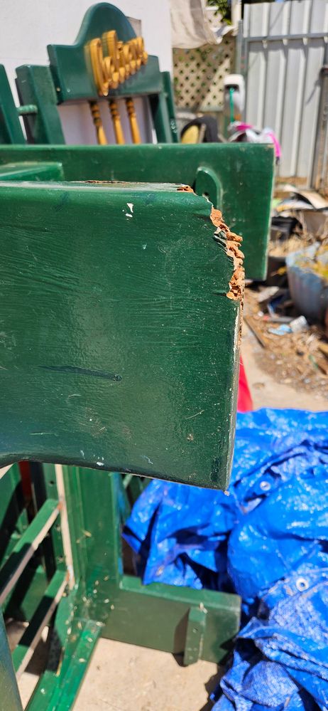

Last year I found that white ants had worked their way up a crack in my shed floor and attacked the nearest leg they could find. I killed them off with poison spray but now I need to do a makeover to clean up the mess and get it ready for use over the next few weeks.
the front right leg
the front right leg
the front right leg
the front right leg
The first step - I think - is to take a 45-degree cut to remove as much as I can of the damage at the same time retaining maximum strength because I have some pretty hefty folks sitting on it at times.
It has been suggested that I then putty it to fill any remaining holes and possibly put a curve on the edge to make it look better.
Then it is time for the Paint shop to get Brunswick Green enamel to put 2 coats on the whole surface area. I will have to cut back the surface with my sander, advice on grit please.
Your suggestions are welcomed.
