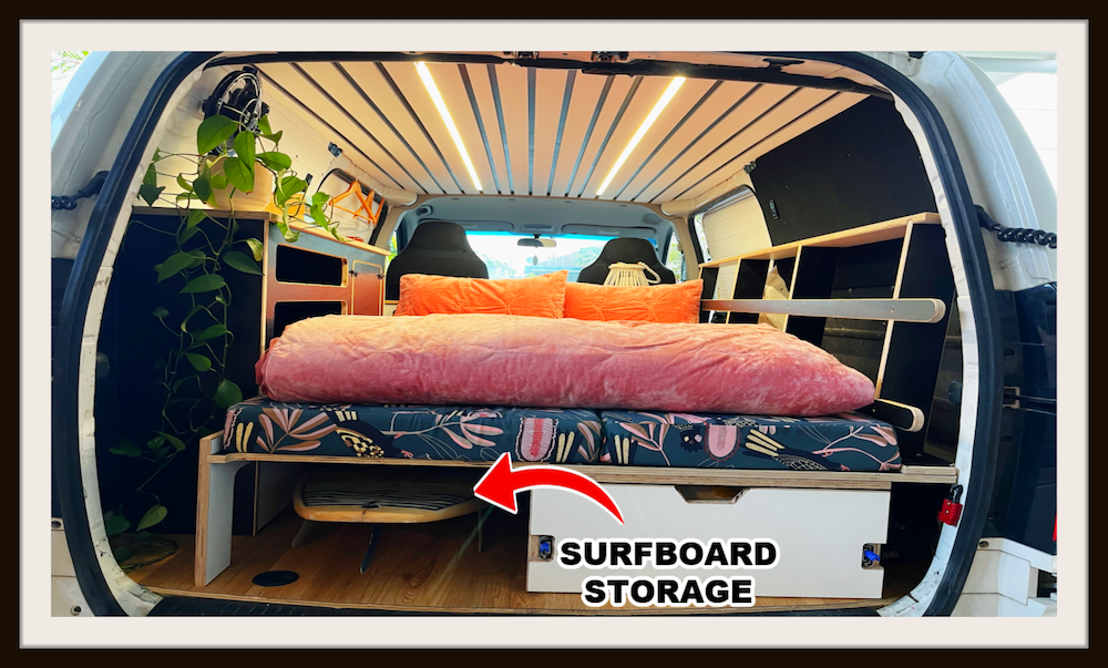

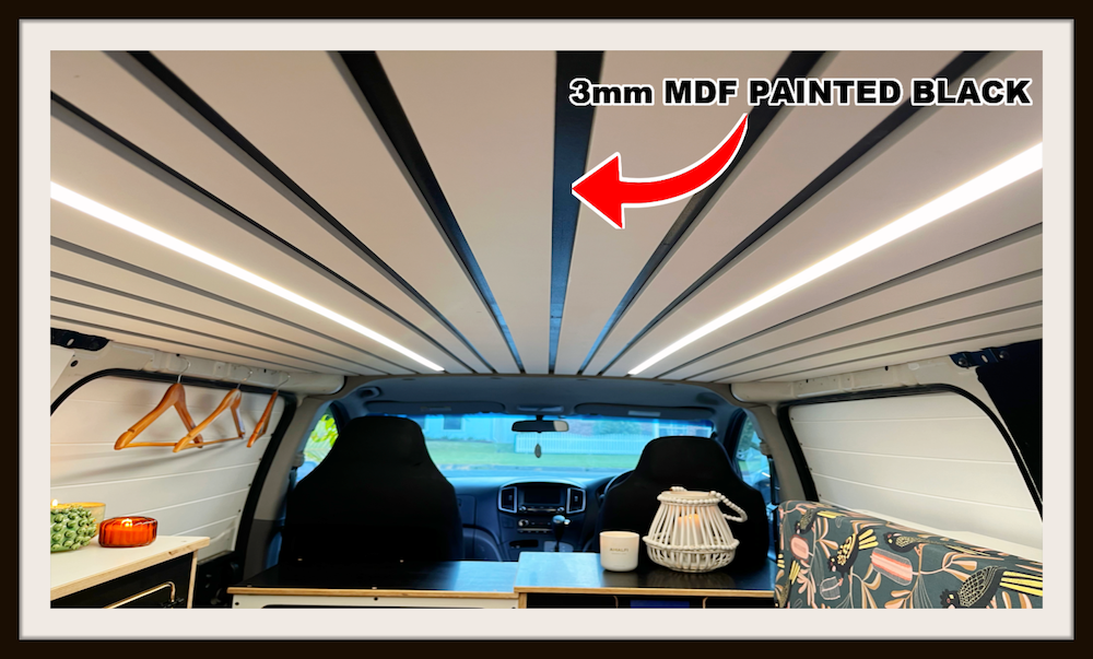

The LED lights are one of the features of the van which helps to highlight the slatted ceiling.

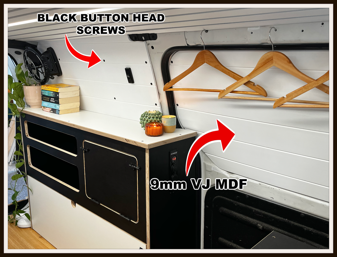

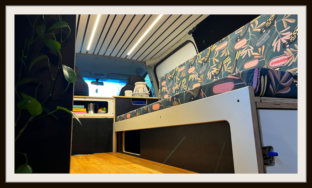

Plenty of storage in the wall cabinet and the natural holes in the vans side panel make a convenient place to hang some clothes hangers.

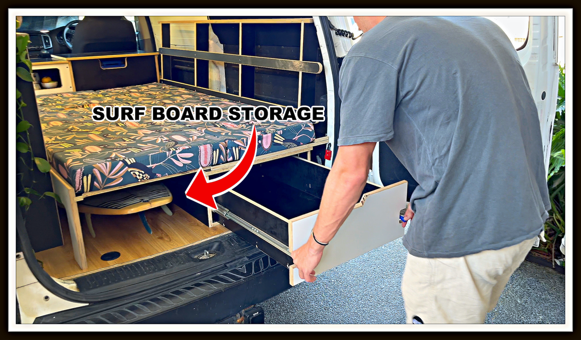

Surfboard storage under the bed stores the boards safely while you sleep overnight.

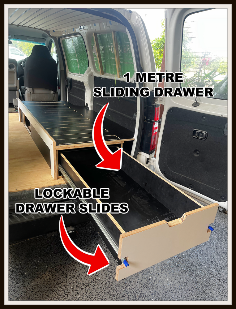

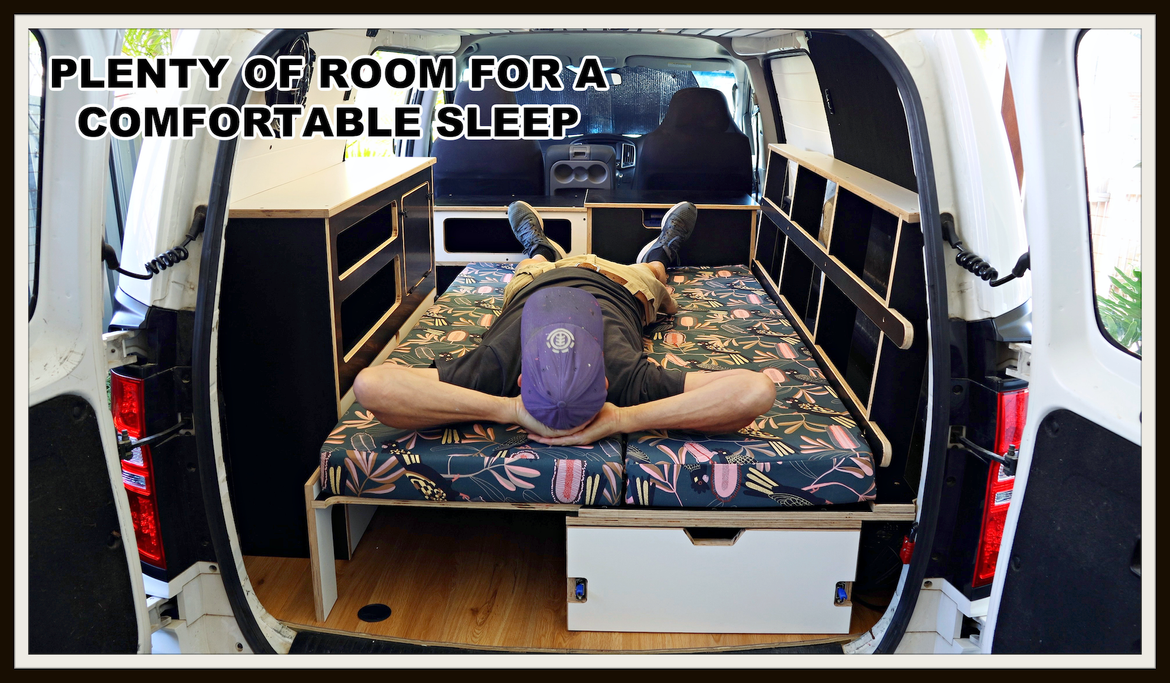

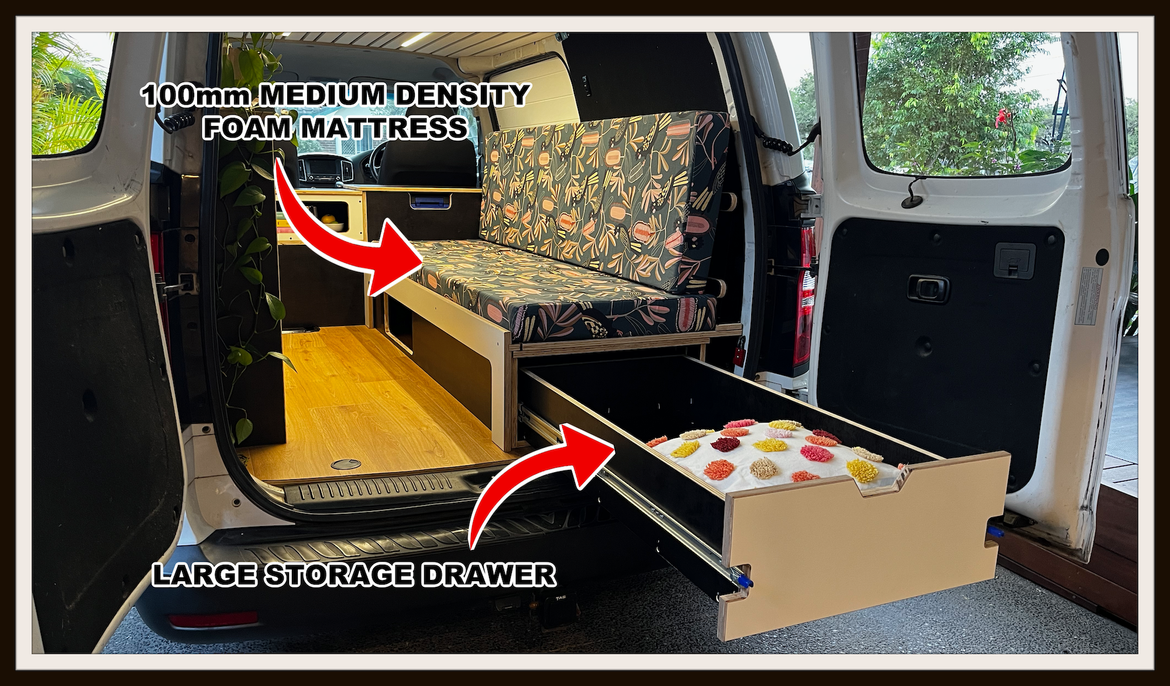

Plenty of storage with a one metre pull out drawer and the sofa bed is very comfortable with a two-piece foam mattress.

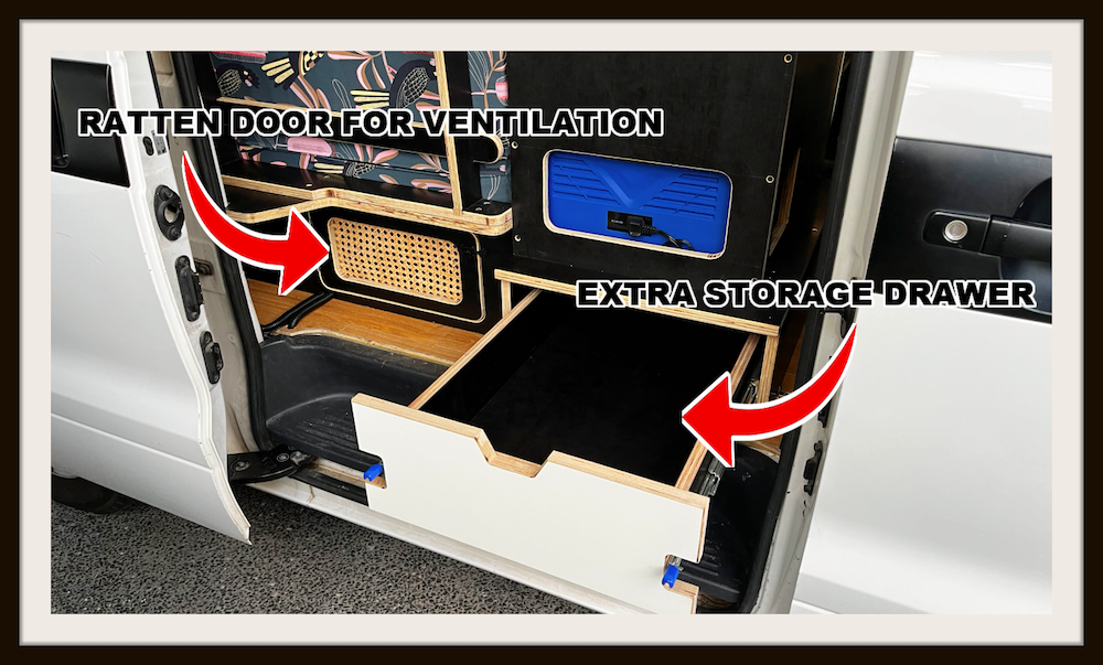

The rattan door on the electrical box ensures plenty of ventilation for the electrics whilst the extra drawer provides another handy storage compartment.

The VJ was a little difficult to install due to the uneven and curved face of the wall and door panels. A little force was required to secure it in place and just make sure that you screw to a panel that is not the outside skin of the van. Check twice, screw once. The black button head screws are nice accent against the white MDF.
The white plywood legs are cut out of the one piece of material - no joints!
I'm 6'2" and can sleep comfortably with legs outstretched.

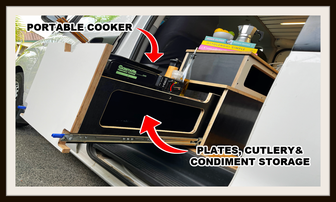

Handy pull-out kitchen with open storage underneath.

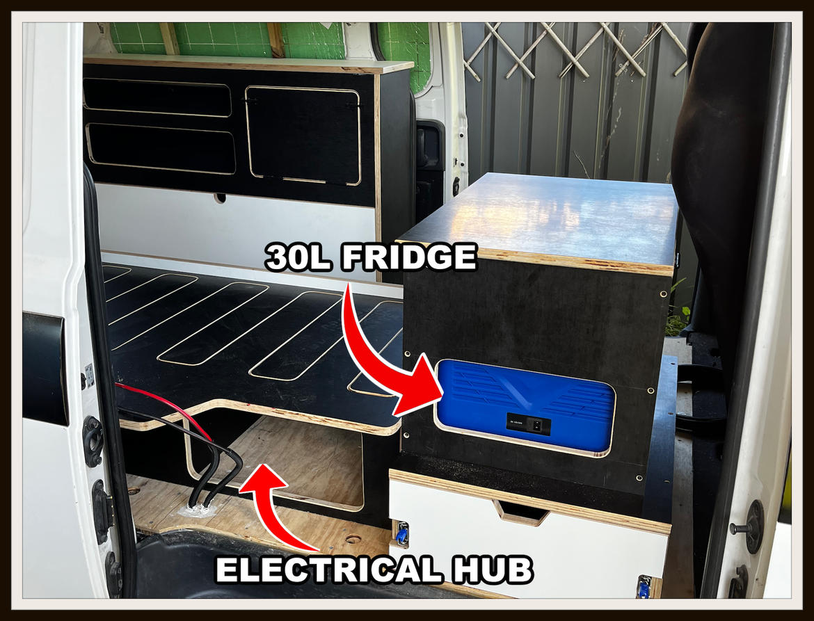

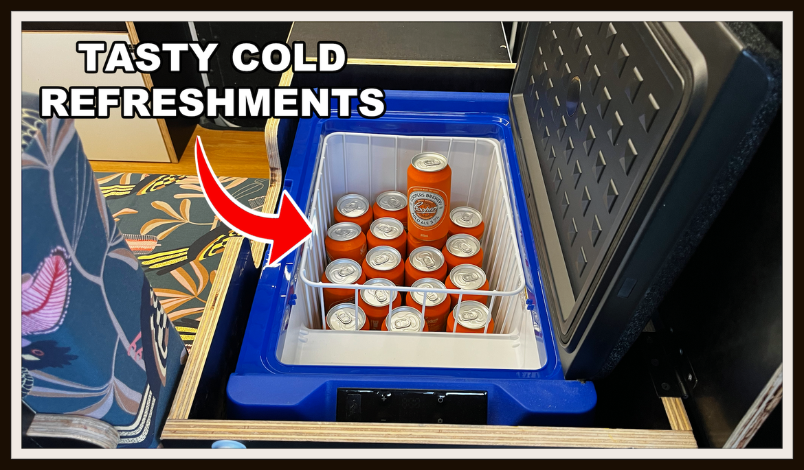

The 30-litre fridge is a great option.

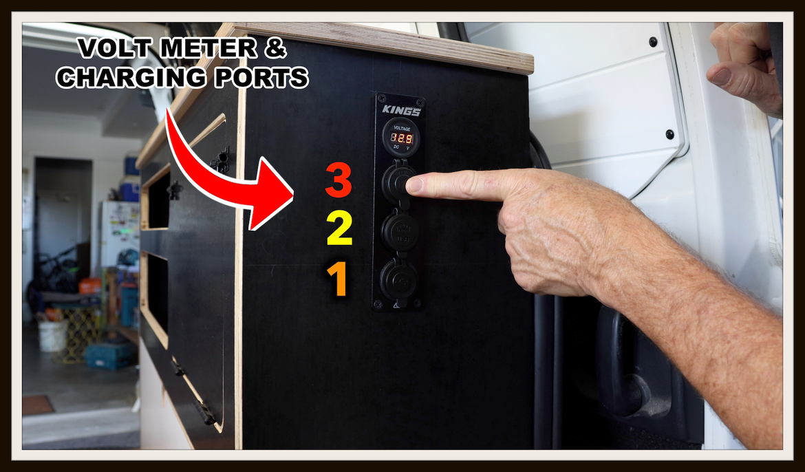

Three styles of charging ports:
- One USB port and one USB-C port
- One automobile auxiliary power outlet.

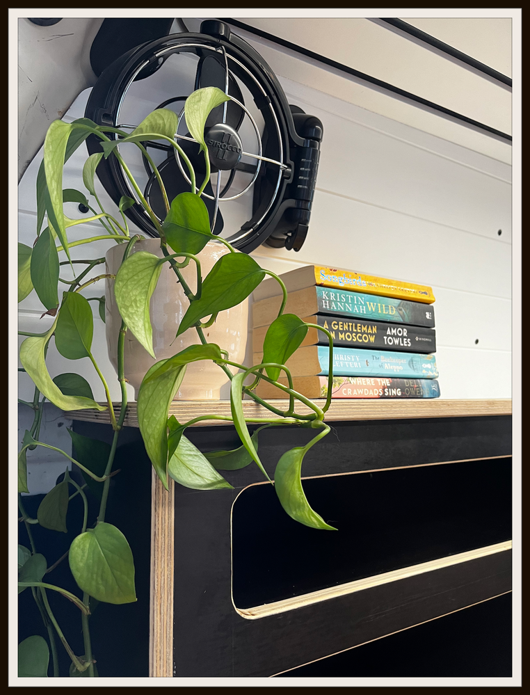

The wall mounted fan is a necessity for a comfortable van life.
The LED strips are a simple way to create a stunning look.

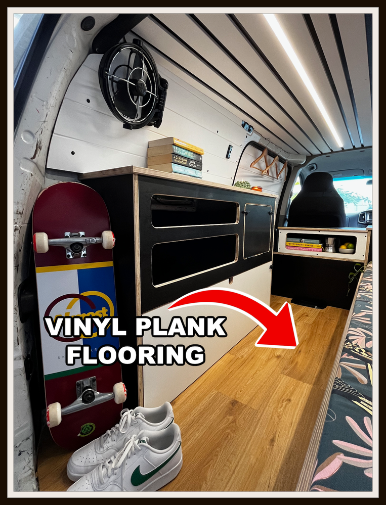

The vinyl plank flooring looks great and is simple to install.
The pull out sofa bed is a very effective way to kill two birds with the one stone.
The open storage is a great place to store your devices, clothing, books, etc.

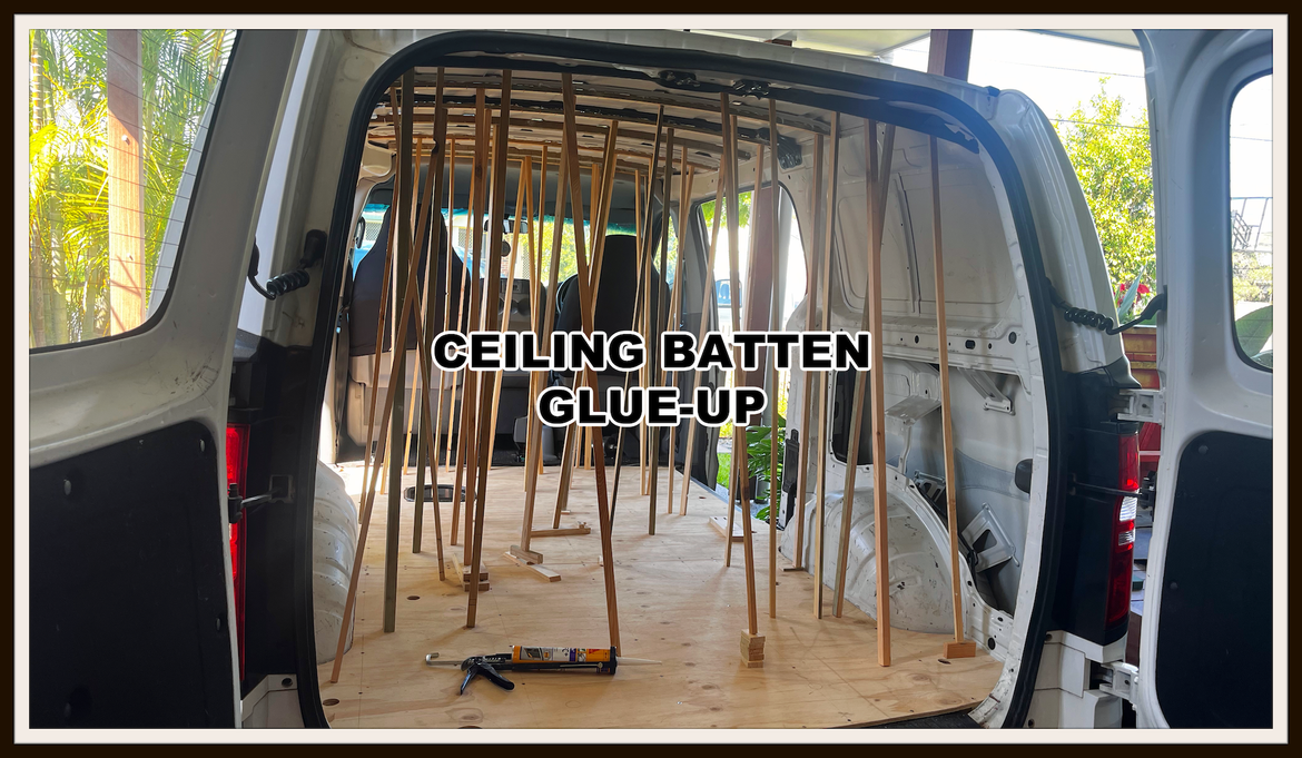

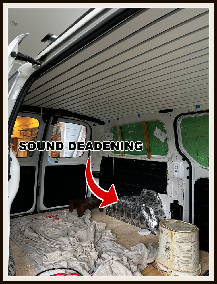

Holding up the ceiling battens till the glue dried.

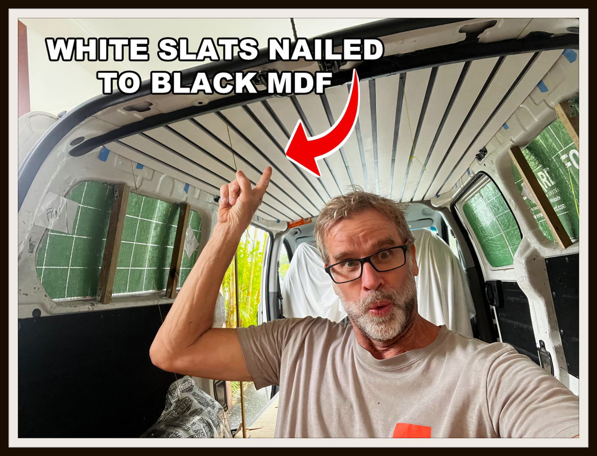

Timber slats nailed to a 3mm sheet of MDF that l painted black for accent.
Sound-deadening material was applied to the areas of the van that sounded 'tinny'. These tinny areas were on the wall and ceiling panels and also the wheel arches where road noise is transferred.
Insulating your van is an important step as they can get really hot in the summer and very cold in the winter.

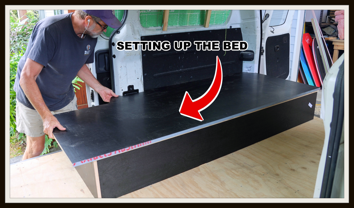

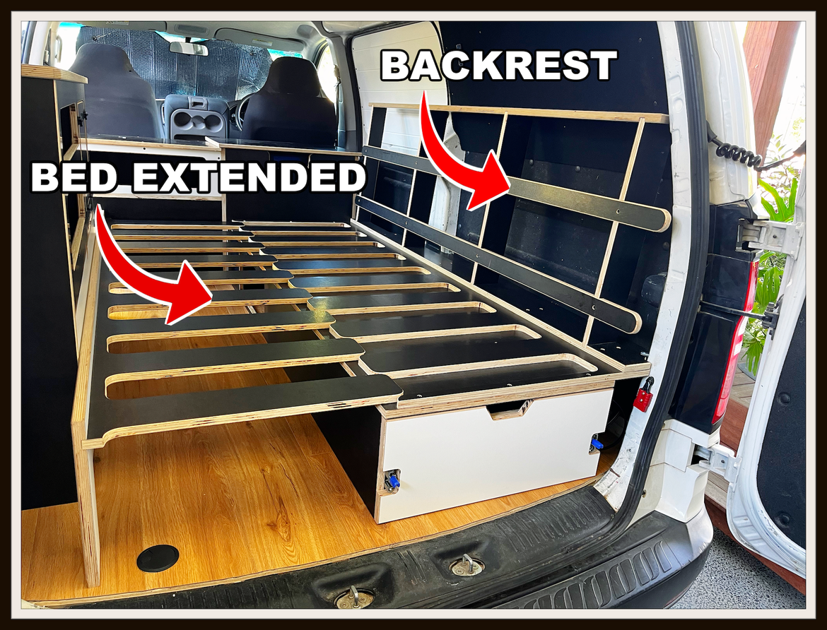

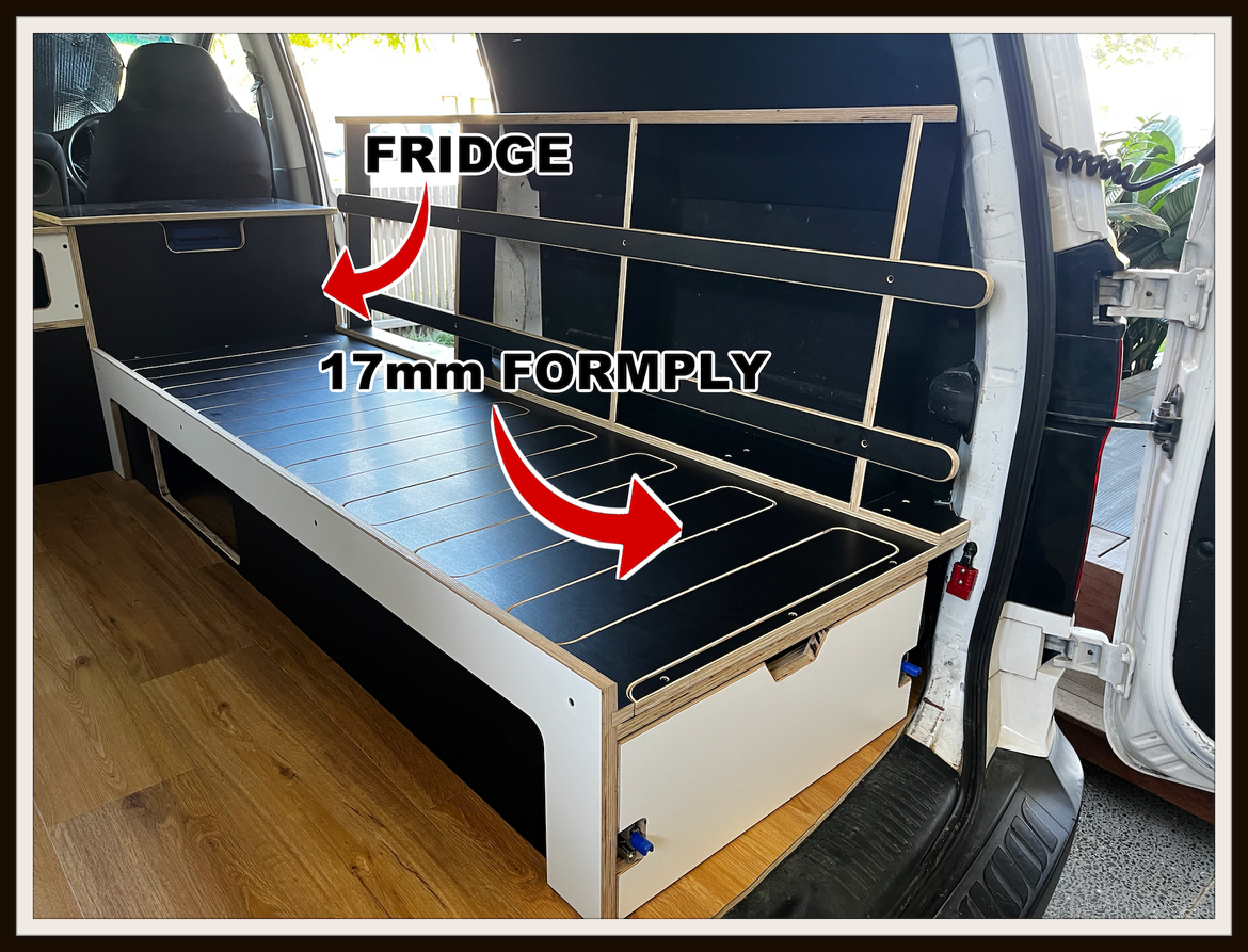

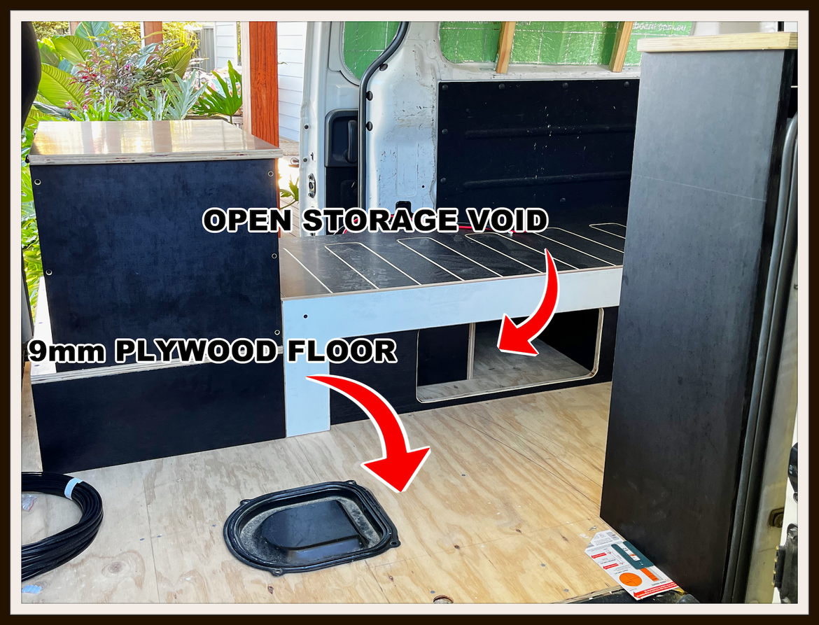

The bed box is an integral part of the build as everything else is built around it.

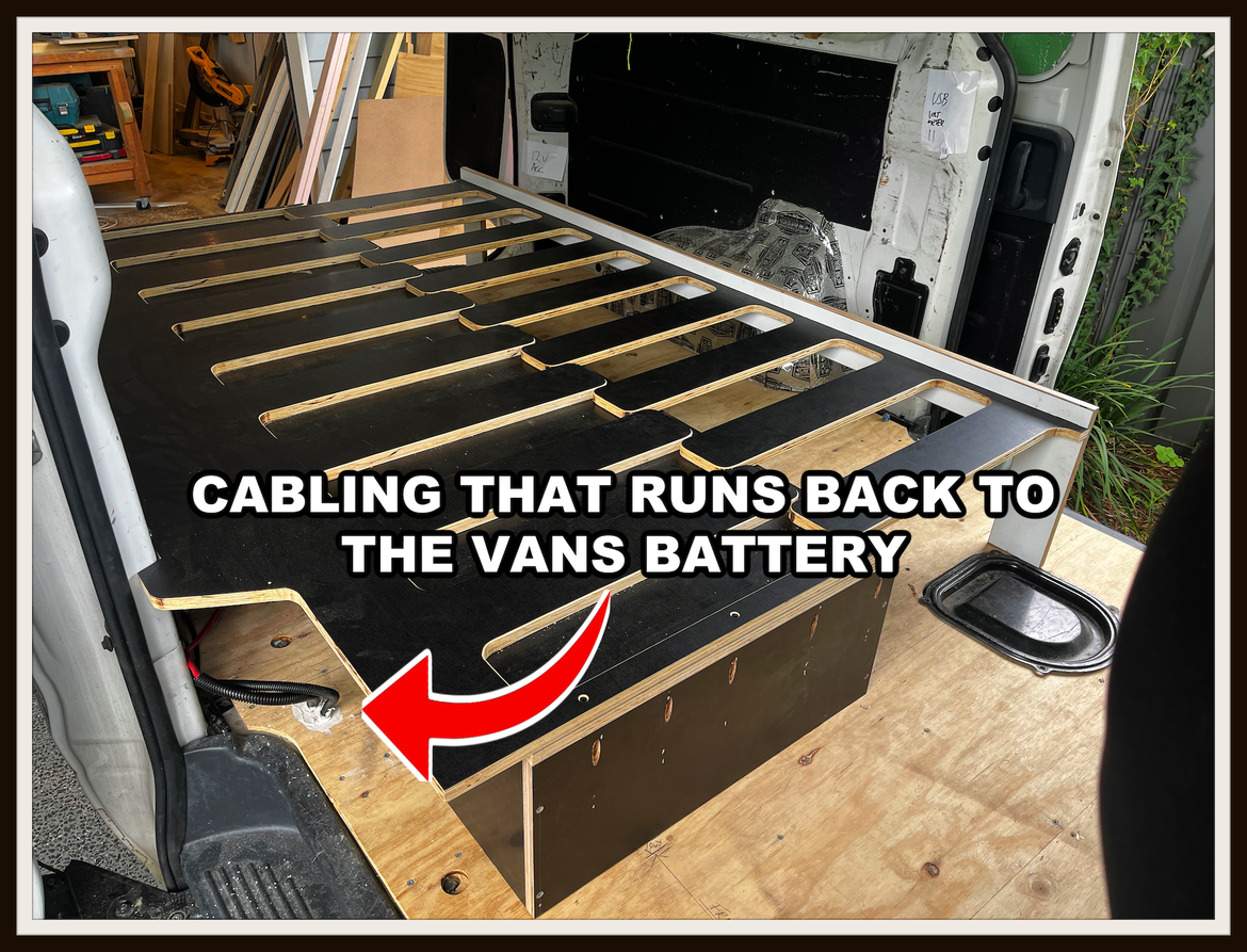

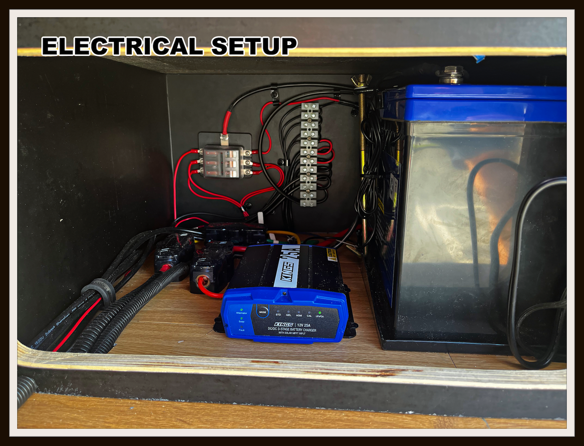

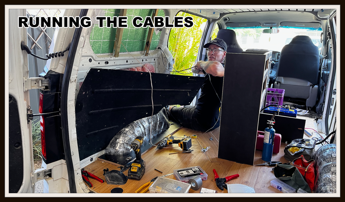

Running the cabling for the lights, switches, fan, charging ports etc.
The plywood floor was installed in two pieces. There are so many ins-and-outs with a van that it would be very difficult to do it out of one sheet.
I'm a massive fan of the 17mm Formply. It looks awesome and is generally straight and flat.
The cabling was a little tricky to run back to the battery but we got there in the end.

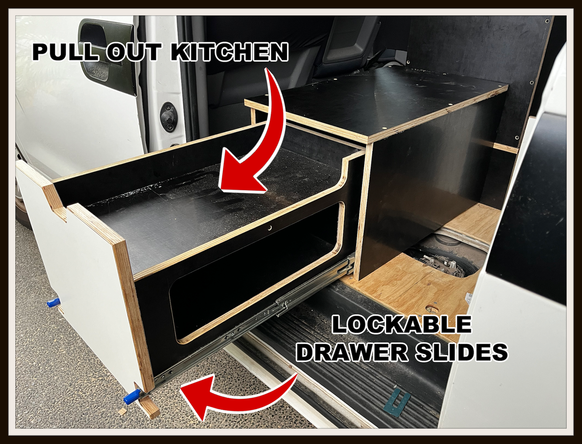

The pull-out kitchen works well as a place to use and store your gas cooker.

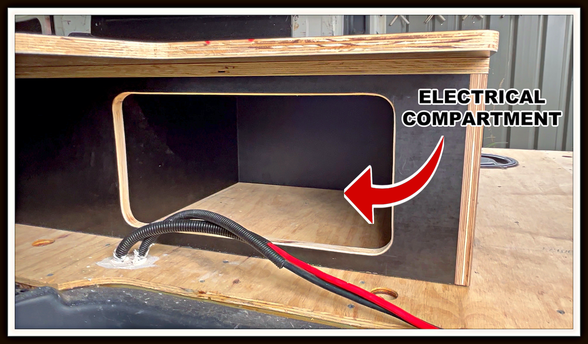

The engine room for all the electrics is located under the bed.
A 100AH Lithium battery runs all the electrics which is charged from the vans battery as well as the solar panel on the roof.
The backrest is a game changer for the pull out bed. You can sit in the van comfortably without your head hitting the ceiling.
Having the fridge and electrical compartment accessible via the side door is very convenient.
Hear duty drawer slides work an absolute treat with the drawer. Having the drawer lockable prevents it from coming out when driving.
