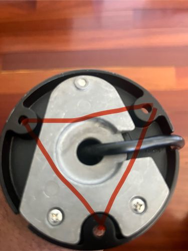

How do I screw a camera to cover the hole in the picture, the cable will be connected to the camera. What's the best way to go about it including required tools. Thank you picture

Had another look, the hole in plasterboard is about 4cm, the distance between the screws on the camera base is about 5cm. What's the best way to install it. Will need to screw in at least 2 of the holes
You should be aiming to utilise all three holes to ensure the camera is as secure as possible.
Try placing the camera against the soffit and marking the holes with a pencil. If you can then provide a photo of the opening, I'd be able to advise whether it will work or not.

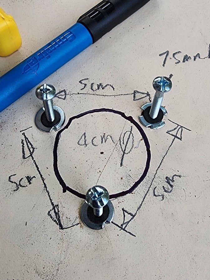

Playing outside while the wine chills - I managed (just) to install three M4 bolts with hollow anchors based on your dimensions .
Otherwise as per Jacob - apply a backing, then screw the mount onto it.
My pilot holes are 7.5 mm - but I reckon 7mm would suffice with these fasteners.

It looks like this roughly - picture which is not far off from @Noyade's sketch

That appears to be eave lining sheets, which are 4.5mm thick. Expanding toggles are suitable for fixing to it or you can use Ramset 5mm Hollow Wall Anchors.
