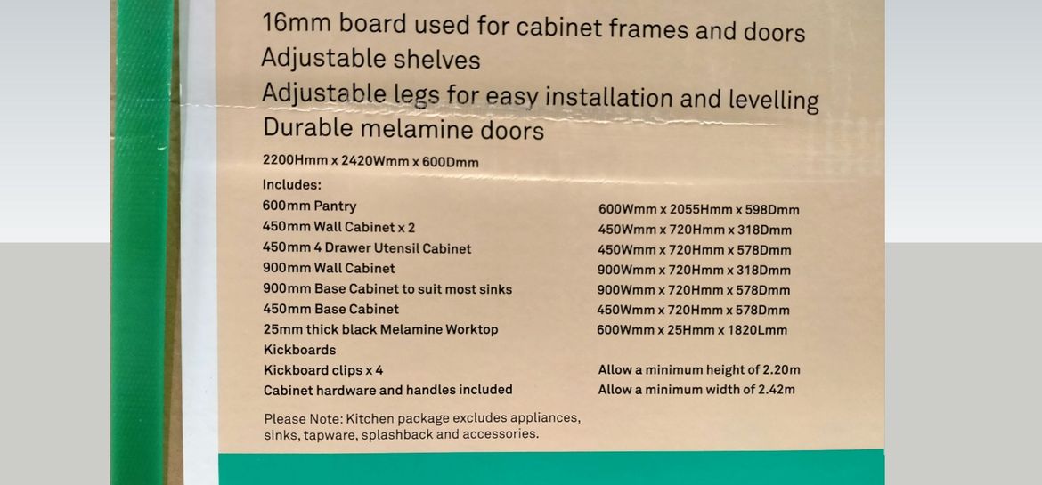

Hi...Does anyone have the individual cabinet/pantry sizes please for the individual cupboards/cabinets/pantry?
Just wondering if they will fit into our space without too much hassle.
Thanks
Hello @Butler1
Welcome to the Bunnings Workshop community. It's wonderful to have you join us and thanks for sharing your question about the Practa straight line modular kitchen flat pack.
I suggest having a quick look at this discussion - Re: Practa Straight Line Modular kitchen dimensions wanted by @Sue3875. There is a picture in the discussion with all the cabinet dimensions included. I also suggest looking at the Kaboodle cabinetry set, there is more variety in sizes and the cabinets are more robust.
If you have the measurements of your kitchen area, please share it with us. I would be more than happy to do a quick layout in the Kaboodle kitchen cabinetry system if you are interested.
Perfect! Thank you Eric! Very helpful...
