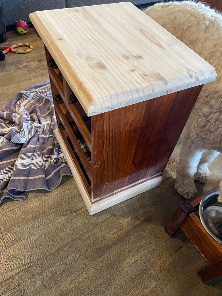

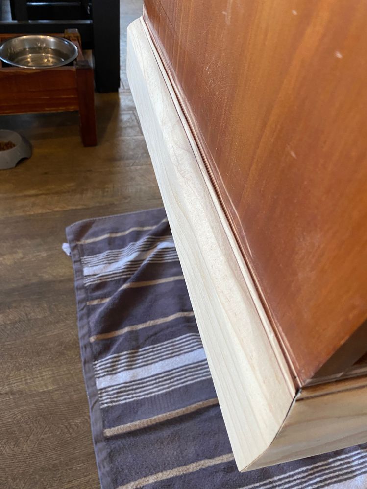

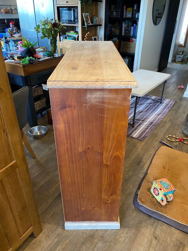

Firstly, we sanded back the areas we wanted to keep raw using a multitool sander and an orbital sander. We then painted an undercoat (Taubmans 3-in-1 prep) on the areas we painted. I forgot to take pics with the undercoat.
Sanding the areas we wanted to keep raw

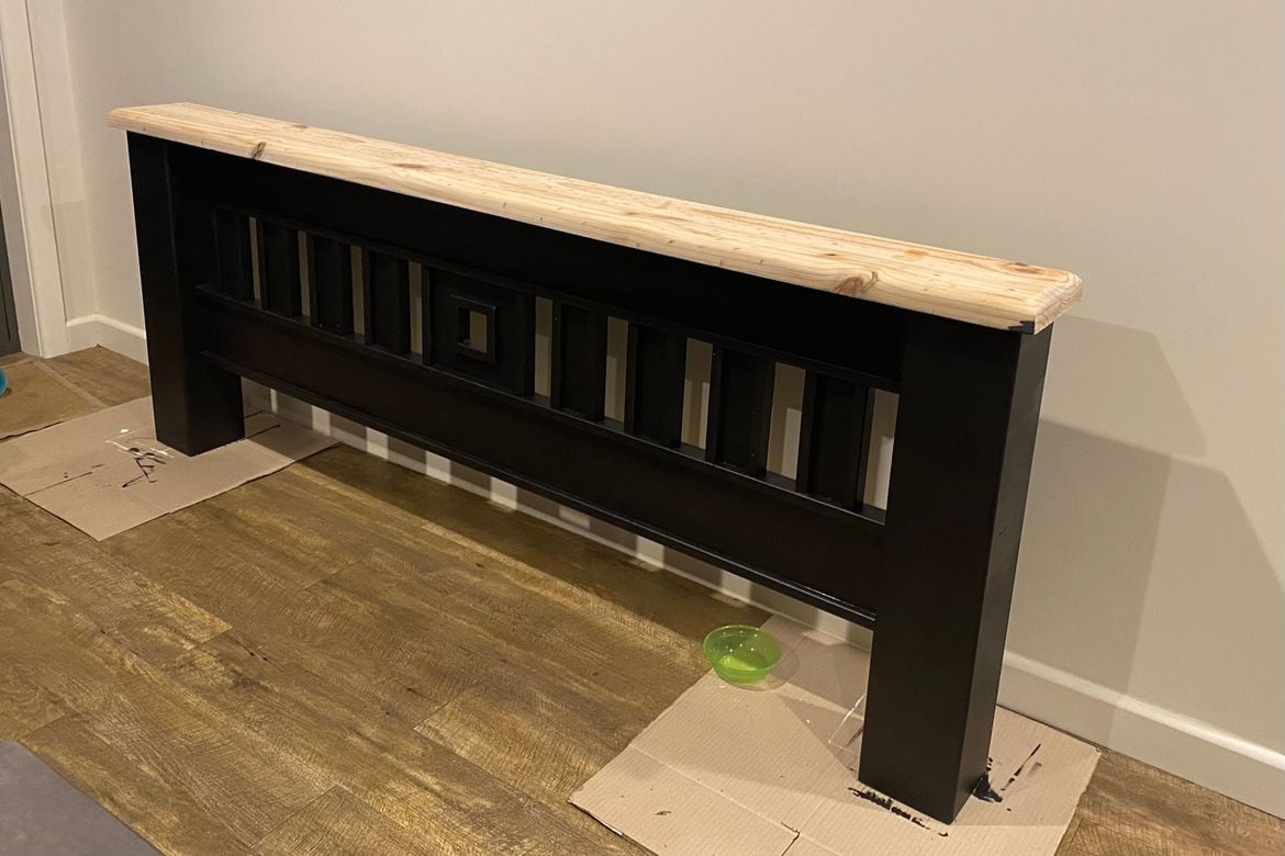

Starting to take shape, we have worked on the areas we wanted painted and then finished the raw timber off with a clear matt Cabots polyurethane.
painted but not yet clear coated

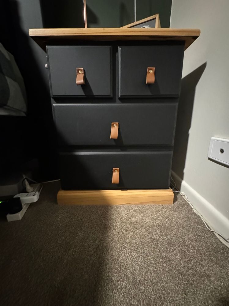

Step 3

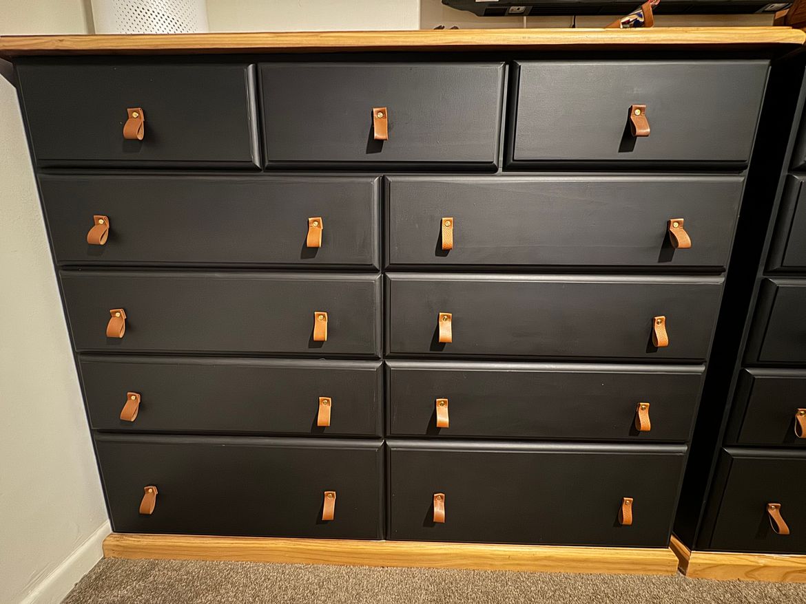

All finished and revamped! Very happy with this very quick and cost effective upcycle. Adding the leather handles has modernised these pieces very nicely.

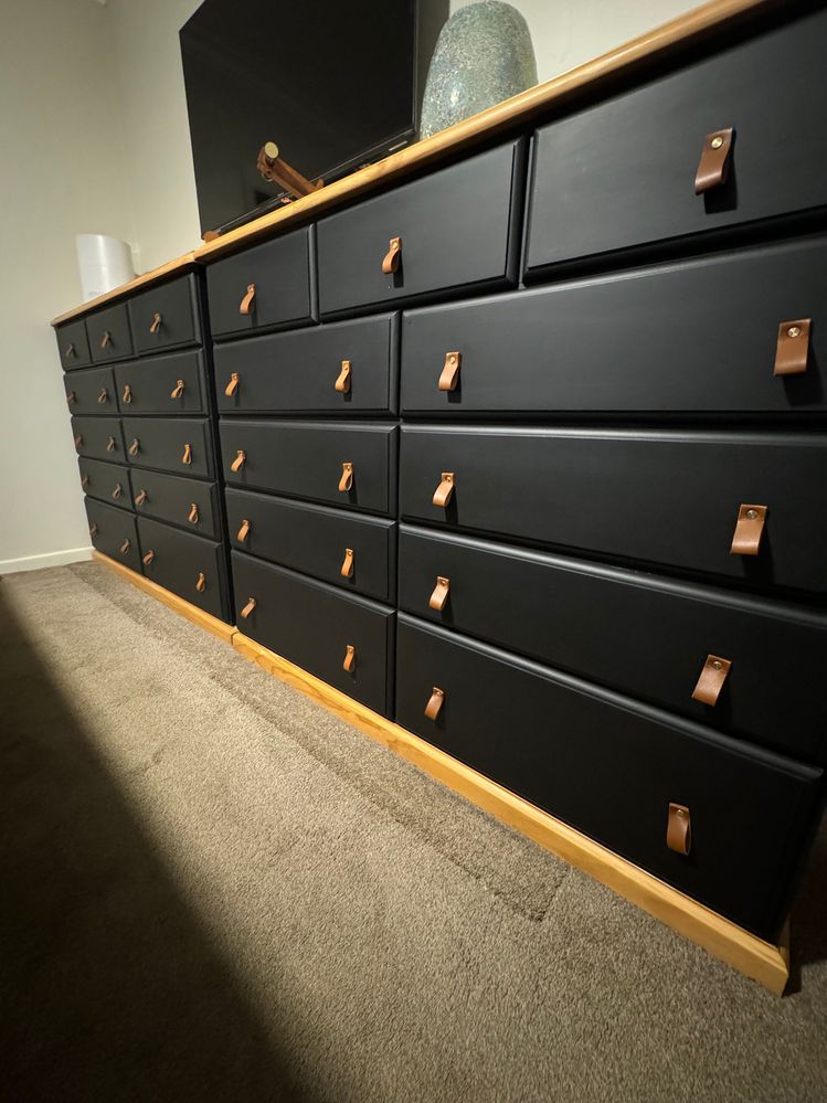

Putting our room back together. Funky fresh! We have also painted our bedroom wall in a stunning green called Pond Moss.
Putting our bedroom back together. Looking funky fresh!
