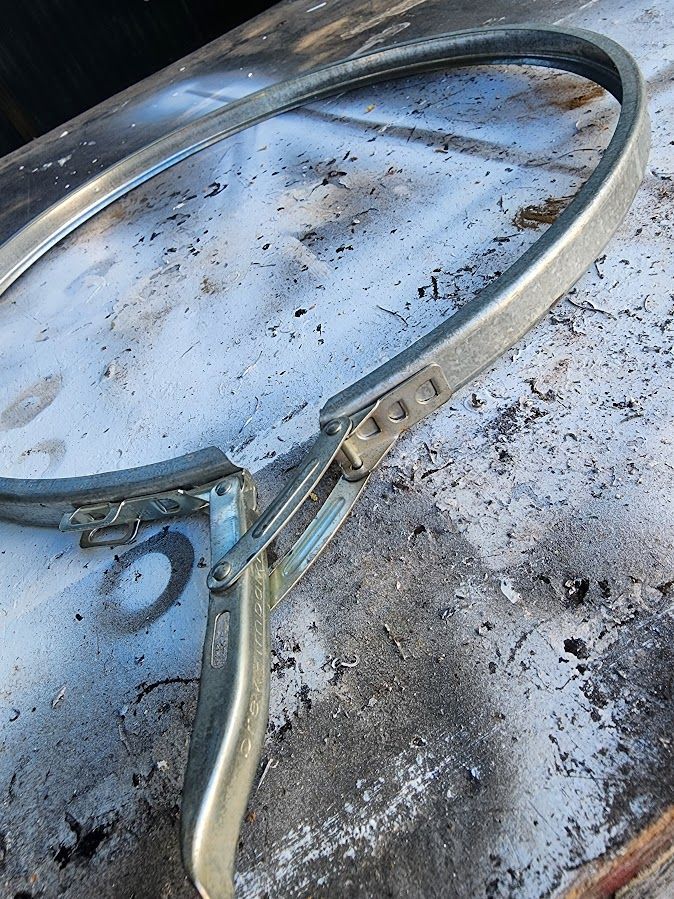

waterproofing tins with a hook lock on them, trick to remove lid once that hoop is off them

"hoop"
This maybe?
If it's the locking mechanism @Noyade has shown, I typically place a flat-head screwdriver blade on the container rim just under the lid edge. I then lower the screwdriver handle below the level of the lid and give the handle some tappity tap taps with a hammer in an upward direction. You might need to do this around the lid, but that's normally enough to dislodge it.
