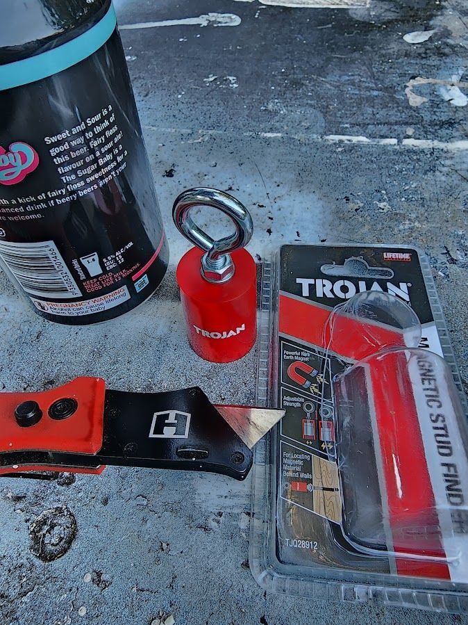

The Trojan Magnetic Stud Finder can be found inside the tool shop. Just ask the tool specialist when entering the tool shop and they will tell you the exact location. In regards to mounting your TV, I suggest having a quick look at this discussion - How to wall-mount a heavy 75-inch 40kg TV by @Sugar. The general method of mounting it is to use a timber support piece that goes across the wall studs to support the weight of the TV.

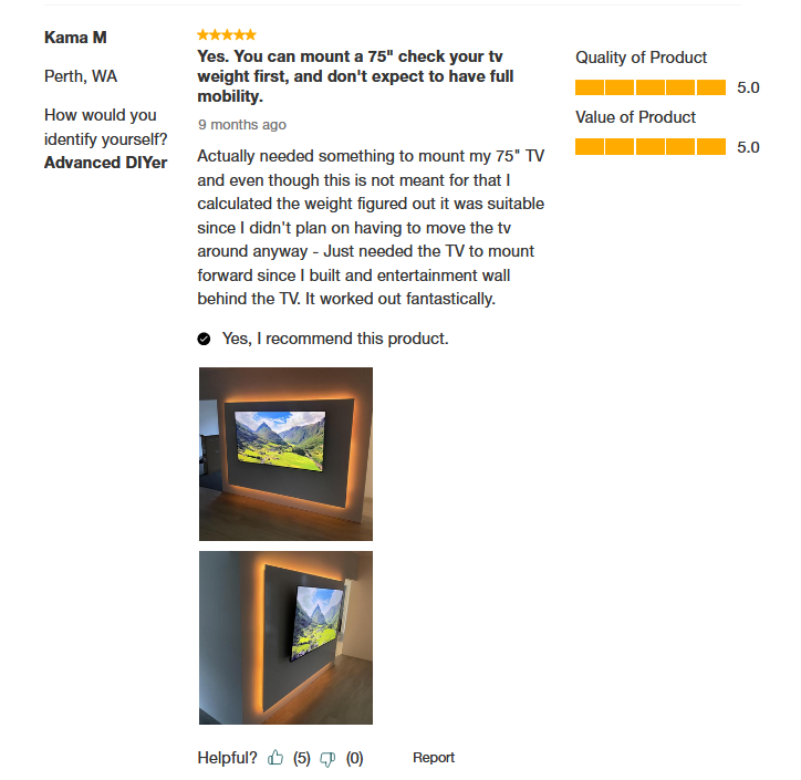

Looking at the specs - weight says yes - but no to the screen dimension.
But scrolling though the reviews, we find Kama M. However, they are not extending (435mm) the screen from the wall.
The negative reviews all appear to be about it not being designed around 600mm stud spacing.
That can be solved.
Cheers.

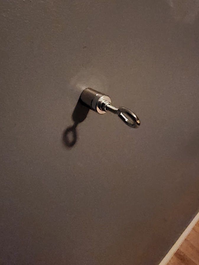

I too have an old house, in some rooms I have a layer of fibro with two covering layers of gyprock. The electronic stud-finders I've tried are useless.
But I have had 100% success in locating screws/nails in the studs with rare earth magnets and measuring the 600mm once located. Sometimes there is a screw/nail located at every 600mm distance.

https://www.bunnings.com.au/trojan-magnetic-stud-finder_p0673723

There are also these Deta Powerful Magnet, which are usually found in the electrical section.
