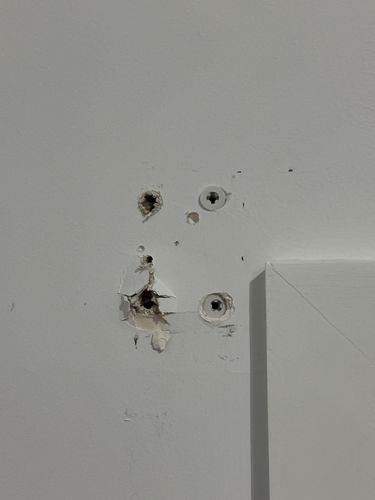

My lil one accidentally pulled out the curtains and in turn ripped the curtain holder on the gyprock wall.
Any advice on fixing this would be appreciated.

The general steps are to cut the damaged section off in a square pattern. Install timber support inside the plasterboard wall using screws. You then put the plaster repair panel onto the damaged section, plaster filler is then applied to hide the join of the patch. Because you have timber behind the wall, you can now screw straight into the wall and onto the timber support. Your curtain post won't need to use plasterboard wall anchors any more.
Please make sure to wear personal protection such as gloves, goggles and a mask when working on your repair project.

I thought I'd also mention that if you have the ability to move the location of the fixings then you could simply fill the damage with Plaster filler. You'll need to unscrew the remaining two plaster fittings and then cut the raised damaged plaster away so it's not proud of the surface. Next, apply the filler into the holes. Once dry, you can sand the area smooth and then add another thin coat of filler over the whole area to blend it in with the surrounding wall.
Thank you Eric for the information. I have managed to remove the screws and apply the plaster filler.
Thank you Mitchell for the information.
It's good to hear that you've managed to repair the damage. My best advice is to use a drill to make pilot holes if you are installing new wall mates into your plasterboard. This will prevent the back of the plasterboard from being damaged.
