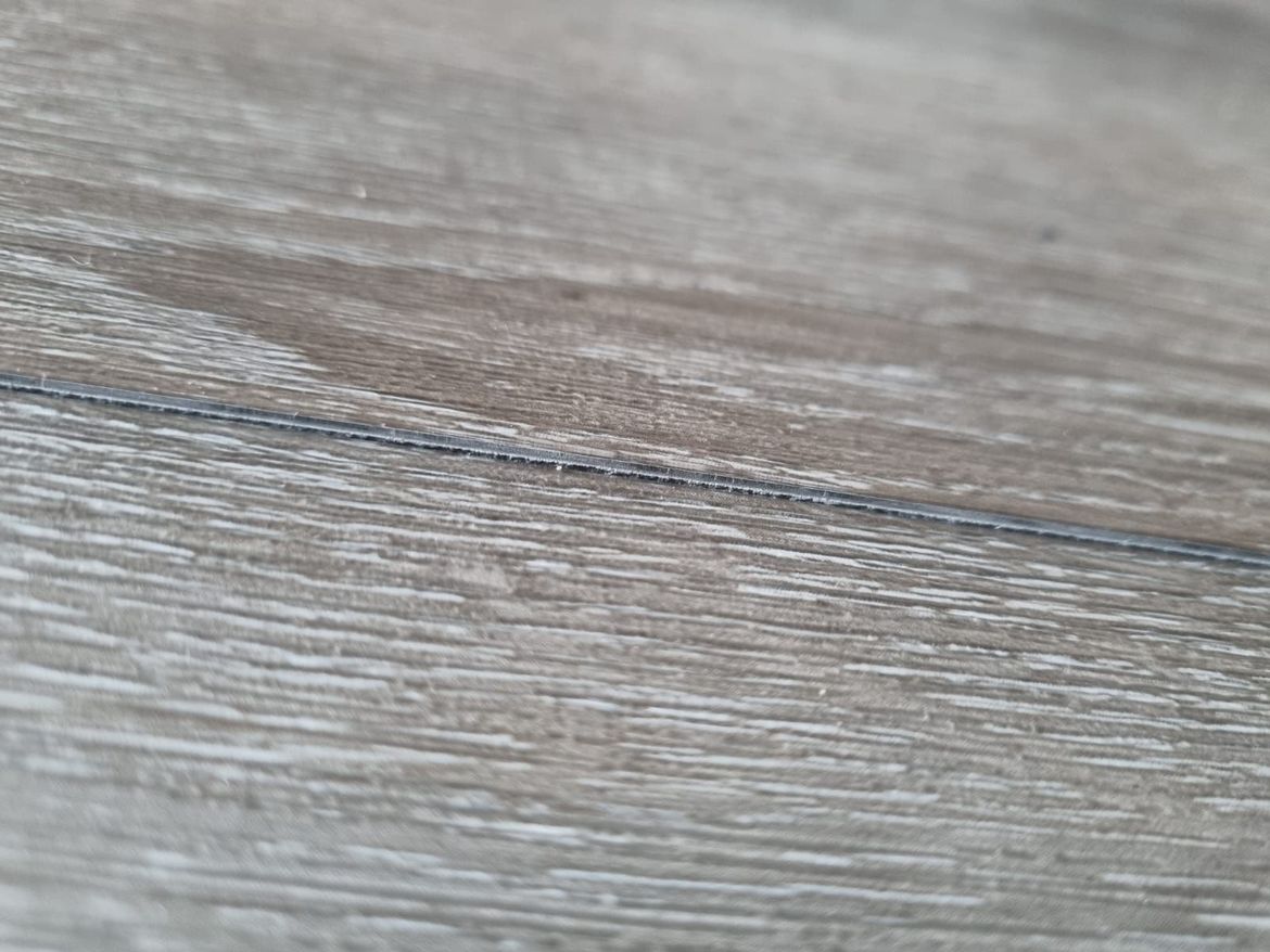

Flooring is 2 years old. Start seeing floor boards are unlocked lengthwise and gap is around 2mm. Please recommend best solution to lock them back?ThanksPratap

Hi @pratapc,
Could you share some images of the gap with us? Let me know if you need a hand uploading them.
If the gap is near the edge of the room, you may be able to use the Capitol Laminate Floor DIY Installation Kit to pull the boards back together. However, if the gap is in the middle of the room, using the tool at the edge is unlikely to close it. In that case, you may need to remove the flooring from one side of the gap to reposition the boards properly.
It’s also worth investigating why the gap has appeared. A gap in the middle often suggests that the boards on one side have gradually shifted toward the wall. Checking the perimeter of your flooring for any expansion issues or loose boards might help prevent further movement.
Let me tag @Nailbag to get his thoughts on this as well.
Hi @MitchellMc,

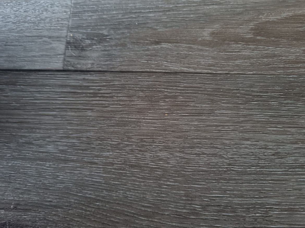

Please see attached images. ThanksPratap
Hi @pratapc
I admit to having old eyes - but to me, it looks more like a height change rather than a lengthwise gap?
If the boards are the laminate covered MDF with the 'click' system - my thought is the MDF has split in this section.
If you stand on that join (first photo) does it go down to meet the height of the adjacent board?
Hi @Noyade
You are right,
Yes - If I stand on the join, its going down to meet the height of the adjacent board.

I agree with @Noyade that this looks to be more of a distortion of the boards than a gap. You'd likely need to replace the affected boards or at least work out what is causing the bulge.
